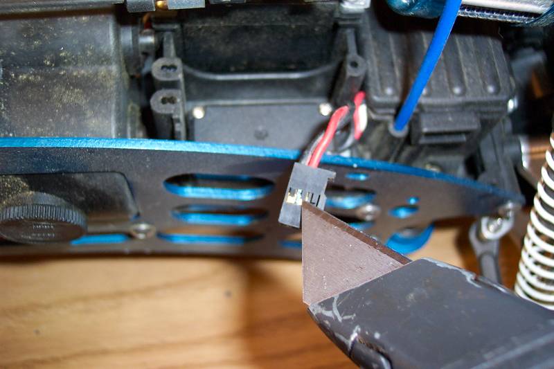

OK, so I purchased a 1600 mah OFNA 5 cell pack for my matrix buggy. Pretty excited Got it home, peeled the body off and uh... The stock battery holder and the new battery pack have totally different connectors. Thus, the battery pack and the connector going to the on/off switch are not compatible. Anyone have any advice here? Are there adaptors or do I need to cut and splice? thnx!

Matty, no dont cut it!!! dont you do it!! look on the back of the plug you will see acouple slots that you can see the brass connectors well on those slots you will a couple plastic tabs, get your self a hobby knife( be very careful not to cut yourself) and slip the tip under the tab and lift while pulling the wires to slide them out. do the same to the other plug and swap the plugs being careful to take note of the orientation and which wire goes in to which slot.
I hope this helps!!

You could also just pick up a new switch from hitec or futaba to name a few. They will fit right in and have a charging jack so you don't have to remove the pack to charge it.

u can pick up an adapter that specifically is for that for cheap on the bay, plus cheapbatterypacks.com (i think....its one of the sites on the ads here) has a section that lets you make adapters.
