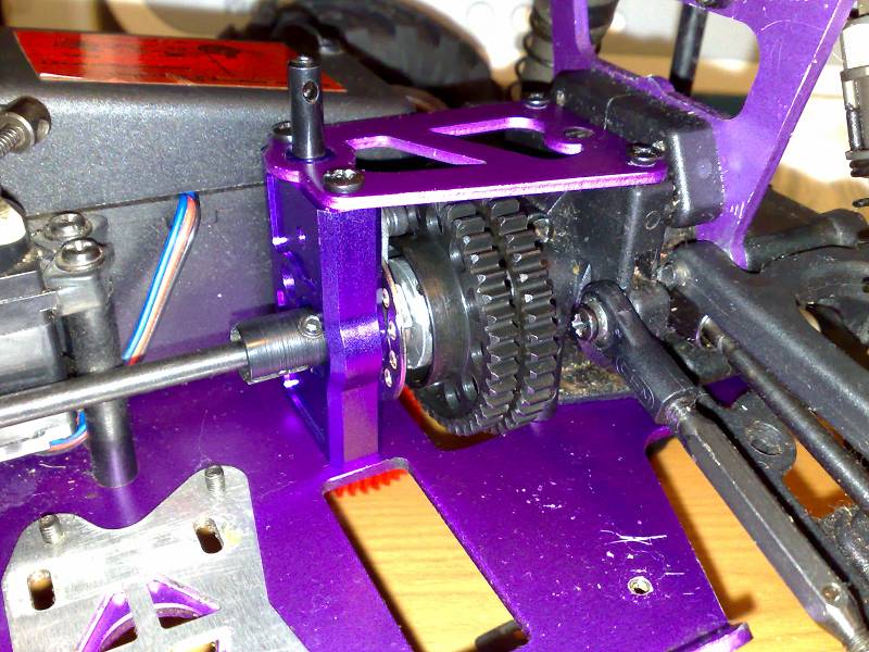

Had the ST2 out this weekend, after approx 25 minutes of run time, the truck came to a halt. Both first and second gear had damage to a quarter of the gear… it had melted. I'm pretty sure the engine wasn't overheating, though I didn't take any readings!!!
I was running the truck on some loose gravel, could a stone of caught up in the gear causing it to snap and melt to the clutch bell? Or have I got it set up wrong - have changed both gears now and runs fine off the floor!
Also, where could I get both gears made from Steel or Ali - from a company that'll ship to the UK as I can't seem to find them?

The stock gears strip EASY. You really need to make sure you have them meshed just right.
CEN makes steel gears, but the problem is the only steel pinions they make are a 14t/17t combo, so your gearing will be taller. And if you use steel spurs with the stock alum pinions... bye bye pinions.

If the gears are colored, they are aluminum. If they are both silver, they are steel. The alum ones get eaten fast.

Both gears are red and have been replaced at least 5 times each, the steel ones from custom rc cars are actually less than half the uk price with delivery if I could get 'em ($60.00 delivered) so I'll be getting two sets.

Just got my geras shipped in from the states, along with the metal break system a n ali steering arm, hop it'll make a differnece to the breakages I suffer...
