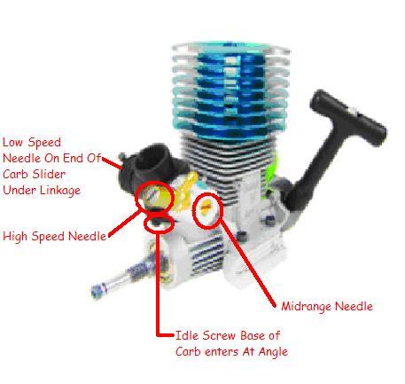

During break-in this evening I noticed how incredible the compression of this engine is. My OFNA Chrome top can't even crank this engine without me having to loosen up the glow plug a bit.
Is this normal? But if I keep the glow plug loose I noticed some fuel coming out of the cooling head hole where the glow plug is, so I tighten it afterwards the engine dies.
My wheels are turning quite a bit even though I'm not applying any pressure to the throttle is this normal? How do I keep this from happening?
I'm currently using the needle settings in the CEN website:
Top end: 3-3.5 turns out
Bottom end: 4.5-5 turns out
Midrange: Flush with silver carb housing.
Thanks in advance

Hey Jay(I just love saying that)
The idle stop screw could be turned in to far and causing your engines rpm's to be abit high, but on some trucks when you have them off the ground the wheels will spin just abit due to the lack of resistance in the drive train. If when you set it on the ground and your truck wants to kreep forward then your idle is too high or your clutch is faulty and engauging too soon. Either way not a big deal it can adjusted or fixed. Let us know how it goes when you do get to play. You should try the compression on the Genesis' or Nemesis' NX76 that engine will actually tear your skin during break in!!!(using a pullstart, since using a mechanical starter before 1 gallon has been run thru it is NOT recommended). Using the pullstarter is preffered during break so you dont bend a con rod or damage something inside, so yeah I guess it would be normal for an OFNA box not being able turn over a new tight engine, without loosening the glow plug..

Is the idle stop screw the same as the Low speed needle?. I am actually surprised that my engine did not stall when I apply throttle and brakes, it just dies when I tighten the glow plug while the engine is running. I can't imagine how powerful this thing is when fully broken in, I mean I'm not even pulling the throtlle anywhere near 25% and it screams[X(] I'm a newbie with Nitro's by the way.
Thank you very much!!!
Hey Jay(just cant help myself) here is an image that might help:
And a link to the [link=http://www.cenracing.com/downloads/enginemanualv2.zip]CEN Nitro tuning guide book[/link]
And a couple videos that should help:
[link=http://www.youtube.com/watch?v=pEGjExP9GkM]Traxxas Nitro Engine Tuning Video[/link]
[link=http://www.youtube.com/watch?v=oSmMzpZM_As&mode=related&search=]HPI Nitro Tuning Video Part1[/link]
[link=http://www.youtube.com/watch?v=BJFsJAxNoRg]HPI Nitro Tuning Video Part2[/link]
You also would benefit from [link=http://www.rchardware.com]The N-Tune Tuning Dial[/link]. Its a huge help tuning and keeping track of your day to day tune as well..
Hope this helps, and feel free to ask Q's

Thanks Real Dogman!!! That's the most detailed info ever.I'll look into the N-Tune Tuning dial hopefully they have some for the NX.26.
