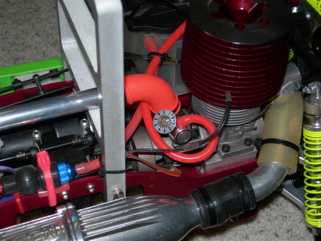

hello i have had the gst 7.7 for a year now haven't ran it through the winter now i want to start it up again and its like much harder to start. i was wondering can i unmount the engine off the gst and mount it on a work bench and start it that way? it might be eaiser for me. has anyone tried to start the engine unmounted on the gst? i think it should work. let me know your opionions

I wouldn't pull it. Check that the fuel lines are not gummed up from old fuel or replace them. Check that the carb works freely, Pull the plug and clean or replace. Put a couple drops of AR oil in the bore and spin it. You should be good to go. I've had no probs with mine sitting .

actually i just got done with it. i charged up my glow plug and battery for the roto starter. i put a new plug in tried using that but no it i took it out and checked it and it didn't even light up. so i used an older one and it started right up. i got through half a tank of gas and then it started to rev up and rev down alot and then rev up and then just shut off. i tried to restart it and it didn't work so i put more fuel into the engine and it ran alittle while then the same thing happend and i coulnd't get it back started. maybe it got to hot. i mounted it on a 2x4 then put it on a work bench it actually worked out. just dont know why it was revving up and then shutting down. thats the problem i had in the summer time it would do that as i was running the truck. i think it is better to work on it this way cause when i would try and let the truck idel it would move foward little bit at a time and when it would rev high the truck would go outta control. so i am more confortible doing it like this. do you know why it would be revving up and down then shutting off?

I think you were getting the half tank lean. Search here for the thread ... ofna check valve ... doing the bench running can open new probs , as we can get lost on where you are exactly at as far as tune, etc. As far as I know ( and I may be wrong ) you need a load on the engine. If you are just sitting there on the bench with the motor free wheeling with the clutch bell, it is not the same as running the trk under load, as to check temps and tune. The only motors I ever ran on the bench were plane motors loaded with a prop !!

Here http://www3.towerhobbies.com/cgi-bin...4&I=LXEYG3&P=K Only needed for the Genesis and Nemesis trucks. To tune it , you need to drive it.

no you shouldn`t need it for your ct5. it`s only for cars with big fuel tanks!(genesis 220cc, ct5 75cc)

hello that pic and link you sent to me shows me a fuel filter/primer. i have a fuel filter going from the tank to the carb. the pic you sent to me shows the fuel filter/primer from fuel tank to fuel exhust. tower hobbies info on the filter says it goes from the tank to the carb like i have it. also what is that number circle thing by the carb?

You are using it as a check valve only to hold pressure to the tank. get the one I show above. Here, read http://www.rcuniverse.com/forum/m_6053163/tm.htm

I just had my truck sitting for months and she started on the first few pulls. I have the check valve installed aready though. Before I put it in I could only run half a tank then my temps would hit 300 and I would shut the truck down, so I'm thinking it might be your LSN/pressure issue. I also use after run oil even if the truck is only sitting over night, always only through the carb with a few pulls to coat the engine after cool down. I don't see a problem with running the motor out of the truck, I also don't think it will help much since your not running under load so tuneing is out. The check valve is worth every penny IMO, thinking off putting one running to the carb also since I'm only useing a screen filter now.

Because you need air flow into the fuel tank to help fuel flow. Low Side Needle, if everything is clean, unbroken and moveing freely your needles might be off.

You, my boy, are suffering from the classic "Half Tank Leaning Issue" known to plague these larger tanks on an open fuel system. Get the OFNA Checkvalve, tune it and forget it!! Believe me, coming from a guy that knows this issue VERY well you will be much better off in the long run!!
