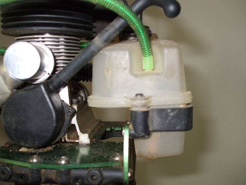

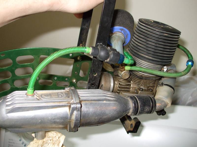

ORIGINAL: delray226
I dont know what kind of one way or check valve i should put in or where to get one, and i imagine its supposed to go between the cell and the engine.
Any hobby store can order/have one already, ofna has a one way check valve, it's what most of us used. NOT between the tank and engine, from the exhaust TO the tank, with the air flow going into the tank. This way the pressure can't excape when you let off the gas, takes away the lean issue. Before I did this I had to run the tank from full to half and refill or retune. The stock tank looks like someone took 2 tanks and made 1. It's fat on top and once it meets the frame it's about half as wide.
Glad to hear everything worked out for you. Hope it's in your hands soon.

yup i got the stock tank.. I will pick up an ofna check valve this weekend when im up near the LHS and install it. Maybe it will help my problem too.. I hope everything works right with CEN i just shipped it today would u guys like me to keep you posted on how it goes?
Burningpoo: thanks so much for the pictures and the explanation of that i really appreciate it
