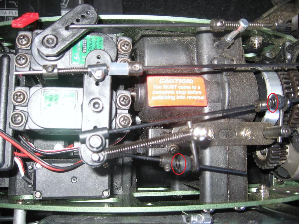

Hi, I just baught my first cen product. it is the gst 7.7. I love it but i am having tough time with the braking system. Is there a way i can adjust the braketension on the truck directly or do i have to use the radio? if i had to use the radio can anyone give step by step instructions? all the answers are appreciated. thanks you guys. I am still new to the nitro worls and ireally want to get into the hobby!!!
Old 04-22-2010 | 10:47 PM
Joined: Apr 2005
Posts: 1,713
From: _, AB, CANADA
Default RE: GST 7.7 Brake question!!!
I am assuming that your brakes are not working, rather than stopping too hard.
The GST brakes are good once they are set up.
there is a shaft coming from the throttle/brake servo that goes through two loops. On that shaft there should be two clamps.
Turn on your radio and receiver so that all the servos go to a neutral position. Then undo the clamps and slide each so that they are snug against the loops (away from the servo) and retighten.
Hope that makes sense.

Old 04-23-2010 | 07:53 AM
Joined: Apr 2010
Posts: 104
From: New Jersey, NJ

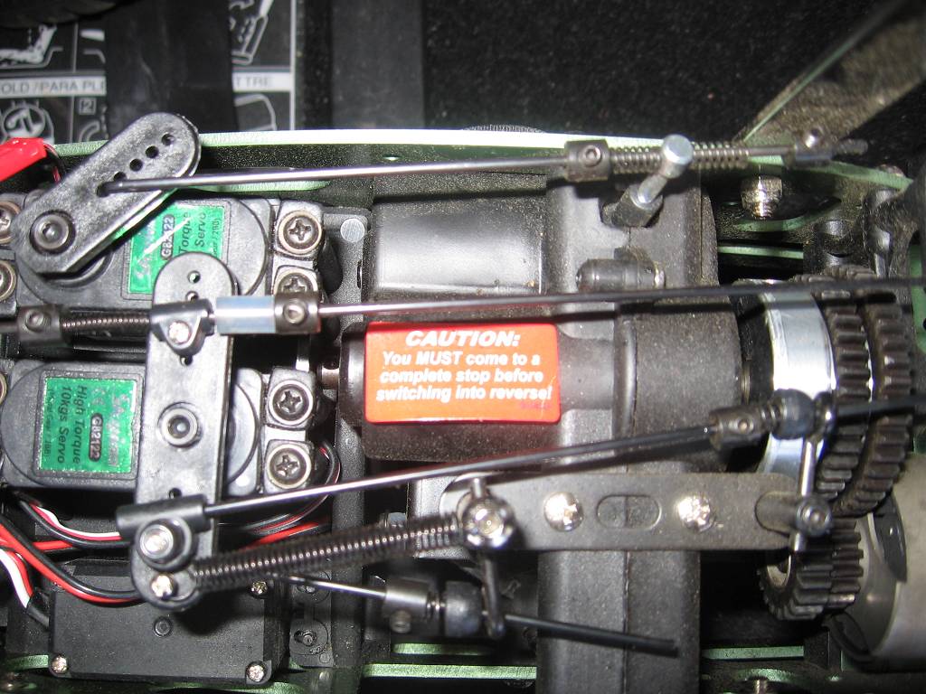

thank you very much for your reply. I will work on it tonight. The rod that is going through the 2 loop looks different from the one i have on the truck. I will take a picutre to show you what i have.

here are the pictures, again thanks for your help

Old 04-23-2010 | 05:55 PM
Joined: Apr 2005
Posts: 1,713
From: _, AB, CANADA
aaah right, they changed it on the GST ( I have a Genesis... older model of GST)
so, same thing applies, just move those collars away from the servo so that they are tighter against the loops.
If you are just bashing and you want SERIOUS brakes, just remove those two little springs. If you just leave the collars and the plastic bits you will be able to do stoppies. The brakes are that good.
