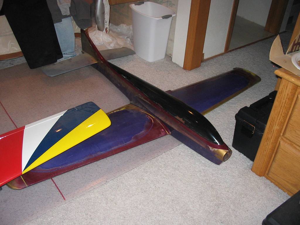

Hello All, I came in possession of a Hippo Tipo today at a garage sale - I couldn't believe my eyes. Now for the request for help. I'm needing some information and drawings to help me get this bird in the air, specifically.
1. Firewall template
2. CG
3. Target flying weight
4. Any templates for the elevator and rudder - it was missing these. Probably not critical.
Thanks all!

Hello Pitstop - Thanks, I'll post some pics - not much to see there, but an ugly half baked job on the Hippo - The wing and stab are sheeted and glassed (the paint job stinks - but I can fix that). The info that I'm needing would come from the documentation for the plane. To add to the list, I'm also needing mounting technique, dimensions, and positions for the wing mounts.

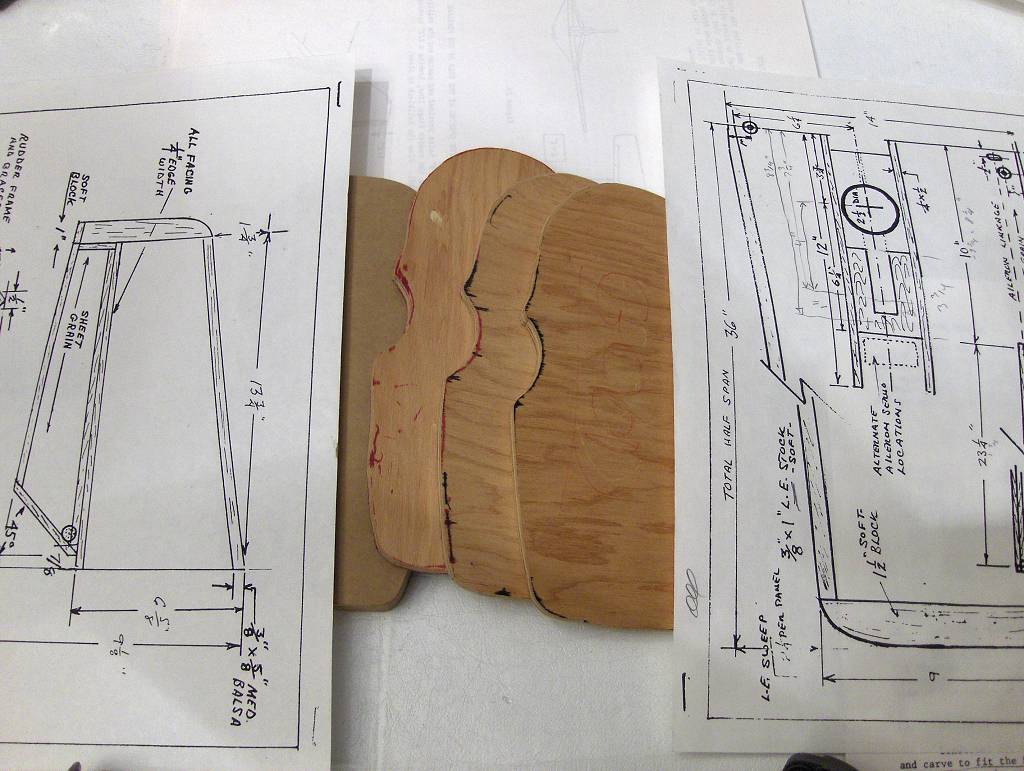

<div style="margin: 0in 0in 0pt">AJ, like these? I was working on thefirewall templates but they arenot proofed yet for fit.</div>

<div style="margin: 0in 0in 0pt">Here is the best I can do right now through the computer for the dimensions of the Rudder and elevator.</div>

Paul, these are perfect for me! Many-many thanks - this is plenty fine to get me going on the tail feathers for sure! On your pics of the firewall - are they 2-piece or is that an optical illusion?

<div style="margin: 0in 0in 0pt">No optical illusion,4 total, but the plane only uses 1.</div>

I figured you were just going to use a contour gauge on the fuse to get the bulkhead, since the location might be in a different position for your intended motor.
I can definitely see that you’re a true builder. I'll send you the last template that I have, but not proofed.

AJ, check that PDF again, just about everything is there that you’ll need.
Very first page, firewall is 4 ¼ from nose.
Actual motor cutout is also there.
Your making me work here now.
