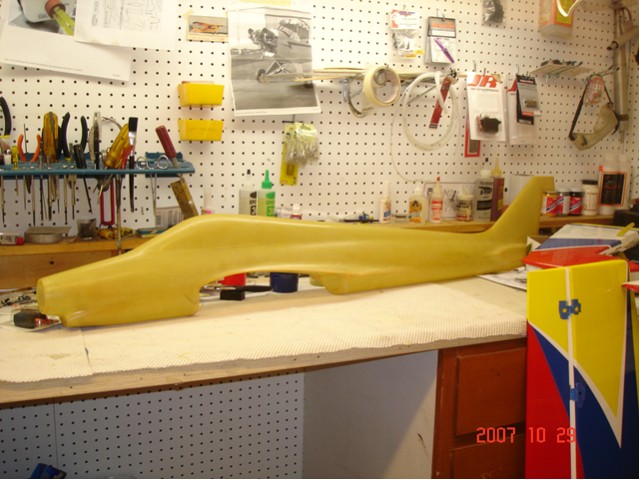

WHAT ??? 200 mph, electric ? Here is one from my hangar, what's the plan ? Why doe's it have to be the 8 ?

Take a look at the P-7, no chin on the nose, unless you need that room.
