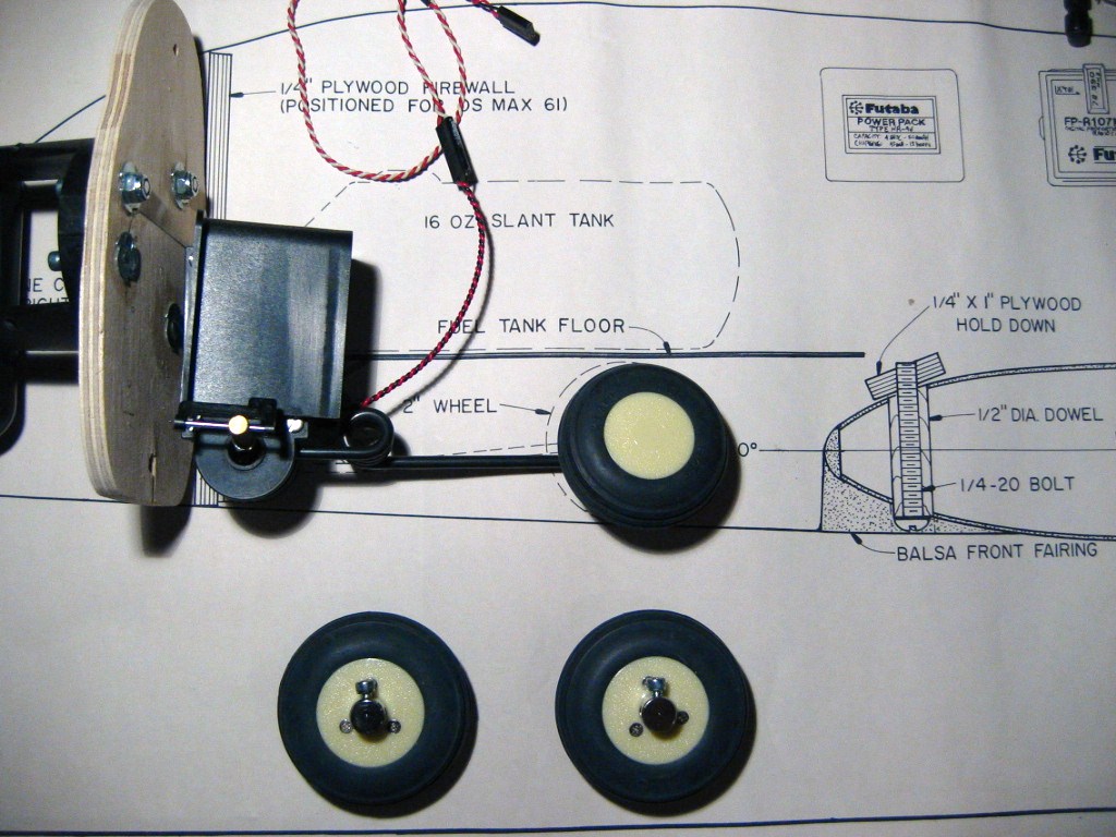

The fuse bottom fairing is the typical piece of wood that is somewhat annoying to produce. Basically it's a matter of pulling the airfoil from the wing and transferring it to the balsa block. The plans help with this. You then gradually carve it out until the fit is good and you are satisfied. The block should be oversized so that once you have carved and sanded the airfoil shape, you can then fair the top part into the fuse bottom and sides again by carving and sanding. Note that the forward wing bolt goes through this block reason for which there is one instead of two bolts - easier. When you install the front 1/2" dowel to support the bolt in the wing, make sure it is long enough so that it protrudes from the bottom of the wing about 3/8". The idea is to have a flat base that you can tighten the bolt against and hide it by the balsa block which will be bored out to accommodate the dowel extension from the bottom of the fuse. The rear bolts are different and just tighten against the typical 1/16" ply plate. The front bolt is vertical while the rear bolts are angled to conform with the airfoil of the wing bottom. Getting the wing retention plate for the front bolt in the right place in the fuse is a little tricky but again the plans help there. Once the fairing is done, you'll want to fair it in further with epoxy and microballoons to make some fillets along the sides and perhaps a but from the end of the block into the wing. Use little epoxy so it sands easily.
Before you build or install the block in its final form, align and mount your wing and stab - the two crucial parts of the build. This way you don't end up with a block which is a little offset after wing attachment. I plan on painting the wing center section as I don't like the way covering goes over those compound curves. It also avoids the bolts from wrinkling the covering when tightened and makes for a durable center section and good fuse paint to wing transition. Of course, this only applies if you are planning on covering the wing and stab (a tad lighter).
Regarding the pipe, I've seen Tipo's with inverted RE engine installs but they were later gen Tipo 825 models - larger. Personally, I don't think an inverted engine installation on a T720 would work that well as it would result in a large gash in the bottom of the nose which is a bit of a signature of the Tipo design in my view. This would be lost if the engine were installed inverted. Also, routing the pipe inside a fuse which doesn't have a removable pipe deck sounds like a headache in maintenance to me not to mention heat issues as well as space issues if you plan to use retracts (a must [8D]) - especially pneumatics. Finally, the header might give you some further headaches when it comes to get the nose gear installed and operating and the fuel tank would probably have to be moved back further compounding the issues. On a non-pumped engine (like the VF) I'd keep the tank up front where planned for in the design. In short, on a T720, I'd stick with the standard external pipe setup and run it along the fuse side with the VF. If you have a SE engine, then you could use the more standard under the wing configuration to keep the fuse lines clean.

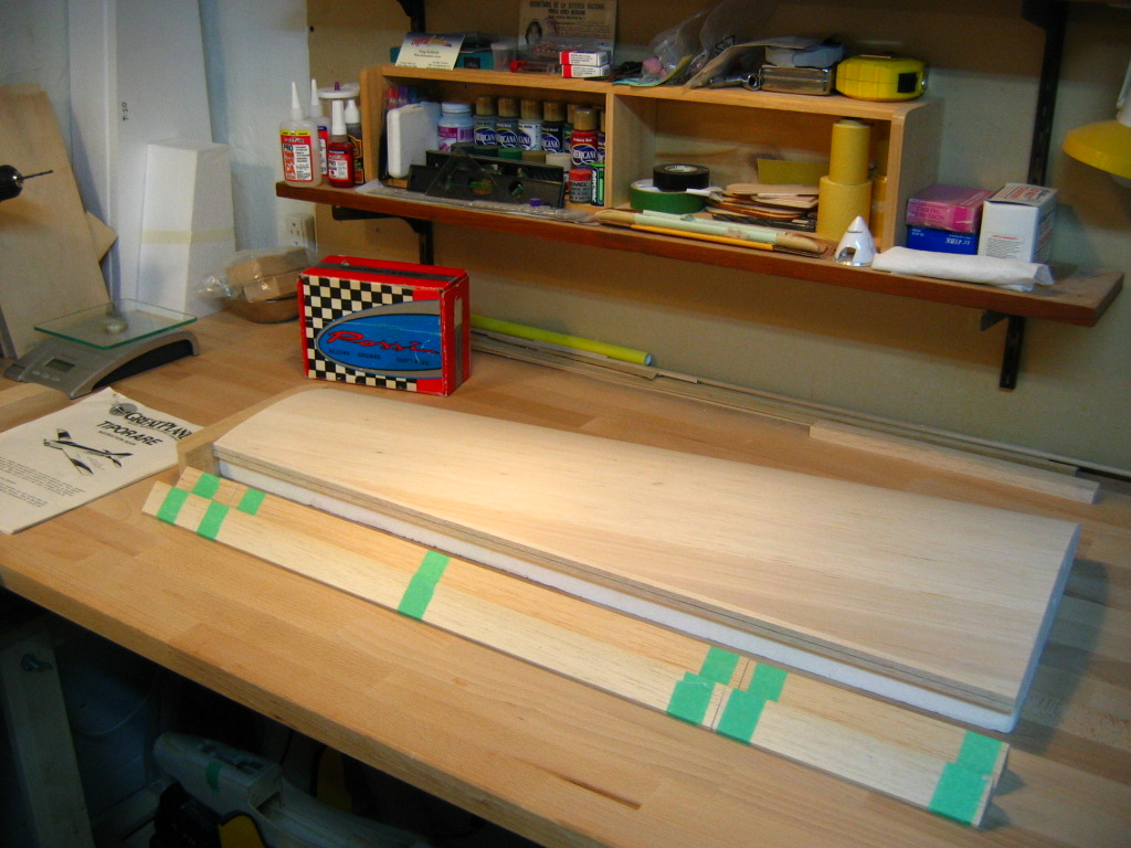

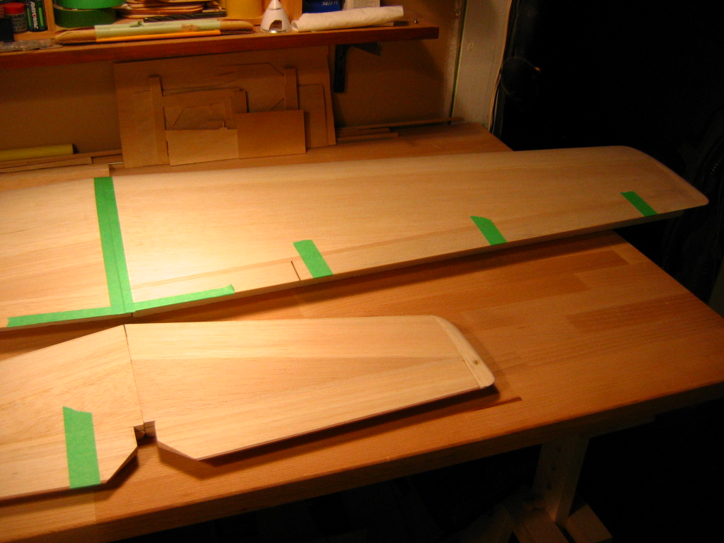

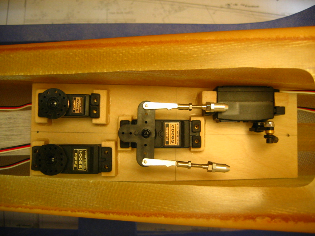

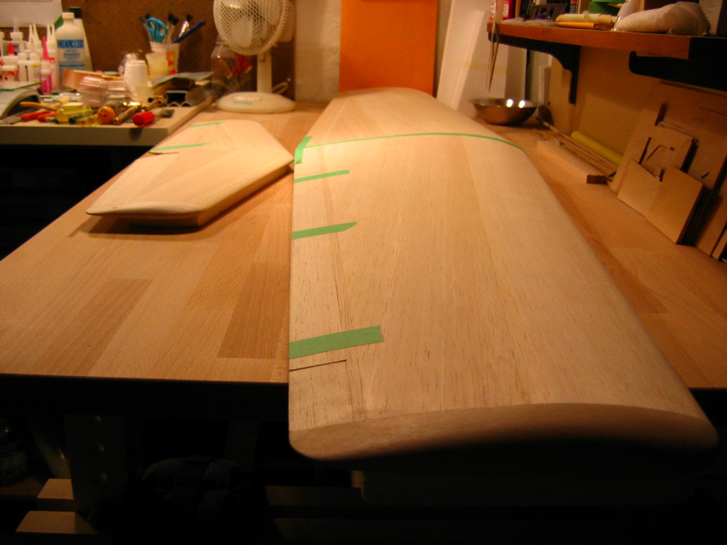

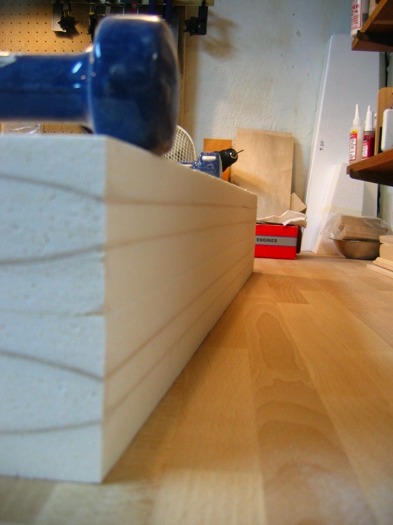

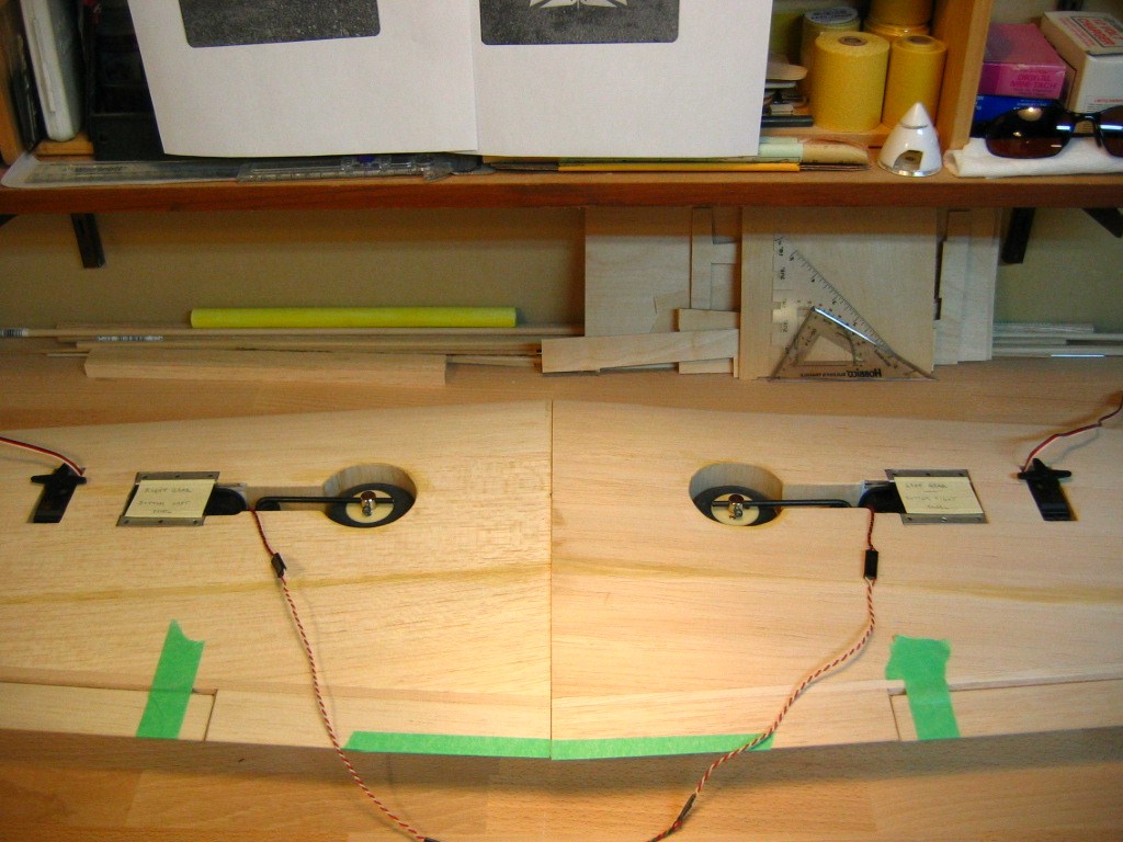

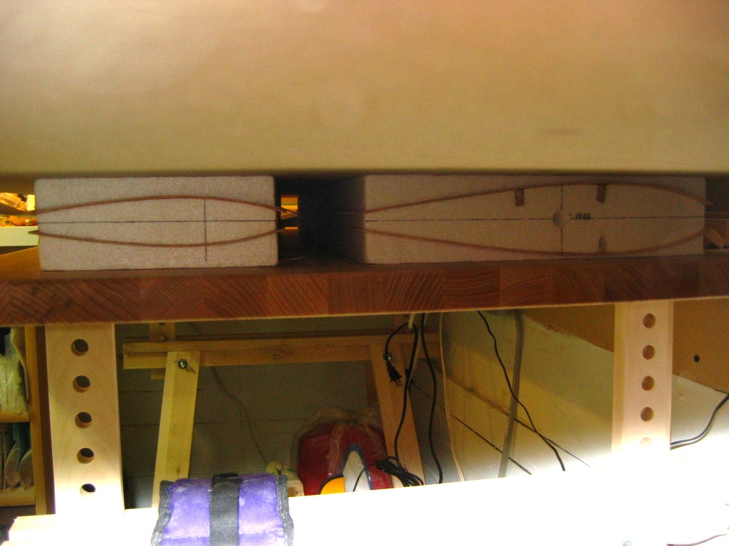

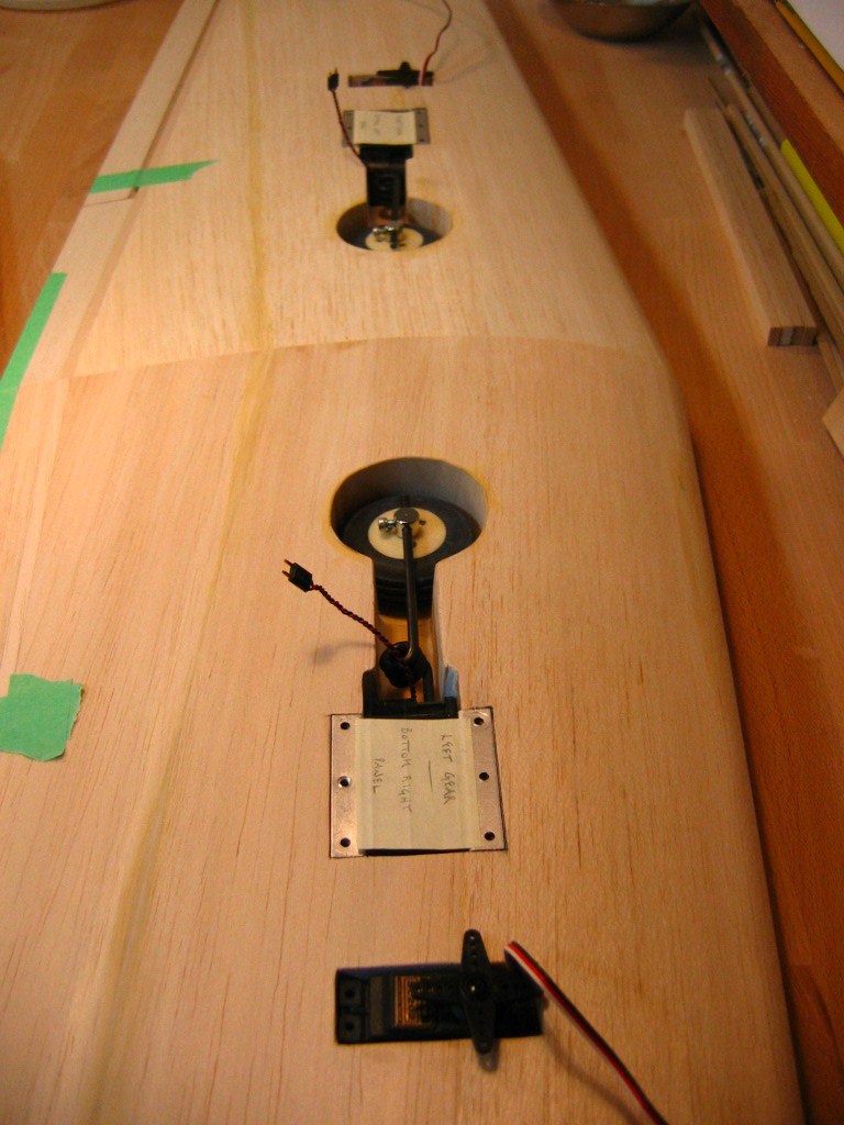

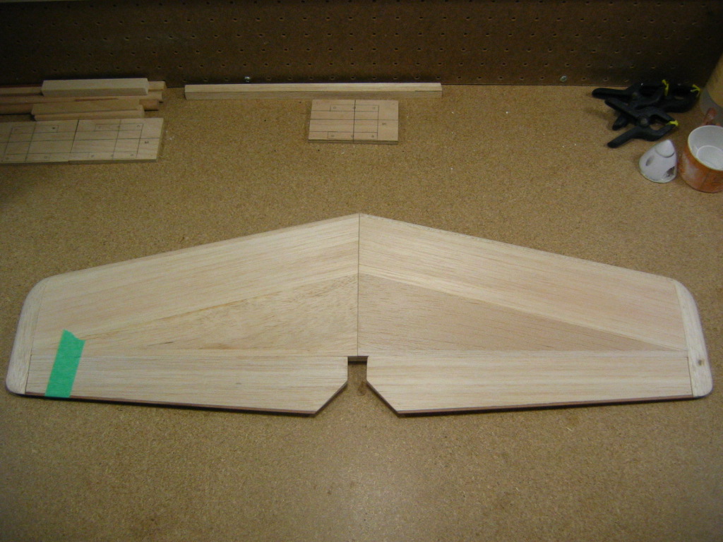

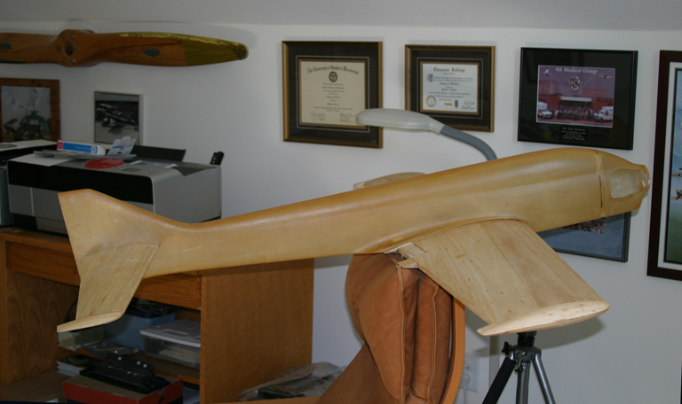

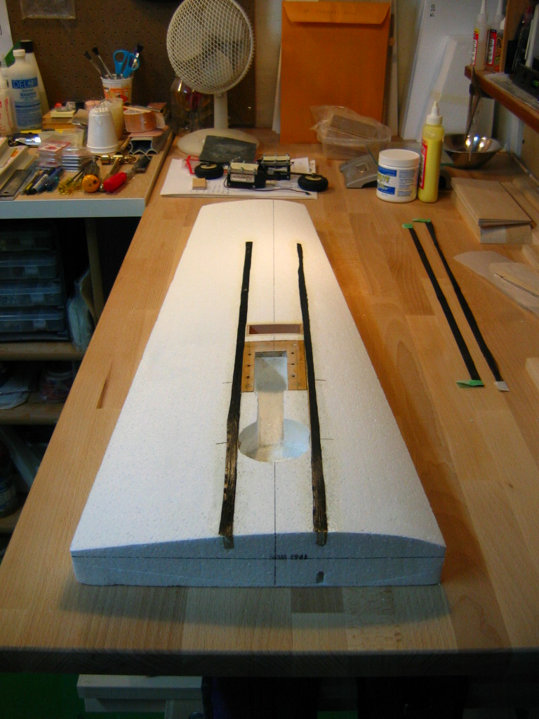

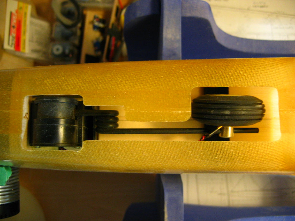

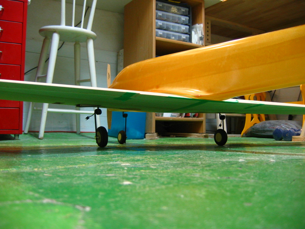

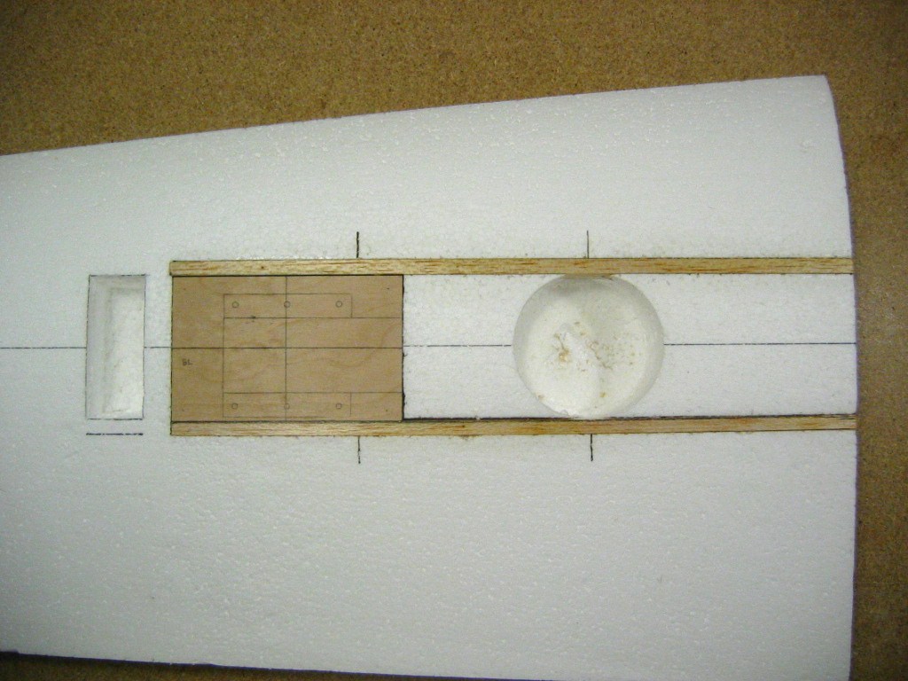

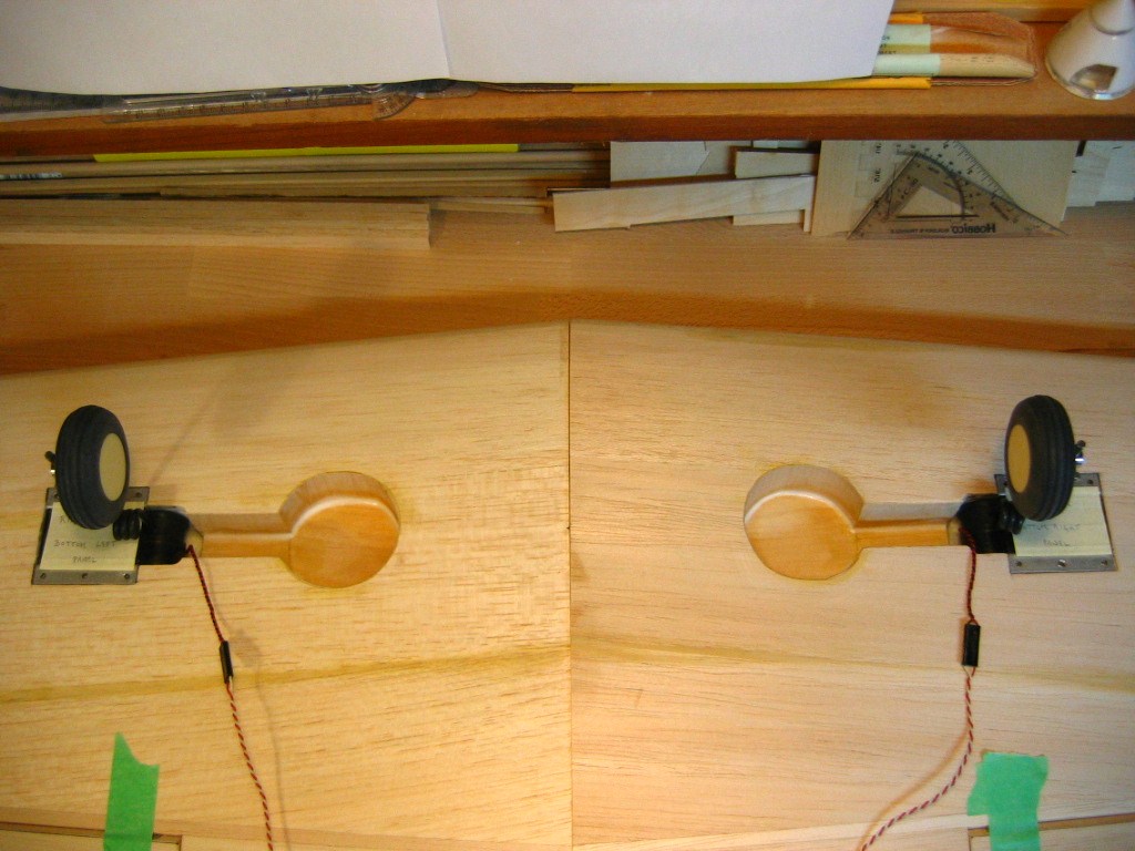

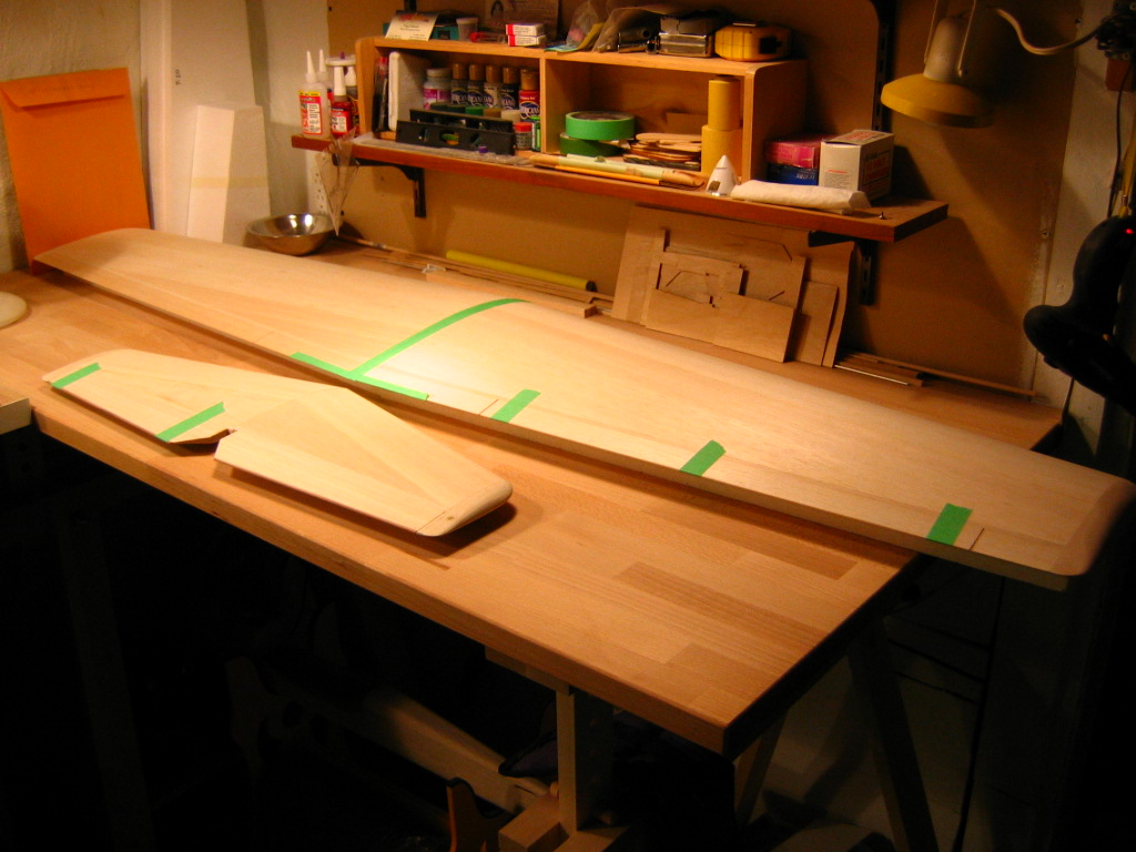

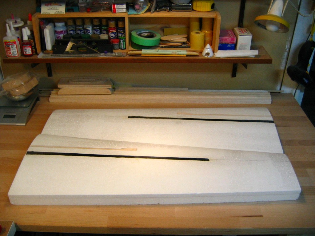

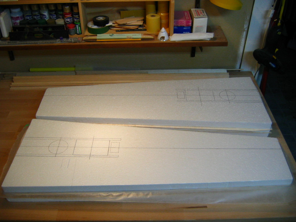

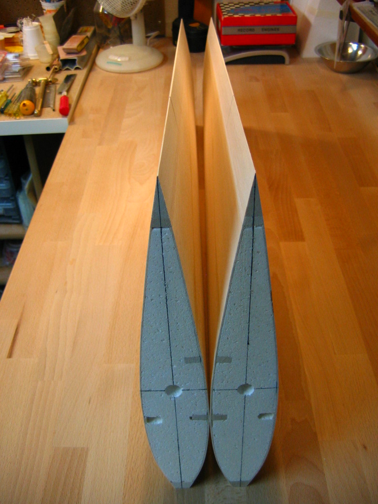

Here are some snaps I've taken of my on & off build over time.
I look forward to your build thread as it will hopefully motivate me to get mine finished!

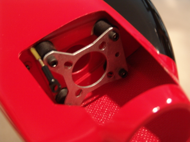

Last two snaps are soft engine mount option as used by Mike in his T720 with an pumped OS SF. Mount is Sullivan.
David.
David.

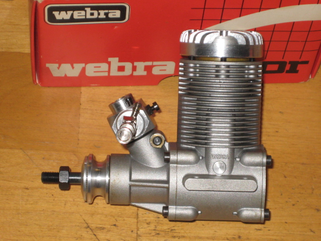

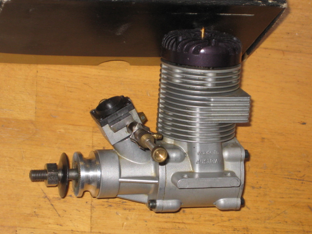

now that the Webra site is gone ([
]) its hard to trace back this info but if memory serves me, both engines had the same max power output but different torque curves (evidently). I now have a RE Webra Champion as well as SE Webra Speed (like yours) so one day it might be feasible to test them both out on the same dynamix. Dave Wood made some tests on a BH RE Champion I believe but it was a little different than mine - can't recall exactly how. Quite a beast according to the Macs site!
I'll see if I can find the link. Got it!
http://www.rcuniverse.com/forum/fb.asp?m=8797318

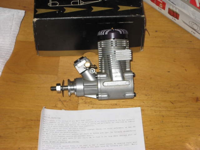

Actually my Champion is a 1030 too - wohoo! Recently got a Speed 80 as well - will be interesting to compare the three although I don't plan to put an 11x8 on the 80... [:-]
Also need to run this heli Speed 28. Ralph says it was a great engine. Recently became a big fan of Webra's now that they are extinct. [8D]
Joshua, apologies for the detour... it's all related to Tipo's though!
David.
]) its hard to trace back this info but if memory serves me, both engines had the same max power output but different torque curves (evidently). I now have a RE Webra Champion as well as SE Webra Speed (like yours) so one day it might be feasible to test them both out on the same dynamix. Dave Wood made some tests on a BH RE Champion I believe but it was a little different than mine - can't recall exactly how. Quite a beast according to the Macs site!I'll see if I can find the link. Got it!
David.

I have a Speed .61 which is what I used in my first Deception. This NIB Champion .61 is what I have in mind for my Tiporare because I assumed it would be a bit stronger. Due to some opinions I've seen expressed on RCU, I plan to replace the Webra "Dynamix" carb with a Perry pressure carb.
Greg
Greg

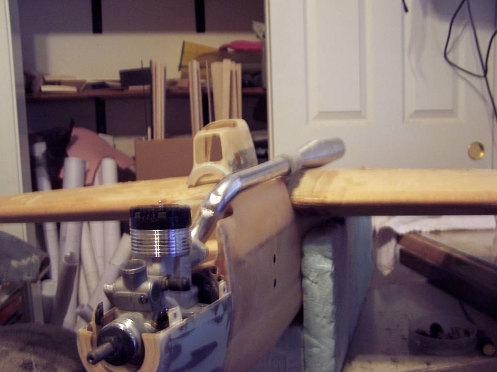

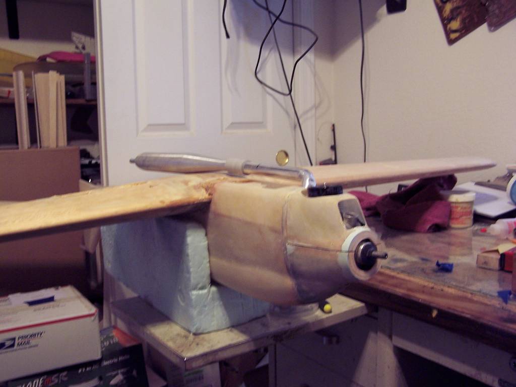

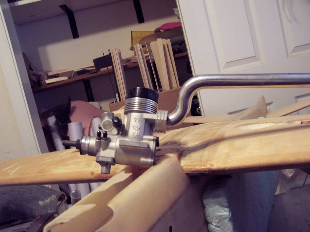

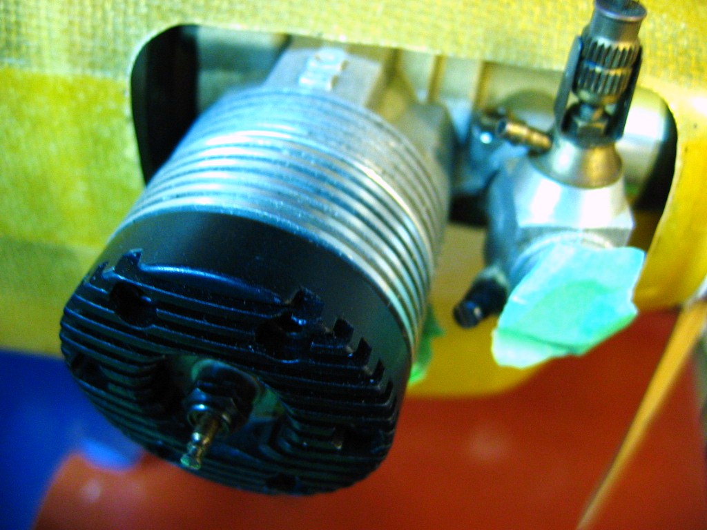

rear exhaust inverted works ut decently.
as soon as the weather warms up a little bit i will be painting mine
it is a wk model someone cut the nose off at the firewall befor i got it. (luckily they quit working on it at that point who knows what might have come next.)
so i reatached the top of the nose and made a cowl out of the lower half. the pipe and headeris a macs products one. i unfortunately added the dents when i tried to slightly rebend it.
the engine is a brand new ,old ys short stroke 60. BDretracts are going to be used.
Dave.

Dave,
nice inverted installation. I actually didn't think the cylinder would fit without being exposed at the sides. Works well with a pumped YS.
I think Joshua was considering (or maybe I had hinted at it) an inverted installation with an enclosed pipe and an S shaped header bringing the exhaust up to the top of the fuse. This is what I was recommending against in a T720 but all kinds of Tipo's have been built.
With an inverted installation and the pipe under the wing, it works out more or less like a side mounted install does.
David.

Yeah simmilar to the side mount iswhat i was hoping to end up with.
since the stab was allready mounted changing the anhedral wasn't really an option.
a gear up landing might be a bad idea on pavement though.
that pipe was pricey!
if you didn't want to make the cowl a seperate piece it would entail a very large hole in the bottom uf the fuselage.
potential paint scheme
Dave.

I don't think I ever saw an inverted rear exhaust arrangement for the Tipo before; they were always side ex. with the jug sticking out sideways with the pipe running under the fuse or the rear ex. with the pipe running down the length of the fuse. If I ever get to mine it will be setup the latter, Y.S., with the tank mid fuse, I think. I confess, I want the Phoenix 7 from Hangar 9 after one of the guys showed up at the field with one, they're nice.
Dumb question but why not mount the engine upright and set it up like the XLT was???
In the past years I have had Dirty Birdy 40, Mach One, Bob Smith T2-40.. I always loved the Tipo's as well as the Curare and EU1-A..
Rick
Rick
Thrust line is reversed in the Tipo. The engine would poke out like a sore thumb and the pipe would be all nasty and exposed. XLT, Escape, Deception and so forth have a lower thrust line and tuck the header into the fuse as it exits into the canopy. It just doesn't look right on the Tipo. The side mounted engine is IMO the most graceful arrangment.

I appreciate the view on the DEPS, I will see when I get to that point and I may just engineer something myself. I like the idea of an arrow shaft, and it is classic. Would I be correct in my thinking that a side mounted elevator servo would eliminate the differential??
Here's one to all of you who may be looking to thin out your engine collection. As I said I have an OS RE engine, and I am considering using it in the Tipo. Well, that was before I came across Carolina Custom Aircraft selling the T2A MkII which really needs an RE. My point is, if anyone as a Webra or a YS 2 stroke that they don't mind getting rid of and one which will go to someone who truly appreciates it let me know.
Josh
Josh
ORIGINAL: JoshuaDA10
The photo below should answer your question - in short, yes. I posted some pics higher up with some details of gear installation. By the way, the servo required to install in a side mounted fashion has to be of the low profile type in order for it to fit. I'm using a 1" Futaba. They're not cheap but then again, elevator is not something you want to do without...
