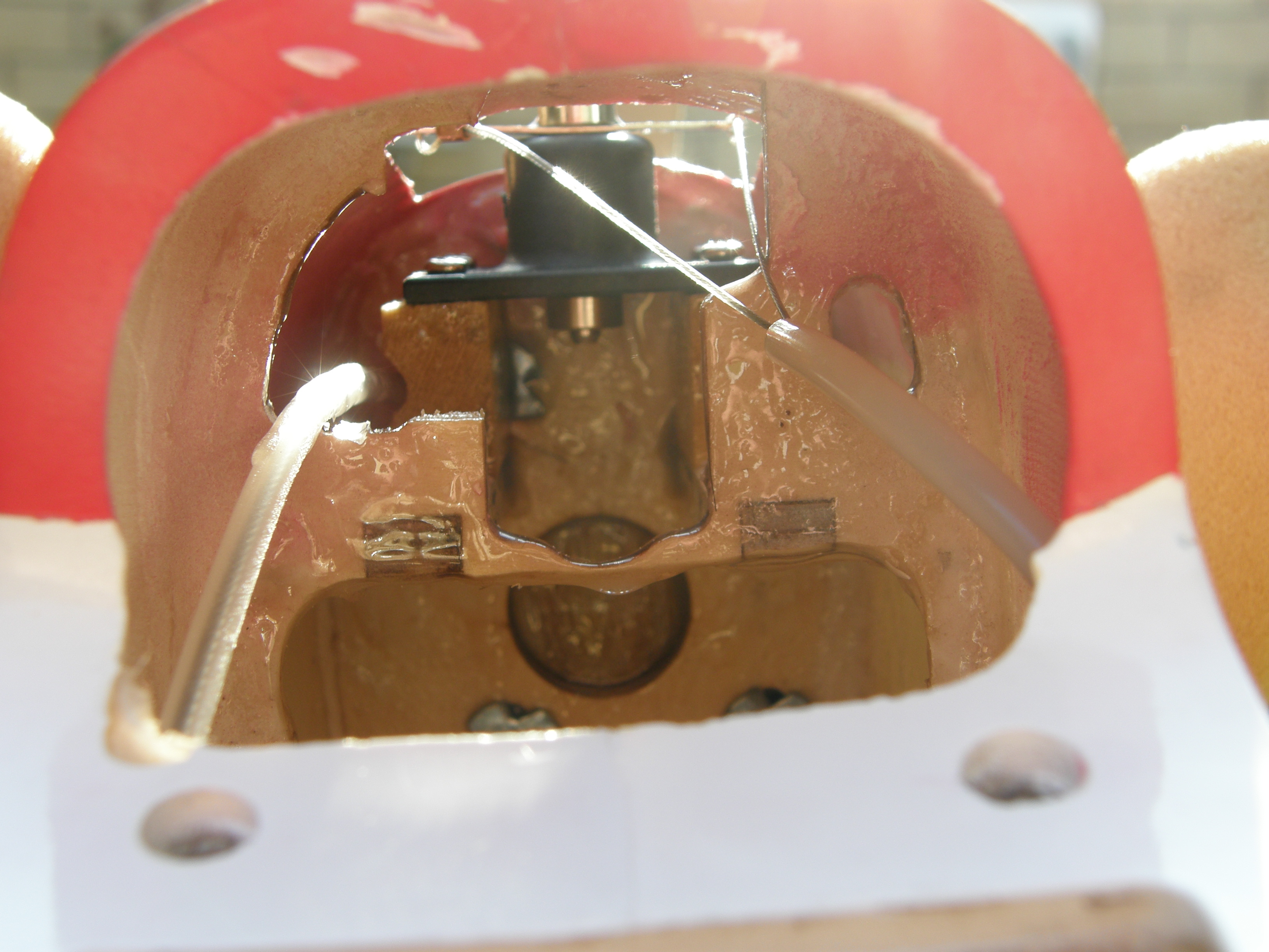

Since it may be a while before I see my new Spring-Airs, I am going to set up the fixed gear for now. I will retrofit the retracts later.
Steering-
Due to the tank now sitting right in front of the forward wing mount, I can't run the steering cables straight down the middle per the instructions. So I took a nylon tube (like a nyrod tube) and formed it by heating it with a heat gun, bending the tube, and letting it cool into it's new shape. After some trial and error, I was able to shape the tube to route around the side of the tank. then snake over and exit pointing toward the nose gear. This was glasses to the side of the fuselage using some 4 oz glass and epoxy. The steering cables are hooked up and I have nose steering.
This steering set up should work for the retract nosewheel as well.
Don't forget to drill a drain hole under the nose just forward of the firewall. Seal the edges with epoxy.

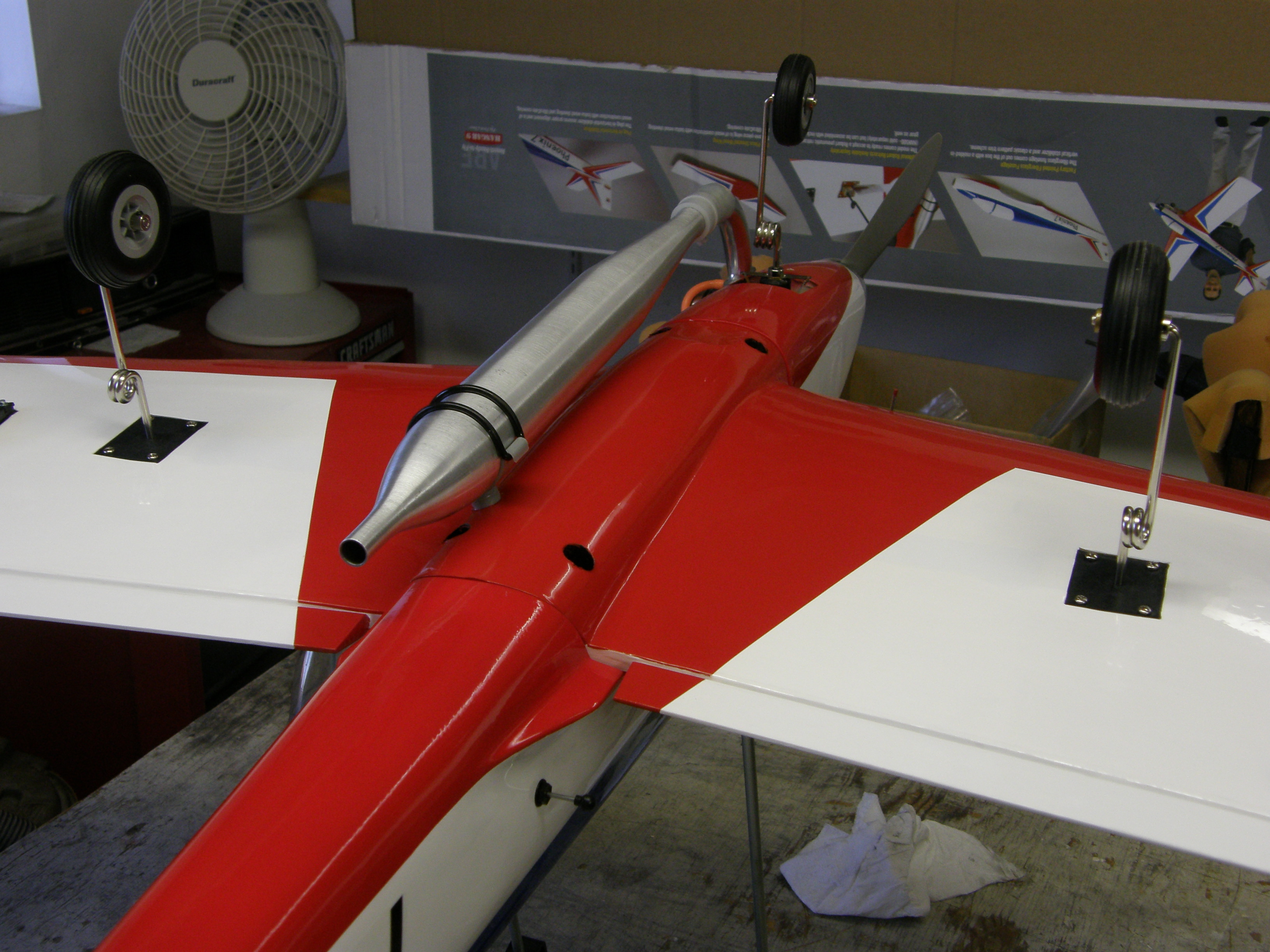

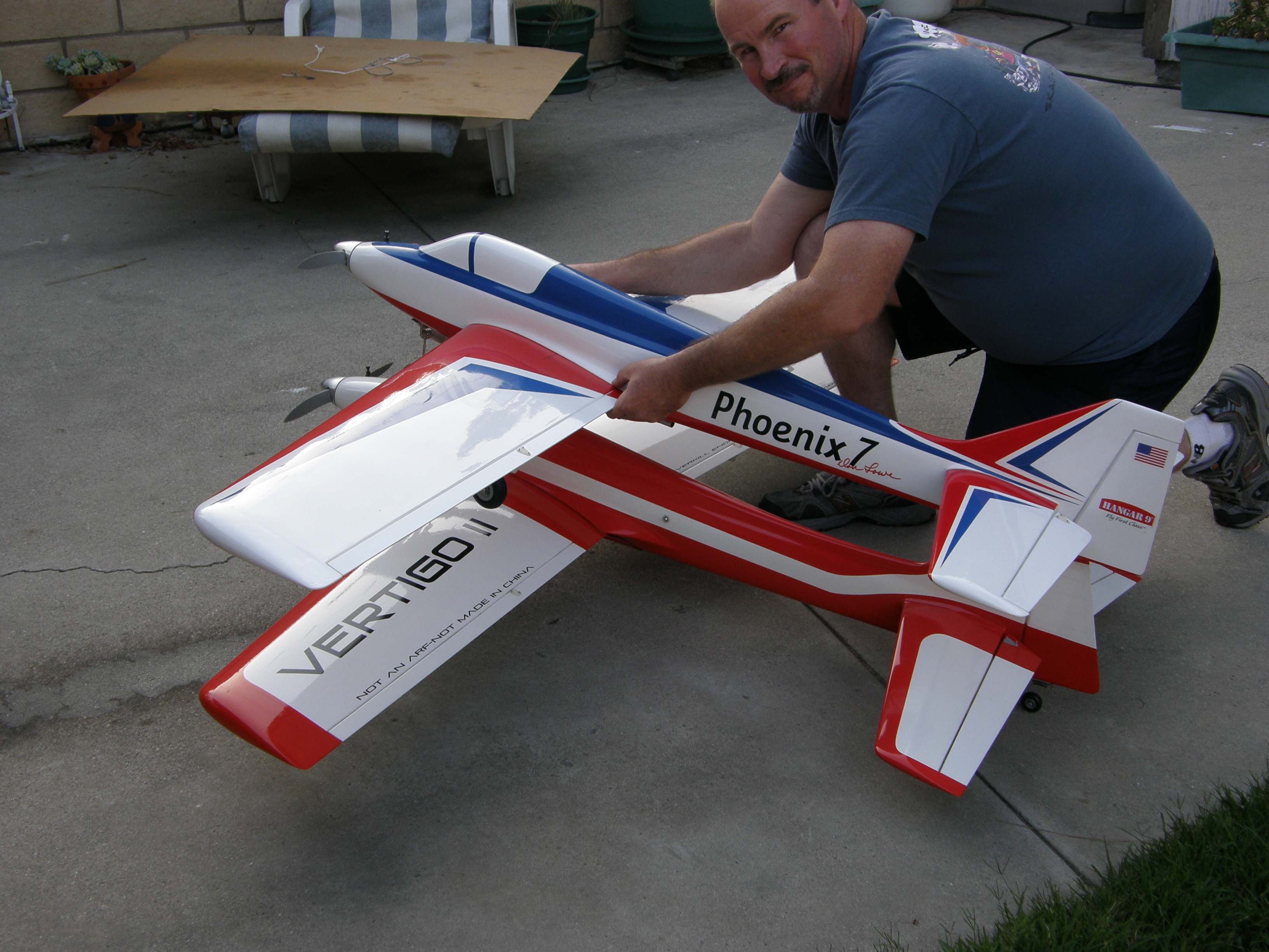

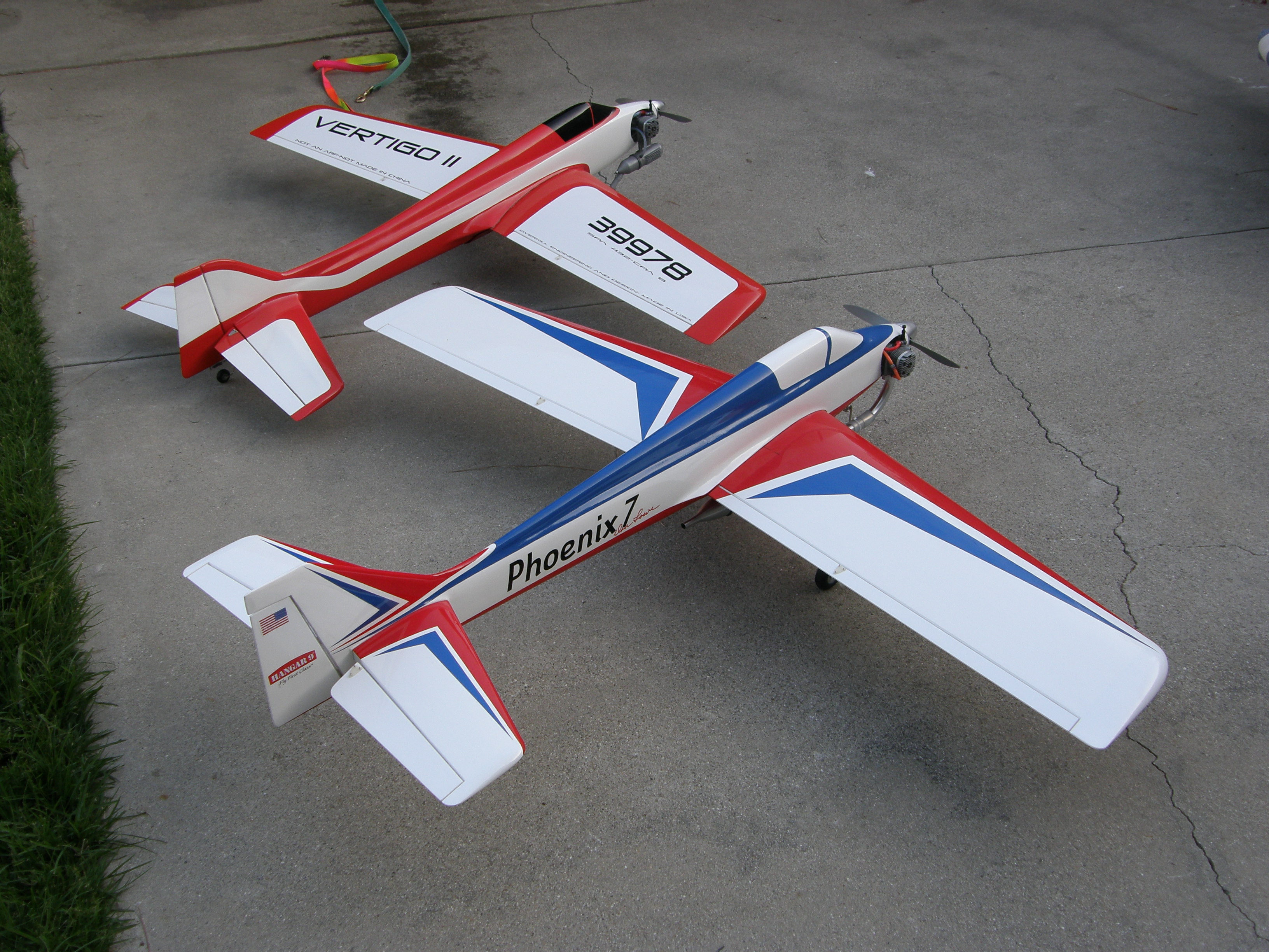

The Phoenix is finished. I don't have a weight yet. It is lighter than my Vertigo (8lb 4oz), I estimate sub 8 lbs. It took 2 oz in the tail to balance to the book C.G. specification.
There was nothing remarkable about the balance of the assembly. The fixed gear was installed (still waiting for the Spring-Airs) per the book. One of the main gear mounts was not drilled all of the way through, or tapped, so I simply drilled and tapped it for a 6-32 set screw.I found the book specification for the aileron throw to be excessive by my estimation, so I set the high rate to the low rate spec. We will see how that pans out tomorrow.
I used a Du-Bro switch mount for the switch, and will install an Ernst mount for the charge jack later on. All of the control linkages are what was supplied by H-9.
The Dave Brown Pipe mount was installed at the location specified in the instruction book. I used an extra long header VS the recommended long header. This worked out great, as I am running a 10cc Quiet pipe instead of the 8.5cc pipe recommended by H-9. The 10cc pipe is longer than the 8.5, and the extra length compensates for the extra long header.
My overall impression regarding the assembly of the H-9 Phoenix 7 ARF is that H-9 deserves a great round of applause for not only rolling the dice that something like this would sell well enough to warrant the investment to produce, but that they did a very good job at engineering and execution of a classic design, for a very reasonable price. I hope that they consider doing more resurrections of other classic designs.
Then there is the family picture. The P-7 is pictured with it's cousin the Vertigo II. The Vertigo II is a spin-off of the Phoenix 6/7.

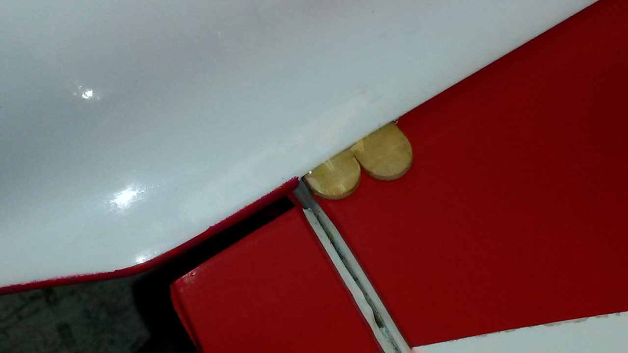

Hey P-7 jockeys!
Does your P-7 carry some up elevator trim? Mine sure did. And so did every other P-7 that I have seen up close. Hmmm, there must be something to this.
So a couple of weeks ago, I loosened up the rear wing screws, inserted a couple of wooden "Popsicle" sticks between the wing TE and the saddle, then tightened up the screws. Totally unscientific, just kind of winging it so to speak.
I set the elevators to a neutral position using the trim, and took off. All I can say is WOW. Night and day difference. I asked Tony F to fly it, and he also concurred that it was a major improvement. After flying Tony's now deceased Phoenix, and noting how much betterthat his flew compared to mine, he graciously worked with me to dial it in. And while we got it close, there was that elusive "something" that was still not right. It looks like we found it.
When I returned home, I aligned the ailerons and elevators using to the airfoil using my calibrated MK 2 eyeballs, and took measurements with the Robart incidence meter. (Note- never trust the tips! Especially on an ARF). The resulting measurements showed that with the shims, that aircraft now has a +.25 degree wing incidence (or decalage) relative to the stabilizer. This is right about where it should be. Without the shims, the incidence was -.1 degrees.
Any negative incidence will cause weird trim issues. No amount of negative incidence is good- ever. You need a little bit of positive incidence, or the airplane will tend to "hunt" in pitch. The Zero-Zero setup is a myth. Joe Bridi got it right. Look at the plans for the Dirty Birdy, etc, there it is- positive incidence. The classics need some positive pitch stability to really fly right.
So take a look at your P-7. If it is carrying some up trim, give the shims a try. BTW, the shims that I used (and have since made permanent) are .080" thick.
Hope this all helps someone.
-Robert

Originally Posted by Winged Fox
I noticed mine was hunting in pitch or at least always out of trim. I will try this on mine. (.080 thk) Cool! Thanks Robert.
Yes, this mod rid my airplane of that pitch trim change that we have been chasing. It should do the same for yours.
Mine would also pitch to the canopy on uplines. Adding the downthrust that Tony recommended cured the majority of that tendency.
Shimming the wing effectively added more down thrust, and the pitch to the canopy is now completely gone. Check your upline tracking next time out. It will be important as you learn the advanced maneuvers.
-Robert

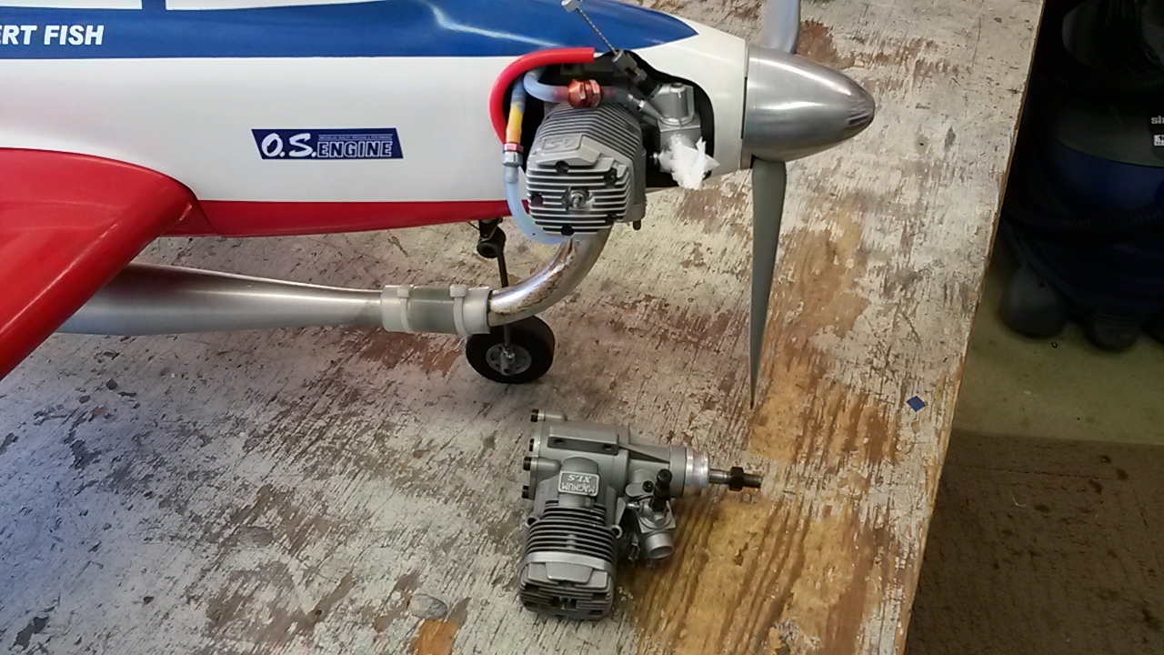

With 22 hours of accumulated flight time, the old bird needed something to freshen her up. So I bought a new OS .65 AX for the P-7. I put the piston and liner from the crashed Vertigo II (6 hours time) into the new block and - Presto! Instant hot engine transplant. No break in required! The outgoing engine, a Magnum .61 XLS is still pulling strong, and will find it's way into the new Super Kaos 60 that I recently acquired. The .65 is happily turning an 11 x 8 APC at 14,160 RPM burning Cool Power 15 %. I was all set to fly her this morning, but I was blown out. Doggone Santa Ana winds! OK, next weekend we will give it a go.
-Robert

Update- The OS .65 AX did not disappoint. The 11/8 just wasn't enough load for the engine, so I changed it out for an 11 x 9 APC. 13,800 RPM with 15% Cool Power. This thing is strong. I have thrust to weight better than 1:1. This engine is an excellent bang for the buck.
I had to remove the 1 oz of tail weight and move the battery from under (over?) the servos to over the fuel tank to bring the CG back in line. So that is about a 3 oz weight savings. More power plus less weight. Money well spent.
-Robert
