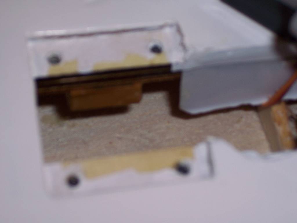

Hey FB,
I hope these help a little. You can see some bracing behind the 1/64 ply cap. The original hole for the Robart LG loop was filled and cut to fit the E-Flight loop. The ply blocks go back into the wing to tie thing together.
I miss my old 35mm camera for close up photos.

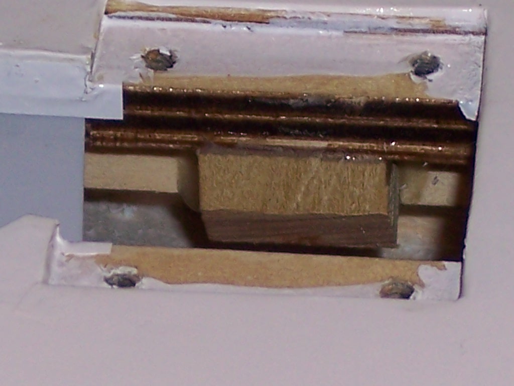

Here are some better shots of my LG mounts.
Crankpin gave me some good ideas on how to shoot close-ups. THANKS CRANK

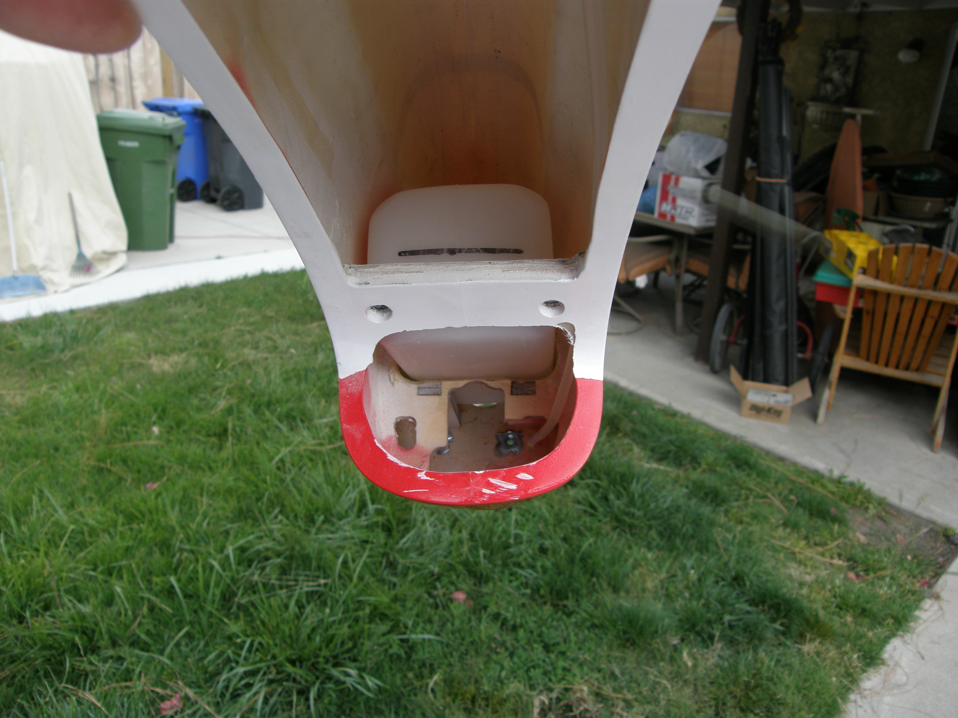

here are some pics of the mods i made to make dubro tank sit level, along with the surgical carbide burr i use to reach the areas modded

I would be a little concerned about how much wood you removed from the aft bulkhead that hold the mounting rails for the nose gear. Any shock on the nose wheel might make it break out.

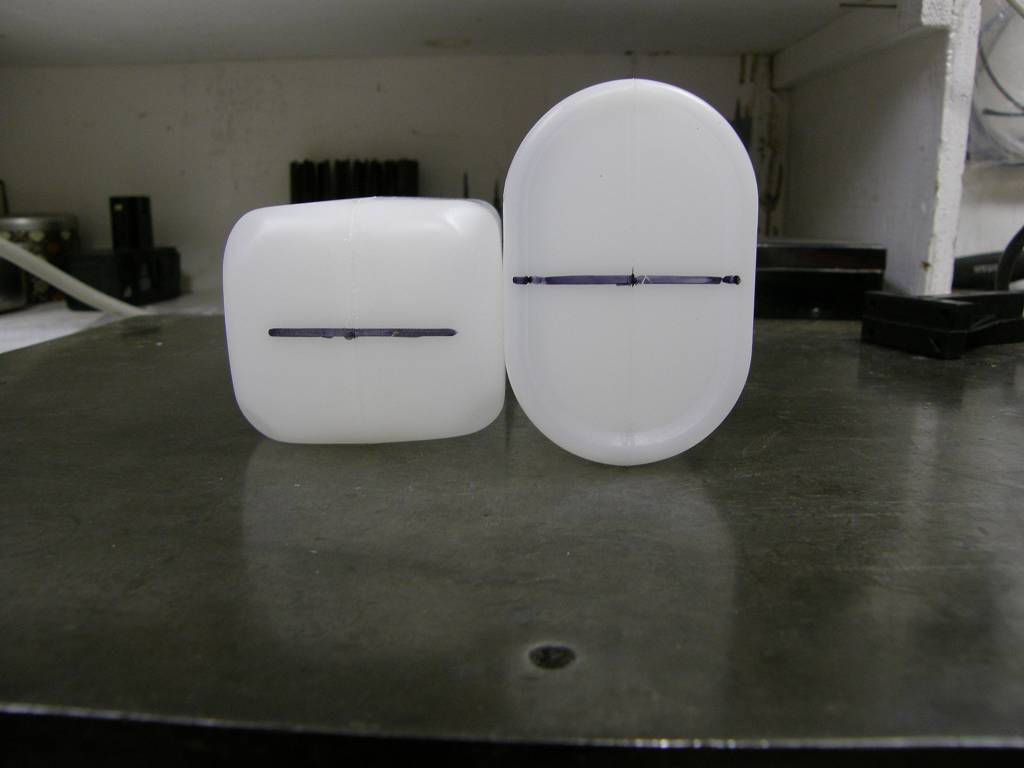

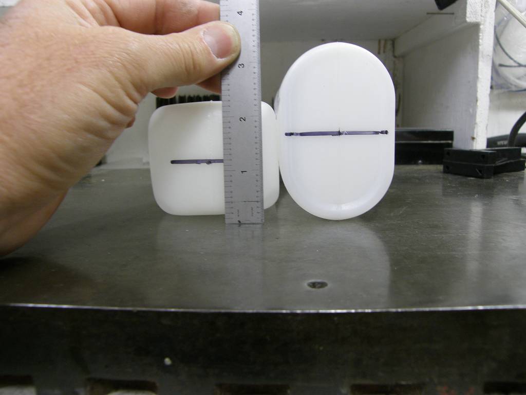

High Tank Problem
OK, back to the P-7. After examining the fuselage, and spending a couple of hours (and a few beers) in contemplation, I have reduced my options to two choices:
1. Go with Tony F's solution. I bought a Du-Bro 16 oz. tank, and it does fit up in the nose much better than the tank that is provided with the aircraft. Examine the attached pics, there is a 1/2" difference in the mid-line of the two tanks. That is significant. The bottom of the tank is the datum. (Because that is where it rests in the fuselage).
Using this tank, it appears to be possible to get the centerline of the tank within approximately 1/2 " of the engine C/L. Not ideal, but in the ballpark.
2. Go for the upright engine installation. This would be a sure bet to establish the correct geometry. Major engineering project, which flies in the face of the "keep is stupid, simple" philosophy. I would like to avoid this scenario if possible. But if that is what it takes, so be it. That is why we call it a "hobby".
Pics: Left= Du-bro tank. Right= H-9 tank.

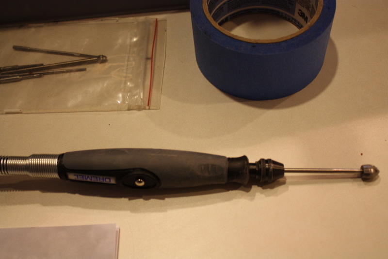

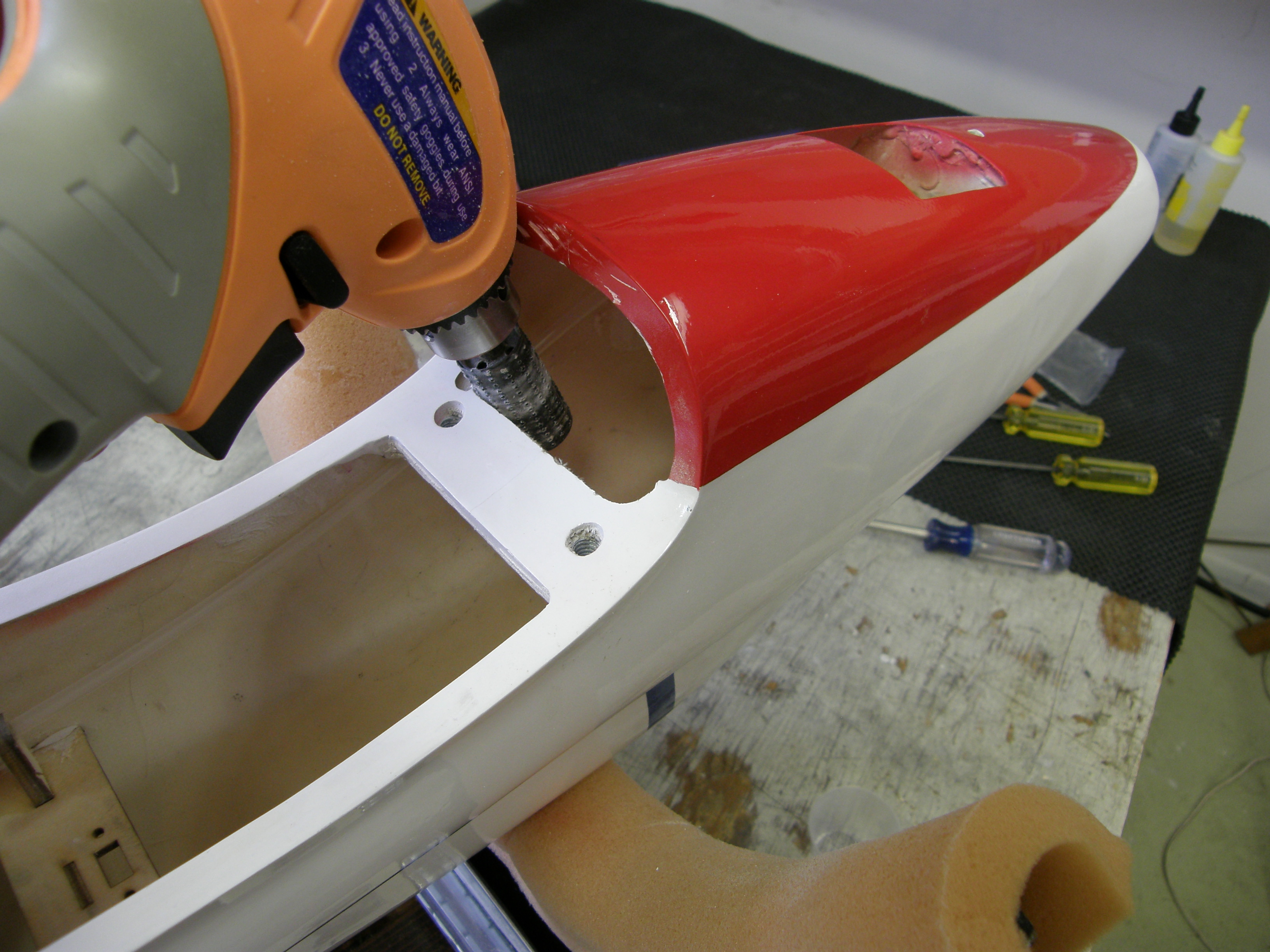

I am breaking from the manual at this point. The first assembly in the manual for the fuselage is to mount the stabilizers. I prefer to do that later with this one. I would rather mount the engine and maybe the nosegear (pending arrival) to minimize hangar rash on the tail surfaces.
The engine mounting pretty much followed that manual. I made a drill jig for drilling and tapping the engine mount. First, I sanded that back of each mount flat, then mounted it on the drill jig. The hole was cut and trimmed for the engine to fit comfortably. The thrust line was checked, and I sanded a hair off of the lower engine mount to take care of some up thrust. I ended up with about a 1/16 spinner gap, with the backplate parallel to the spinner ring on the fuselage.
Thr throttle tube was installed per the manual, and operation manually verified.

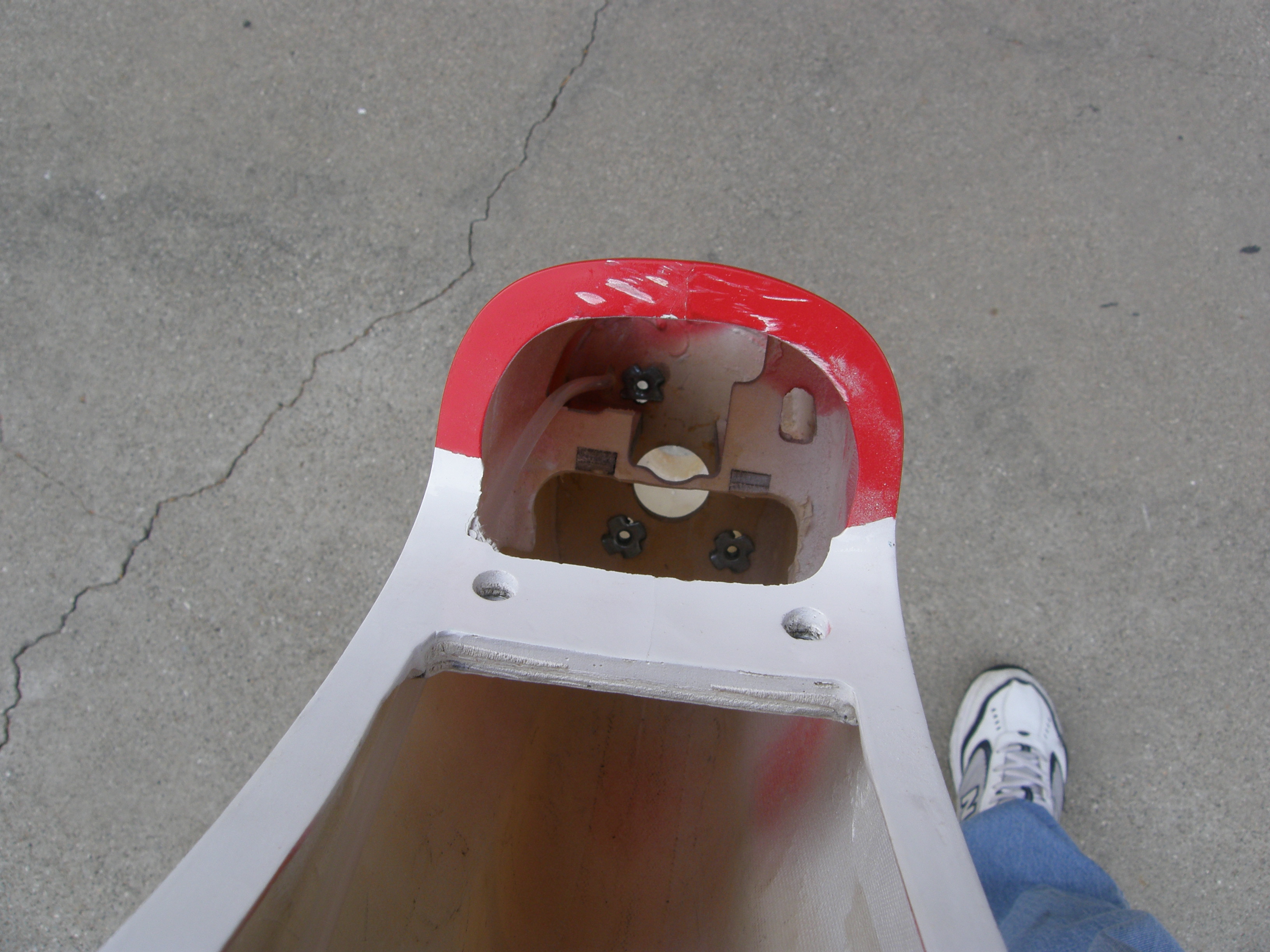

Fuel tank:
I cut away the wood at the rear of the nosegear mount, as that wood as well as the front wing mount were holding up the rear of that tank. Bad news. So I removed the offending material with great prejudice, while not weakening the key structures. Now the tank sits level on the top of the nosegear mount. That is as low as she goes, folks. The center of the tank is 3/4" above the centerline of the engine. Not great, but a substantial improvement over the stock set-up.
After the completion of this task, the firewall and all but the immediate nosegear mount was fuelproofed with 30 minute epoxy. Remember fuelproofing?

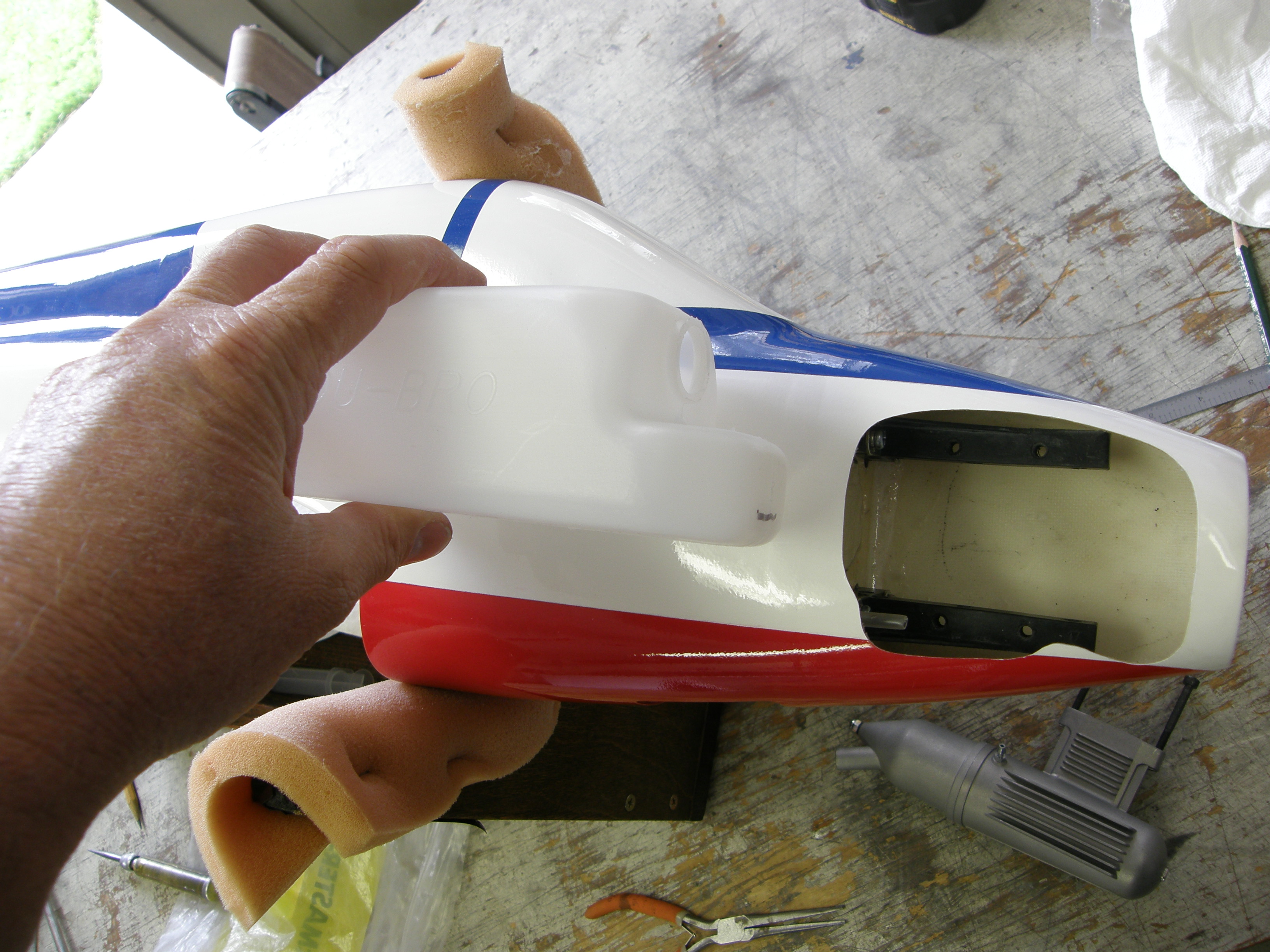

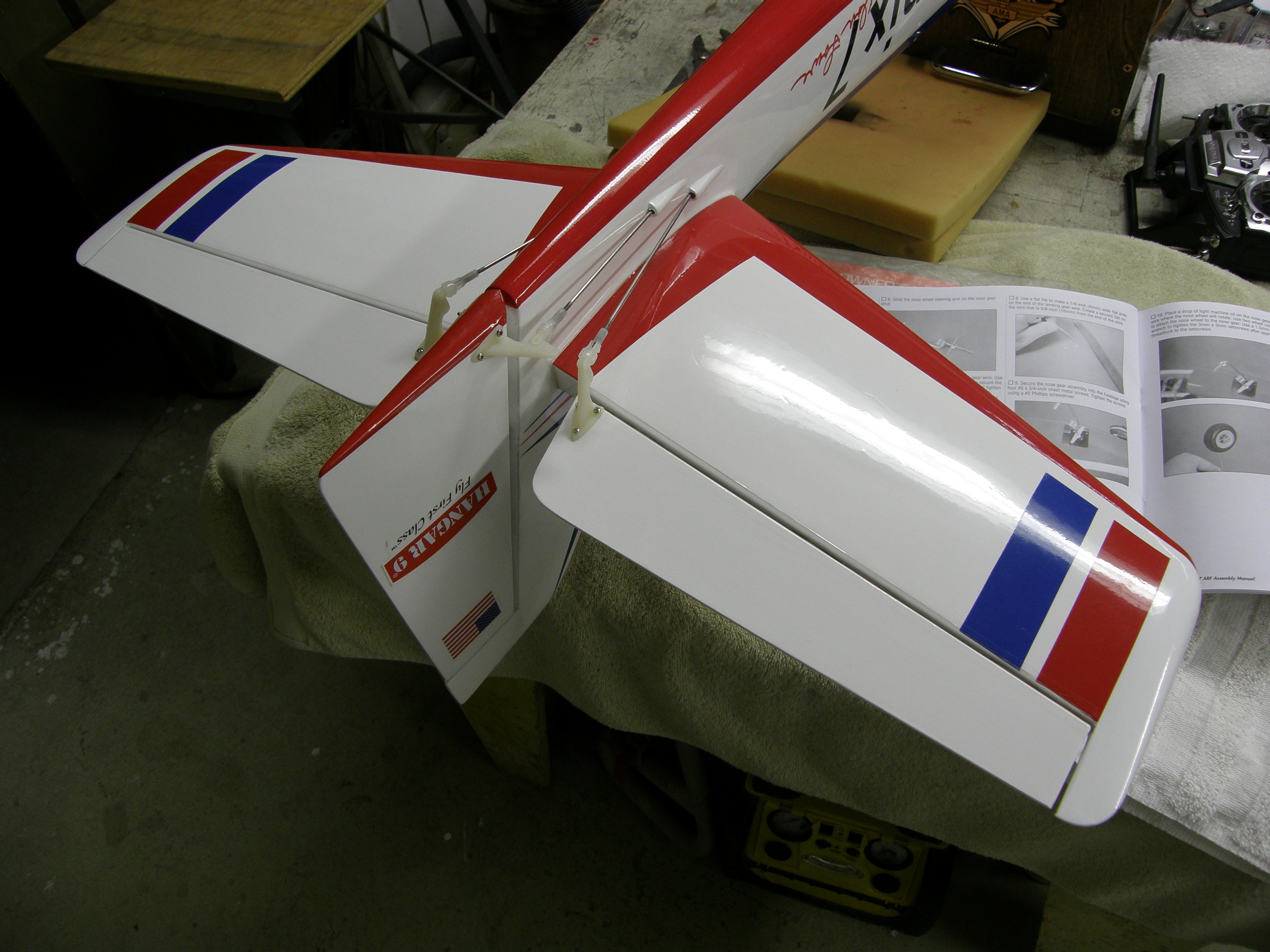

Per Tony F's Du-Bro tank installation, I covered over the hole in the firewall (1/64 ply) and drilled new holes above the engine mount for the fuel lines.
Nose gear blocks epoxied in place per manual. 30 minute epoxy used here. The manual did not specify the orientation of the blocks. I oriented them such that the nose gear unit would be at the lowest value. I hope that is correct, it aint coming out.
Another picture shows the actual level at which the tanks will sit in the nose. Still way high, but an improvement over the stock tank setup.
Time to glue on the stabilizers. Done per manual. Use lots of epoxy.
Next the rudder and elevator servos and linkages installed per the manual, and dialed in to the specifications given in the manual.
