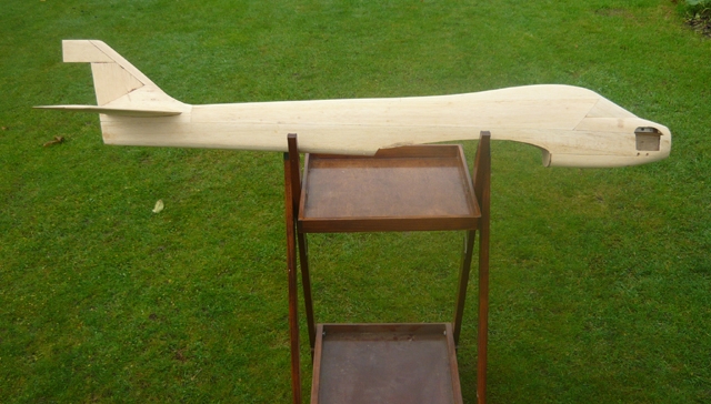

Hi everyone
I got this kit built fuselage with another plane and would like to know the name of it. the dimensions are rudder hinge line to nose ring is 1245mm (49"), wing cord is 362mm (14-1/4") and tailplane span is 635mm (25"). also it is setup for tricycle undercarriage .
any help would be great.

Aurora??

More like MK Skymaster. Aurora for inverted RE with pipe.

Yea, that's what I was thinking (stab is close) but the nose is off (engine was inverted and had glass cowl - at least the MK Skymaster). Also wing saddle is off. The 60 size had a partial wing saddle with a flat spot in the wing LE where the wing met the fuse. LE of wing extended on either side of the fuse side.
Also, the fin is not right. The fin tip was much thinner. This fin tip is more akin to the Mach 1 - not that the rest of the plane has anything to do with an M1.
What about a Cosmos with a wood canopy? Stab would be off though. The fuse top canopy area looks very much like a Skymaster (which also had a glass deck to cover the pipe).

thanks everyone for the info, the fuse must be made up of different kits to get the shape

Picture of MK Skymaster. I think it is a Skymaster You have, the stab is in the right place on your model and has same shape as kit content shown inpicture below. Fin is also close to shape compared to kit content I think.

i would agree that it is a skymaster going by that picture, all the photo's i have seen of the skymaster must be a later version. also would anyone know where to get the build instructions for it .
