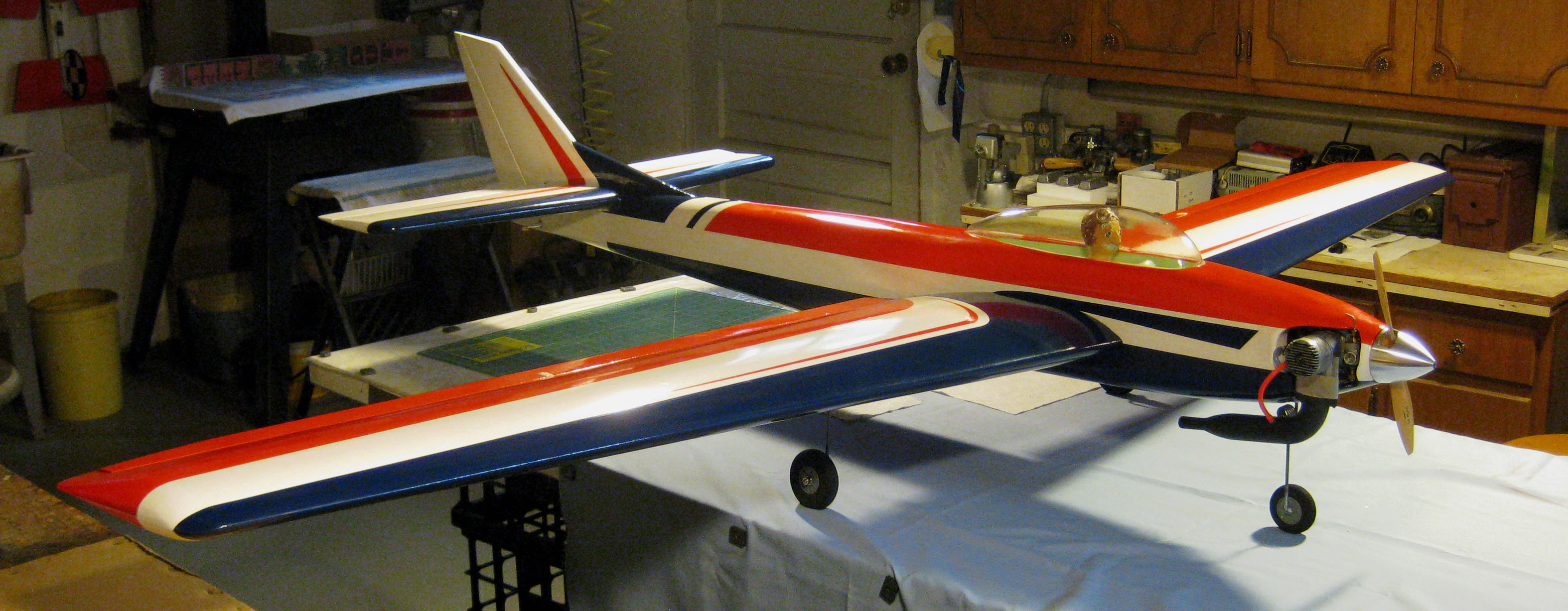

Finally completed my plans-built Simla, and I'm stoked - it came in at 8.04 lb!
It's a clipped wing version (96" span), with a Super Tigre G60 Blue Head ABC engine. Covered it in Coverite Microlite, used mostly contest balsa throughout and pushed everything up front as far as possible. Unfortunately it turned out very nose-heavy (first time that's happened), so I figured out a way to mount the battery in the tail, and CG is now just a bit nose-heavy at 7-5/16" (3/16" ahead of plan). I think I'll maiden it like that, before adding any weight to the tail.

Great to see another Simla out the door. Yours is the first one with blue other than black, but (of course) still very pretty.
The 96" Simla is the version Ed flew at the 1965 NATs. Ed thought nothing of taking a saw to his airplane if he thought it would improve performance. I haven't seen one of those (96") fly yet. That's one of the questions I would have liked to ask Ed if I knew then what I know now...does the 96" span roll or otherwise perform better than the original 108" version? I'd also be very interested on knowing how the plane performs with that engine--I had an OS 90 in the original prototype, (the one in the article). I have toyed with the idea of building a Simla as a two-meter plane with a modified fin and vertical rudder line. Maybe someday after all the other projects on my list.
I'm very happy to see you build and fly one of our Simla models, (I assume the plans were the ones published by Model Aviation.) A weight just over 8 pounds is great. I used contest balsa on the wing sheeting, but then the Radio South paint I used caused it to come in at over ten pounds, and needing a .90 2 stroke. Attached is a picture from 2013 of the prototype in the article being displayed for Beppe Fascione of VR/CS at a cook-out on our deck.
The plane is mostly retired because of it being in the 2011 article, but I will keep it serviced, (like the Spruce Goose I suppose), and it may fly again someday.

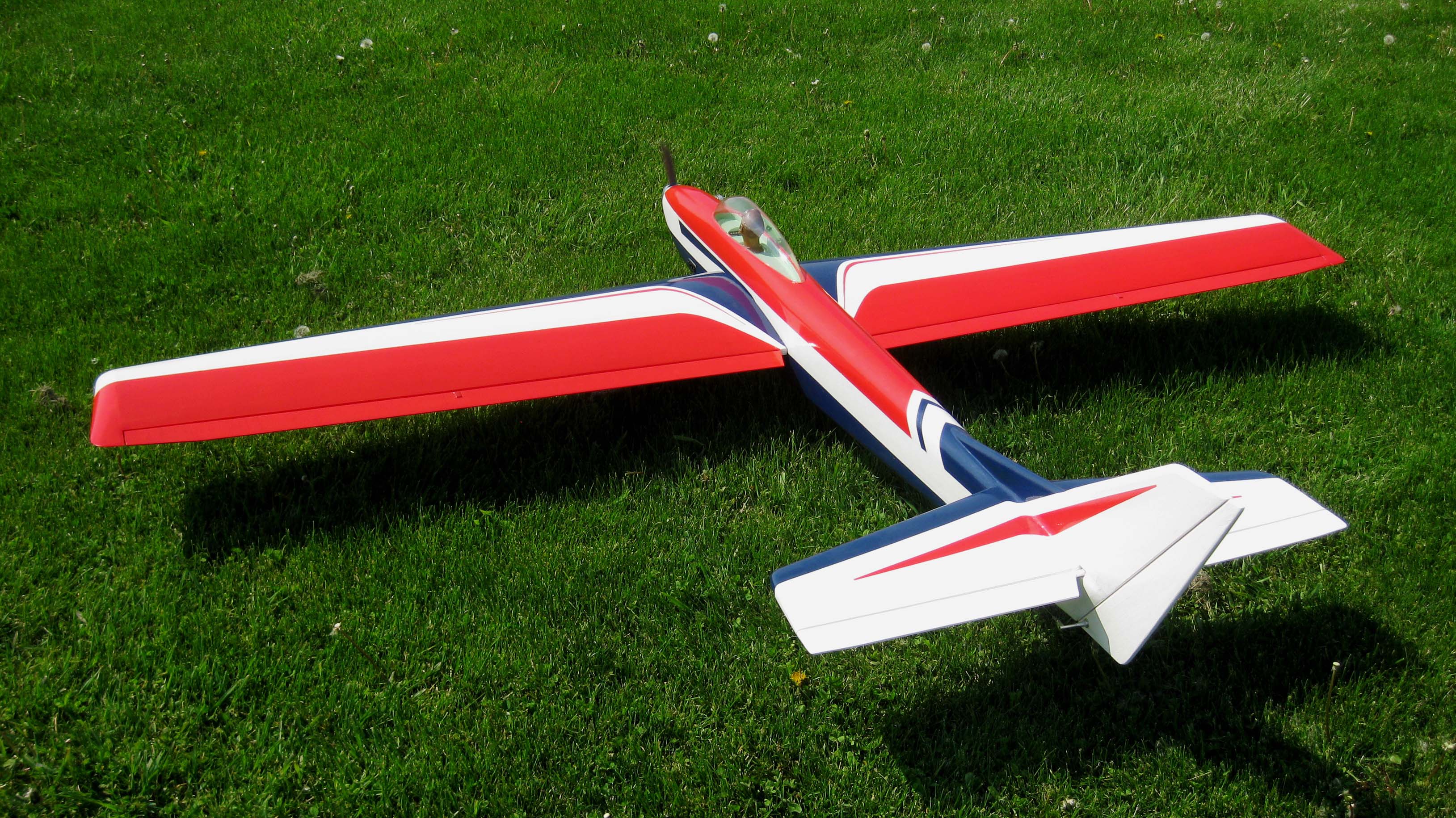

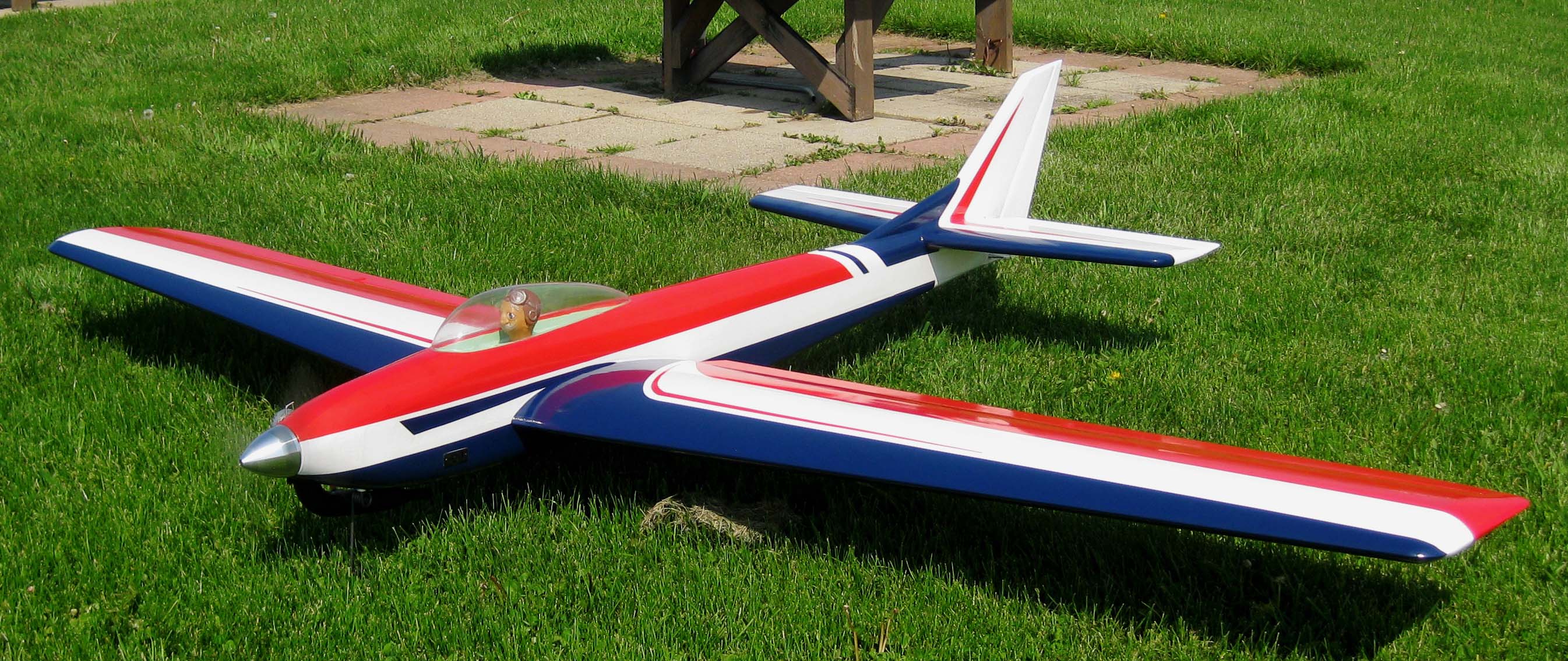

Maidened the Simla today, 96" span with Super Tigre 60 ABC Blue Head. Engine turned 12,000 rpm static with APC 11x6 prop, 11,000 rpm with APC 11x7. Fuel is my own "60" blend (10% nitro, 16% lube, 11% of which is castor). Initial flight a bit too rich and she needed a lot of down trim, but that was easily sorted out. Flies really well with 11x6; 11x7 a bit too much load on the motor - will likely try 11x5 or 11.5x4 next.
Club mate helped measure roll rate - one full roll took 2.3 seconds at low rates, and 1.2 seconds at high rates, this with the 11x7 prop fitted.

Congratulations Redball! Great looking Simla. Nice to see one flying on a .60. I fly mine at our club's field in northwest Indiana (midwestsundowners.com). Not really too far from Naperville. We should fly our Simlas together sometime this summer. You are welcome at our field anytime.
