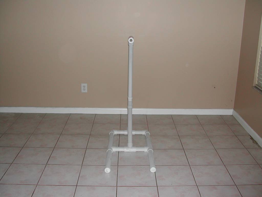

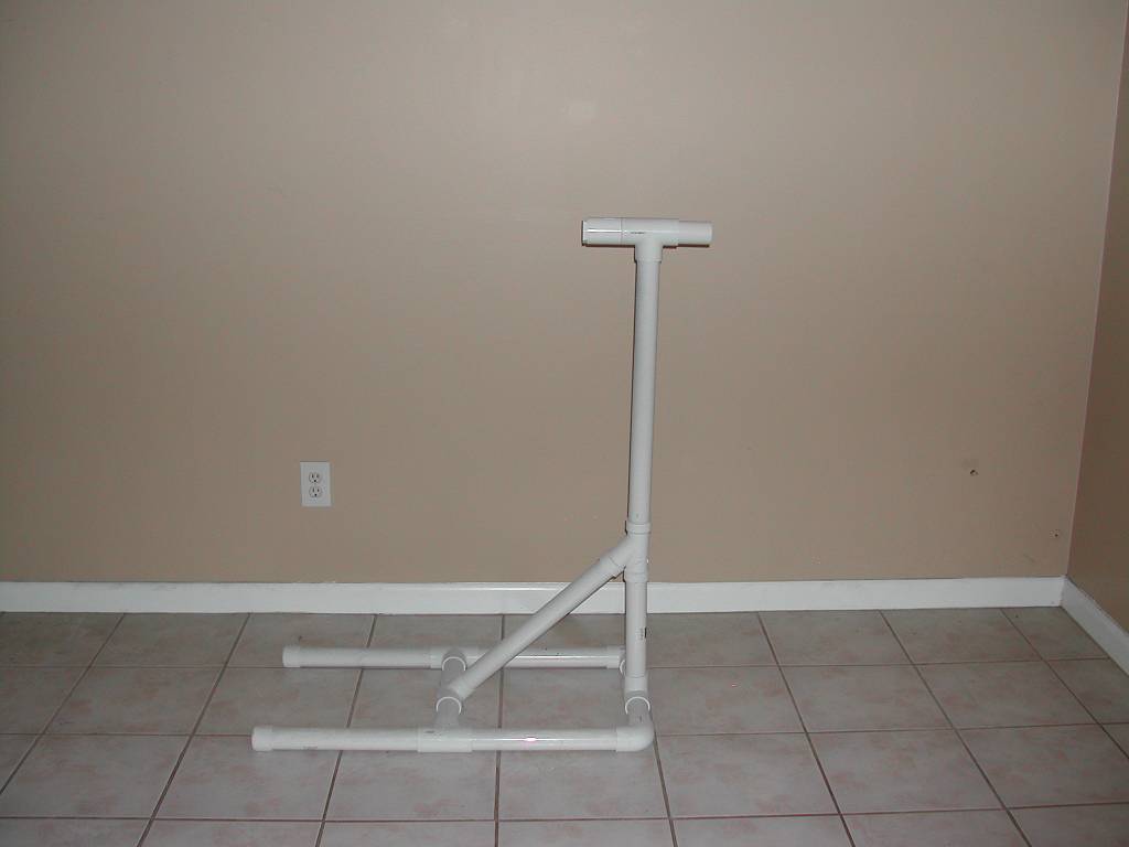

Just a little ditty that I use to do some paint work. I have fabricated heads for 40,60,120, and one 50cc size aircraft. It will also hold wings as well.

That paint stand is like a jig that was previously posted in a magazine years ago(I forget which). However, you made it out of pvc and it appears to be an excellent upgrade! I will be sure to copy it.
The original had an additional arm to hold the wing. It was made of wood and attached to the wing at the aileron servo plate(Remember using just one aileron servo?).

somiss1, this particular idea came from being a long time gear head and engine builder. I basically copied an engine stand in 2" pvc. I did have toream out the upper T in order to get a 2" pipe to slide all the way through and rotate. If you decide to make one I would recommend that you move the angled brace farther out on the legs and farther up the upright closer to the head as that will increase the stability for larger models. When I first built this one I was building 40 size aircraft, not thinking about larger and larger birds.

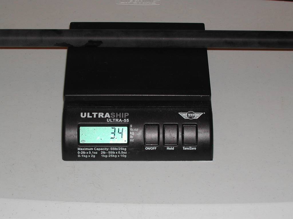

Richard, Just received my tube and sleeve, so it looks like a wing building weekend to me. Check the weight difference.

My set of tubes arrived today, also. That's a nice weight difference. Every bit helps.
According to my measurements, the inner tube is roughly 0.90 inches in diameter, and the sleeve is about 1.02 inches in diameter. (It's flexible, so not able to get a perfect reading.) The holes may not need to opened much, if at all.

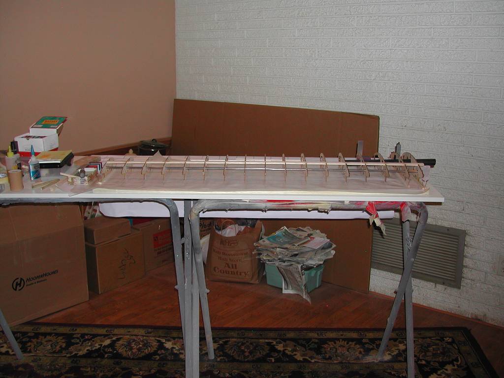

Richard, I basically wrapped a piece of 180 grit from my roll (about six to eightinches longwill do)around the cardboard sleeve supplied with the kit. You will have to start it at an angle and just keep twisting until it makes it's way through the original hole. After that, test and sand until you get the fit you want. It only takes a couple of minutes per hole ( ten holes counting the fuselage) for about twenty to thirty minutes total. It's 8:00 pmright now and I already have the right wing prepped for sheeting and a wing tip. One suggestion that made it a lot easier for me was to tape both sides of the rib feet with a piece of 3/4" masking tape. Before I did that the feet kept breaking off when working the two 5/16"steel jig rods through the ribs. After taping the the feet to theribs not one broke off. With any luck,I'llget the left wing framed up tomorrow and both covered by Monday or Tuesday. Photos to follow.

3. Yes, I have included photos of the blocks and pads that I use. All should be available at your automotive paint store.
4.Yes
5.Yes
6. Yes, A smooth surface is what you are shooting for. The reason I apply two medium coats of primer is to avoid excessive build up (ie-extra weight). The idea is to sand as much primeroff as possible without breaking through the primer.
7. Yes
Check post # 208. Photos were added at 3:00 PM eastern time Sunday. 3 Shots of the right wing frame, and 2 shots of the left wing frame on the bench.

It would be possible to use CF rod in the wings. The advantage of doing so would be that you would not have to fully sheet the wings. It would be strong/rigid enough to just sheet the LE and TE with 3'' wide and then cap the ribs. You could save a good amount of weight, but you would have to cover with film or something different than FG cloth to span the rib bays.
Just a thought.
Kevin Clark
Agree with everything Kevin says about the rigidity since on a sheeting wing, most of the strength comes from the sheeting,a nd if you decided to have a Taurus look by not sheeting to save weight, that would be a good way to do it. That being said, our goal was to duplicate the exterior look of the Simla, while trying to make it as light as possible without compromising that look. A Simla wing that wasn't fully sheeted would be contrary to that goal.
I will start the wing later tonight...looks like billberry got ahead of me again while I was at an SPA contest in Chattanooga, Tn. I lost my primary plane the day before the contest, just before leaving, (you know...one more flight, then we'll leave). Using my back up King Altair that I had only flown a handful of times didn't lend itself for having a good showing...too much good competition.
Duane

Duane,
Sorry to hear about your mishap.
And thanks for reminding me the point of this whole exercise. I was trying to decide just how to proceed with the wings. I checked with my LHS and they have .3150 CF tubes for $7.49 each, so I think I will go ahead and use them to help strengthen the wings and sheet the whole wing on this go round keeping with the theme of this exercise. Later just for experimental purposes I will try the "Taurus" look for added weight reduction.
