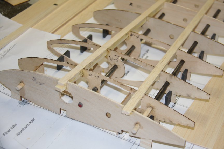

I don't know. I think ''spot gluing'' W-1 with CA then sheeting the top wing and cutting the spars etc to length with your best guess, (but without gluing anything onto W-1), might be the best way to test fit. If everything is OK, you can go ahead and glue the sheeting/spars/alignment dowels to W-1 from the bottom before doing the bottom sheeting. If it isn't OK, you break the glue spots until you get it right. With Jeff's spacer, it should be very close.
After the bottom sheeting is in place, I remember Kevin and I talking about how to glue any bottom sheeting when you can't get at it. You have to run a ''stream'' of CA down the rib from the L.E. and T.E. while making sure the sheeting is pressed against the ribs. We did this I think with ''gap filling'' CA. You just have to hold it in place long enough for it to take hold...it works pretty well. We also ran a bead of gap-filling CA along the top sheeting once it had dried to make sure it had properly adhered without gaps.

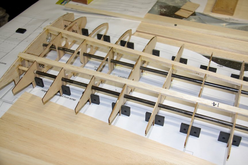

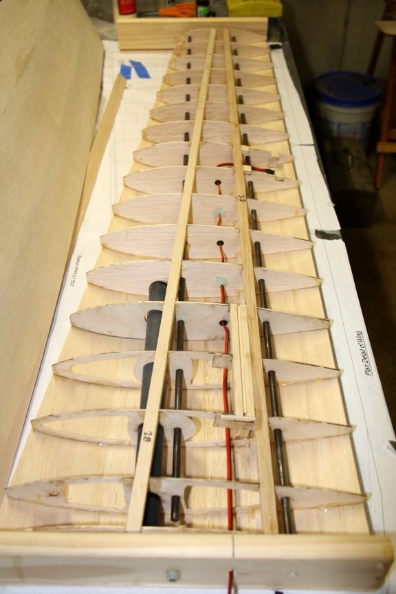

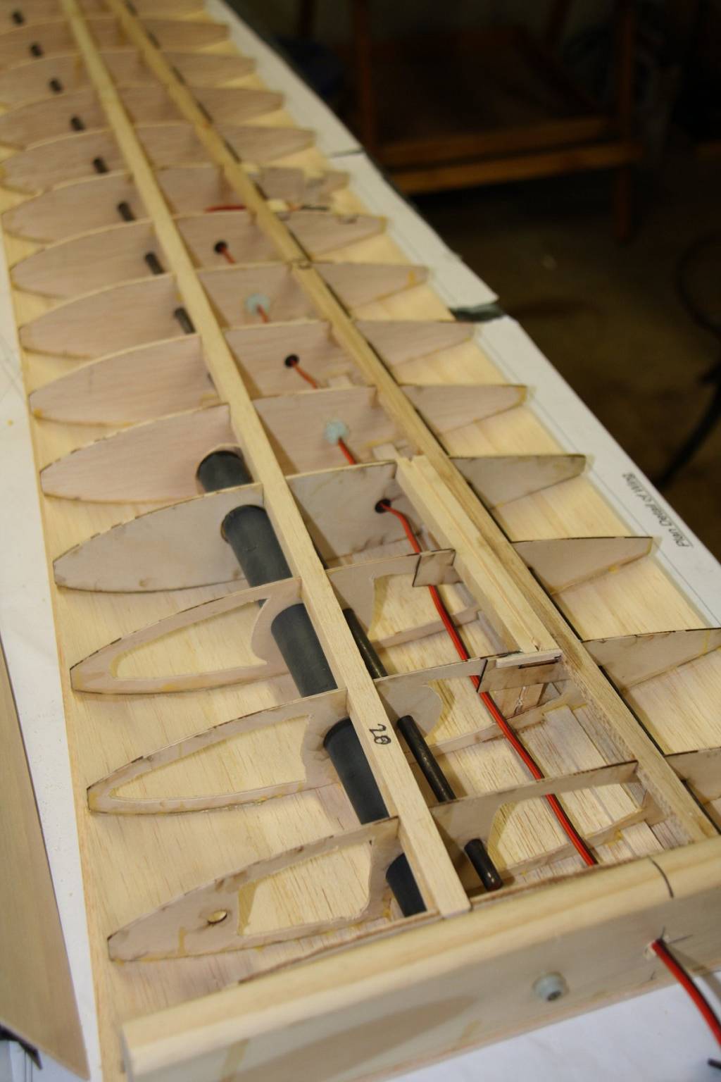

Final set of wing pictures, (unless more research into specific angles is needed), this time featuring my wing. These pictures give a feel for how everything fits together. Taking a cue from Jeff about his future plan for the kit, note the crude removal of wood...especially from the plywood ribs.
Note top sheeting is already in place in one photo, the jig has been flipped over, and the rest of the "bottom stuff" added. In the other pictures, the pre-sanded top sheeting is about to be added, while the bottom sheeting is being glued in the background, held down by big lead weights I got 30 years ago, (lead stays "fresh" for a long time).
After gluing and drying, a second bead of medium gap filling CA is run down from the L.E. and T.E. on each rib to ensure there are no gaps.
As mentioned earlier, you can see some of the wood weights written on the spars to make sure the heavier pieces are sent to the left wing, (the sheeting weights have already been sanded off).
If there is a marked difference in the weight of the pieces, avoid ALL the heavy stuff going to the same wing half to keep from having to add weight to laterally balance.
A more traditionally modern 2-servo system was used for the ailerons using modern extensions. Protect the wire where it goes through the holes to protect from possible vibration damage.
The false L.E. and L.E. are added after the sheeting is complete, and a center line drawn to make sure the sanding is uniform on both sides, (when sanding, you don't want that centerline to be sanded off). The little magnets are great for holding everything in place without pins.

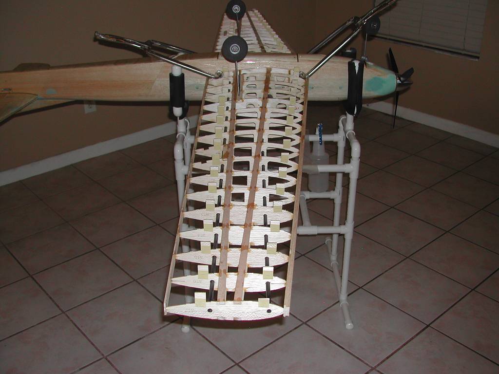

In the last photo of the wing, the servo lead appears to have a different means of "protection" at every other rib and then noneat the ribs that are open. Can you explain a little more about what you used to dothis? I am a little hesitant to add yet another tube to run the servo wire through. Also the servo hatch mounts appear to be four blocks instead of the two suggested in the kit. I did determine that in order to install my servos inside the wing, I was going to have to notch both sides of the two mount arrangement, essentiallyleaving a four block arrangement. I realize that this is a small point, but I was just curious.
#261
ORIGINAL: billberry189
Duane,
In the last photo of the wing, the servo lead appears to have a different means of ''protection'' at every other rib and then none at the ribs that are open. Can you explain a little more about what you used to do this? I am a little hesitant to add yet another tube to run the servo wire through. Also the servo hatch mounts appear to be four blocks instead of the two suggested in the kit. I did determine that in order to install my servos inside the wing, I was going to have to notch both sides of the two mount arrangement, essentially leaving a four block arrangement. I realize that this is a small point, but I was just curious.
Duane,
As for the servo rails, I'm at work now and can't remember exactly why, but I think it was a case of not seeing the need for the extra weight involved in having full hardwood rails, so I simply glued small blocks at the corners to hold the hatch door.

Well I think I have finally decided how I will fit the wing root to the fuselage. First, let me point out that I sanded so much on the fuse sides that the area between the wing leading edge and trailing edge is no longer flat( big Oops). Soooooo, I am going to make a soft rib W1 to go between the wing root ply rib and the fuselage. Then I can carefully sand it down accordingly to close any gaps. I am having to do this because my root rib W1 was already glued solid before I checked the fit( another big Oops). But no problem I really enjoy the build. After I have the root rib fit the way I want it, I will lay the sheeting on the wing while it is attached to the fuselage and fit it to the fuselage and then glue it to the wing frame. BTW I went ahead and installed the .3150 CF tubes in the wings at a total cost of 5.6 ozs. but that should be more than off set by the contest balsa sheeting I ordered this morning and carving out the wing tip blocks.
PS- This is the first time that I have built a two piece shoulder mounted wing, so a few errors are helping to add to my learning curve

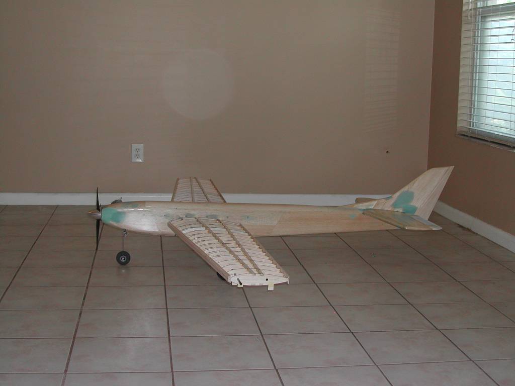

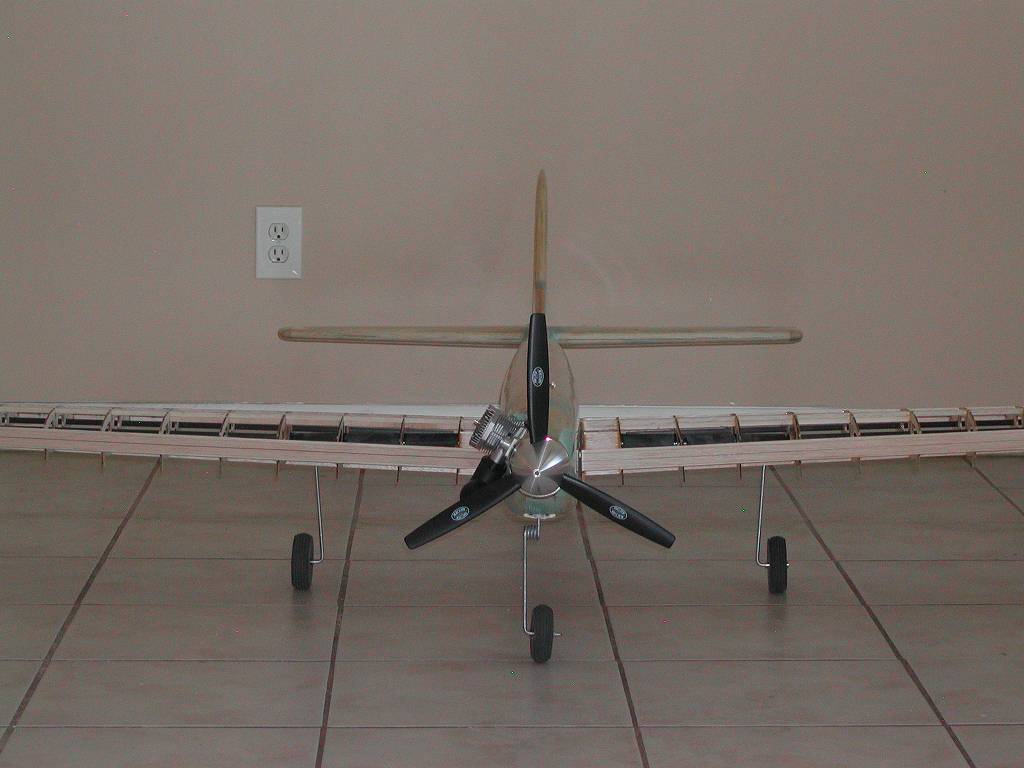

] Keep up the good work.I know it's early, but it looks like you have more nose wheel length than you need IMO, even for a two blade prop. I'd retract it into the fuse a bit.
Duane

You are exactly right.I cut the nose gear down once already, but it still hits the bottom of the motor mount. There's still about a 1/2" left to be cut off. Boy, you really have studied those early photos of Ed's Simla. I won't be sure until I actually get some color on her,but I think the fuselage is a little thick (top to bottom) aft of the wing to the tail feathers. What do you think?

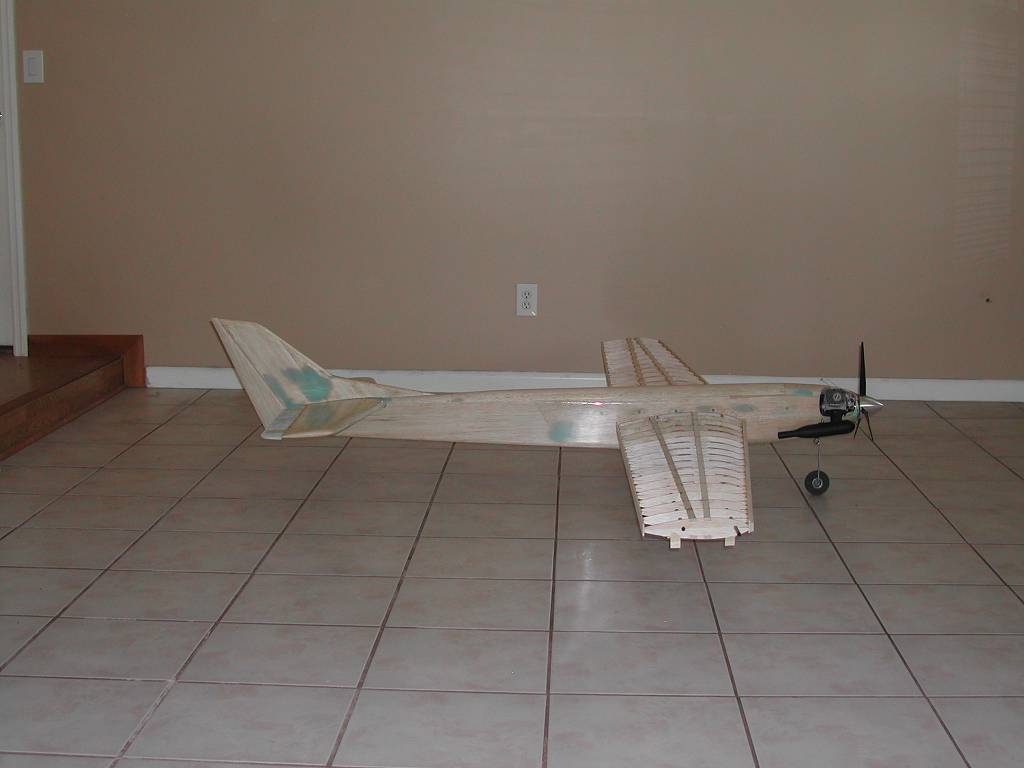

Spent the day working on getting the wing root ribs to fit the fuselage. Ultimately, I wound up breaking the glue joint of the rib at the leading and trailing edges. Then I bolted the wing to the fuse with the guide pins in place, clamped the leading and trailing ends of the root rib against the fuse, and epoxied them back to the leading and trailing edges. Now when I receive my sheeting I will fit it to the wing while it is still attached to the fuse and then remove the wing from the fuse. Then all I have to dois glue the fitted sheeting onto the wing while it is on the build bench. If everything goes as planned it should give me a nice close fit on the wing. Notice the reflection in the second photo on the clear coated unpainted side of the fuselage. That's why I use the clear that I use.

THAT'S SOME CLAMP YOU'VE GOT THERE!! If I were building another, I'd be sure the fit was better. Being this was the first, and the first time I had ever built-up plug-in wings, I just built the thing, used the spacer and hoped for the best, assuming it would fit. It DID fit, but it was Kevin's fuselage.
I see you glued in the spacer pieces provided by Jeff to get the right angle, (hopefully) between W-1 and the fuslage. It's funny the difference in how people think...it NEVER occurred to me to glue those pieces in, (though it makes perfect sense to do so...why not)?? I simply used them as spacers only. Go figure!!
I thought about possible ways to close the gap, even considering wing saddle tape, in the end I sanded as best I could to close the gap...then just moved on. While I would have liked a perfect joint, let me assure everyone that the plane flies just fine with a space there.
Duane
Duane
