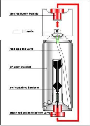

Lorin,
It seems like urethane clears apply over cured enamels and lacquers without a problem. I've been painting with cans in the absence of a compressor and found this stuff:
http://www.repaintsupply.com/pd_2_part_2k_aerosol.cfm
Looks promising, what do you think? Ingenious 2 part system in a can - never seen that before.

These were the types of paint can product’s I was referring to in the other thread.
Spray max, U-pol, Transtar all trade names for can systems like this.

My Feedback: (15)
Are you guy's painting with this rattle can system, as pictured? I have had excellent result's with the TF Lustre-Coat. From the source's shown in these thread's, can I buy acrylic enamel ready to go with these spray can's, or whatever else that can be used, for up to 20% nitro ?

My Local PPG rep custom mixes color match paint and can put it into one of these Spray Max cans.
Spray Max is not just the paint but the paint can system. I just happen to have a local source for this.
http://www.spraymax.de/index.php?id=443&L=1
You can get the same results as a high end spray gun setup.
