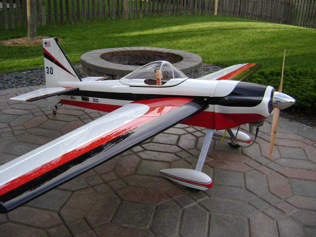

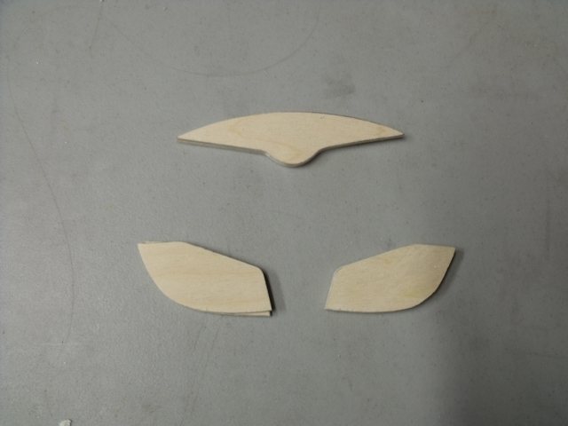

I have been following the Classic TOC Builds that Rusty and other have been doing and decided that my 33%Laser qualifies. Not wanting to jump on his thread with another build I'm going to do my build here. I do welcome any and all comments, suggestions. I am actually building two Lasers with the second one being put up for sale upon completion of the frame up. Gotta pay for an engine and servos somehow right? I have the Fuses all framed up at this point. The gear is CF and was found on fleabay. I have one set of glass parts layed up and will start the second set later tonight. I have decided to go with foam airfouled tail section. There was lots of debate on the Aerodynamics forum if this was going to enhance performance or not. I guess we will find out. The thickness of the tail section will only be 3/4" at it's thickest so the tail wires may still be needed or I will put in a CF spar to get them srtong enough. The Goal weight is 16 lbs and as of now the power choice is a DLE 55 and canister. Here are a couple of pics along with a couple of the one I lost this spring.
ID:	1692685   Click image for larger version
ID:	1692686   Click image for larger version
ID:	1692687   Click image for larger version

David, last time I checked I was not an elf lol. No this laser is a seperate deal then Rusty's. When I first started IMAC in '97 the Lanier/Godfry Laser was very popular. Most were powered with Bryson 3.2 or 3W 70 twins. For the most part they flew really well. After a few years of flying 40% airplanes, spending 10-15 hours a week practicing and keeping a huge budget to stay competitive, I decided I need to go with a smaller airplane and fly more for fun then have the " Must Win " attitude. It was then I thought about the Laser. The structure lends it's self to light construction, we have lighter and more powerful engines now, servos and batteries have come a long way as well. As luck would have it, I found a kit at a local swap meet. The finished product from that is the yellow laser pictured. It came out at 15.25 lba with a DA 50 and standard muffler. I did manage to fly it in 2 IMAC contests. She held her own in every respect except I could have used a little more power as Unlimited is quite power hungry. Yes it was only 15pounds and change but still had all the drag of a 33% airplane. Although I was very happy with the flight performance, there is always room to improve. The most noteable change will be the tail, foam with airfoil. The other big change will be the wings. Different airfoil, reduced span, larger ailerons.
The build will be a slow one so I am hoping that we can have lots of conversations about aerodynamics, powerplants, servos and everything in between. Like I stated earlier, the second one will go up for sale, it would be really cool if that person were to be someone who participated here so we both can give flight reports when finished.

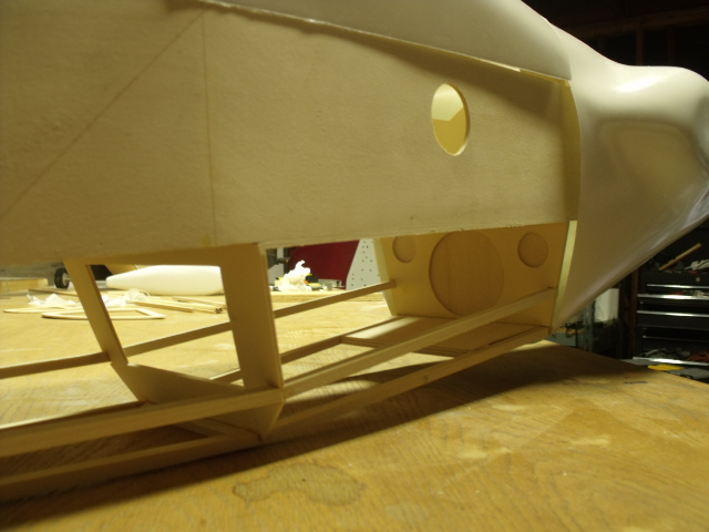

After a week of laying up glass I have some progress to share. All the glass parts are made for the two 50cc airplanes and I even got out the version I was setting up for a DA 85 and got it's parts layed up and got it to the same point of the others. Next will be the turtle decks. I am not able to find enough 1/4" sq spruce locally so I have had to order it. While waiting for that I will work on getting them on their wheels and start cutting foam. In the pictures you can see the hole that can be cut out should one want to use a canister exahust and the elevator servo mount. The elevators on the 50cc versions are pull pull from a single servo and the 85cc bird has dual servos in the tail
Shawn

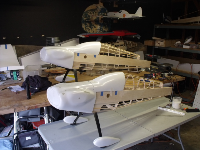

Slow progress but the turtle decks are done, they are on wheels and I have all the glass parts mounted. Next will be the foam cutting. I actually made my own axles this time out. Took some 3/16" titanium and threaded one end to 10-32. A couple nuts, one on each side of the gear and instant axle. Got to get an engine and exahust on order soon so I can get the pipe mounts right.

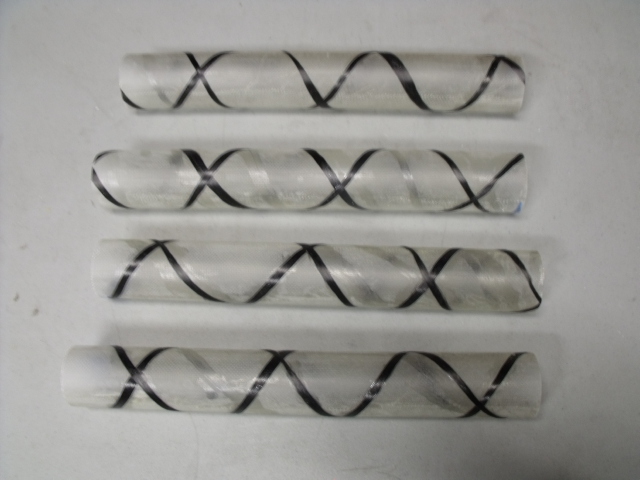

More updates, don't be shy guys I would love to hear some thoughts. I will be cutting foam this week. Finally finished all the templates. Over the weekend I I made up some wing sockets. They are one layer of 4 oz fiberglass wound with 3K CF tow to add some strength. Got the cowl mounts cut as well. The arched peice will be glued to the top and the other peices will go in the bottom corners. Screws will pass through F-1 and into blind nuts in these tabs to secure the cowl.
As a side note, I have a 3rd fuse that is being set up for a DA 85. After checking that the canopy from a Great Planes 50cc Yak 55M was available, I decided to make that one into a Stephens Acro.

I'm curious how you went about making the wing tube sockets?

Ralph, It is actually quite a process. I start off with a 1.5" dowel wrapped in mylar packing tape. The surface of the dowel then gets waxed with mold release wax. I wet out the cloth and roll the dowel picking up the cloth at the same time. This gets the dowel wrapped with cloth. I let that cure up and then with an xacto knife I split the tube lengthwise. This is the only way to remove it off the dowel. I apply the release wax onto the actual wing tube next and slide the sleeve in place. I then seam the sleeve with a strip of cloth and lastly wrap with the CF tow. After that cures the sleeve is rotated and broken free from the wing tube. What I end up with is a sleeve that is always a perfect fit to the tube I intend to use. It is alot of work but the sockets as pictured weigh .4 oz and will never wear out, get dirty ect.

How long are the wing tubes...they look short?????

Scott, they are 11" long. They look a little short due to them being 1.5" dia. Most 50cc airplanes are between 7/8" and 1".

ok.. still look short as we have about 14-16 inches in a 60/120 size plane , at 7/8 inch dia. and then we do a false rib at the end and tie it into the top and bottom skins.

Thanks. I tend to think most are overbuilt in this area. The 2M version of this airplane has a 7/8" CF wing tube that goes 8" into each panel and is closing in on 100 flights. I do a 1/8" lite ply false rib at each end that is 4" wide. This sub rib ties to the upper and lower sheeting with a unidirectional CF strip that runs half span between the sheeting and foam. The root is capped off with a balsa sheet that is 2 layers of 1/16 balsa, one layer vertical and one horizontal with a layer of 2 oz cloth between them. Seems like alot of work but it yeilds a very light bullitproof wing. The 2M wing panel weighs 19 oz with a full size servo and is 493 sq in per panel.

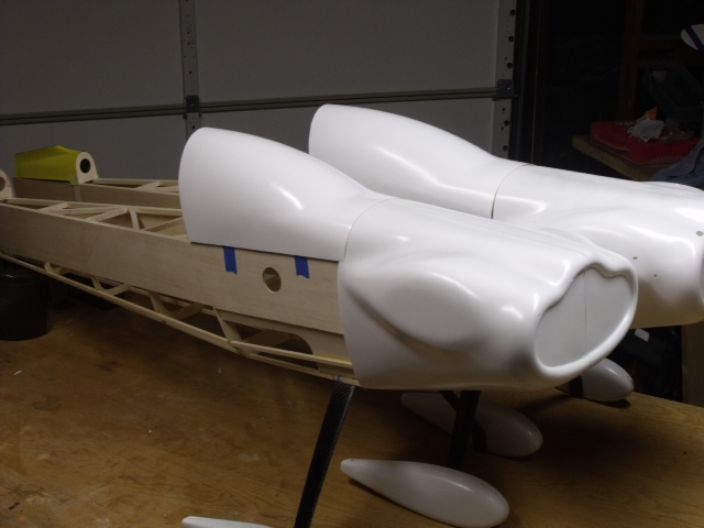

Thanks David, I love the G-RIDE color scheme and will be doing that one. I tend to get stressed out when trying to come up with color schemes. What I tend to do is go way overboard and end up spending a grand on covering and paint LOL. Cutting foam off and on all day today. Got one set of wings done and now taking a break to take my foam cutting assistant to lunch for her compensation.
