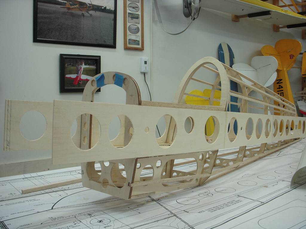

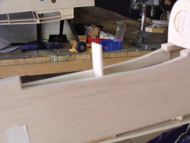

Here is the beginning of mine

Looks really good. The rate I am going, we will be test flying close to the same time. LOL

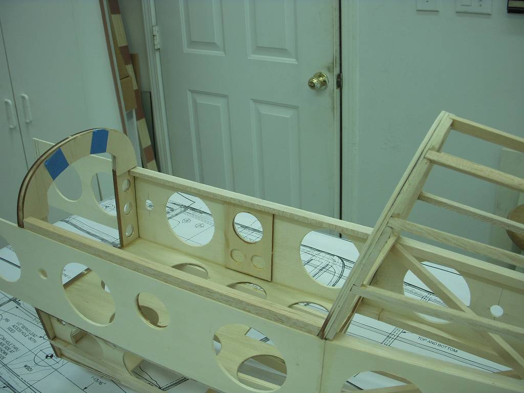

It was a little nose heavy but the cowl on that was heavy and I did lightening holes in the balsa fuse sides. I ened up putting the RX battery about 8" behind the canopy. On the new one, I may have the same issue, the header and canister weigh a little more then a pound. What do you plan to do foe flying wires on the tail?

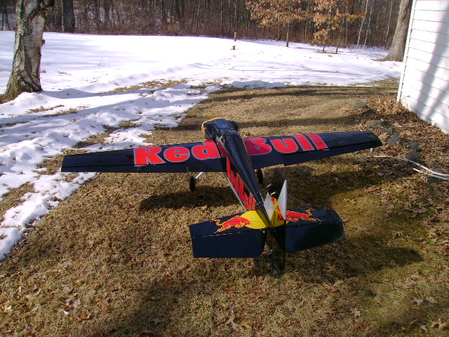

I have enjoyed this thread a lot and have been gathering parts and materials for my Laser build. Then, wouldn't you know I found a quick fix to my Laser desire. Went to the Twin City Radio Controllers huge auction a couple of weekends ago in Minneapolis, MN. There before me was a Lanier Laser all built and looking very nice. For a high bid of $265 I took it home. It came from an estate buy out as I understand it and is a clean, no scuffs airplane. It is apparant though that it is not a light weight like is being built in this thread but it is a starting point. The light weight will have to wait for sometime in the future. Fuse, wing and wheels weighs around 16+ pounds and should come out around 21 pounds ready to gas up. Got the servos ordered and the DLE 55 is waiting to be installed. It will serve the purpose for the flying I enjoy.

Looks great!!! I love the Red Bull Scheme. I have lots of pictures of Lasers from the mid 90's. Most were powered with 3W 70 twins and came in at about 21 lbs. They seemed to fly well anyways. With the DLE 55, you may find that you will need to dump some weight out of the tail. If that is the fact and you need any suggestions let me know. Question, is R/C city in St. Paul still around? I used to get stuff from Maury there, if I remember correctly he was on 7th st. just south of the 7th st bridge.

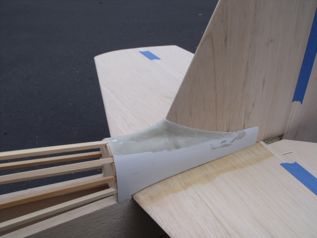

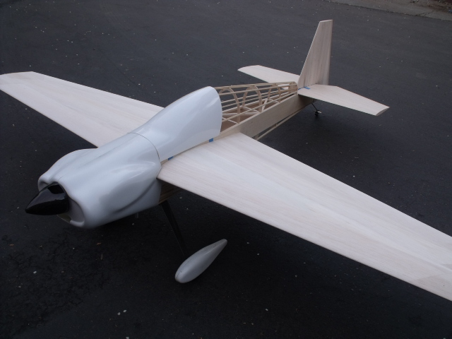

I got a couple of wings sheeted. The first is the root end just out of the bag. I took a break from sheeting the second set of wings and rough sanded the first set. After the sanding, I put them both on the scale..................16.5 oz each. At that point, I couldn't help myself. I put both panels on the fuse and weighed it. At this point everything is there except for radio gear, hinges and prop. The weight at this point is just over 11 lbs.

Did you use 1/16 sheeting on the wing panel? and how bout spars? Im using the stock kit lanier foam shucks but gonna eliminate the rear spars in lue of larger ailerons. then core out foam in between the ribs. thinking of using 1/4" hard balsa sticks for spars and put some carbon fibre strand top and bottom. I also have a good stock of 3/32 and 1/16 lightweight contest balsa i found from a retired rc'er.

Speedracerntrixie, the Maury you knew moved his shop from St Paul, to Burnsville, MN where I lived and knew him briefly. Sorry to say cancer took him a few years ago.
Regarding the tail heavy Laser, it was powered by a heavy G62. I will power it with a DLE 55. Rudder and elevator servos are mounted under the stab. Extra weight up front will come from the ignition battery which the G62 did not have, plus the radio battery was monted behind the wing in the turtledeck so that can be moved forward. I will mount the throttle and servo as far forward as possible. I could also move the rudder servo forward and set up a pull-pull cable to the rudder. If that all doesn't work, I will put a bag of helim somewhere back by the stab.
If all goes well with the Laser next summer, I will strip the covering and install lighter components or go with more power. I have considered a DLE 111. Either way it will be fun.
Thanks for the offer of help. I will keep that in mind.

Derek, I sheeted the wings with 1/16 contest balsa with no spars. I have done both Colombo Anderson and Carden 40% airplanes that were sheeted the same so I figure it will be just fine on my little 50cc Laser. On my kit built Laser, I did everything as per plan except I used the softest 1/4 sq balsa I could find for spars and I cut 2" holes in the foam at the leading edge along with 1.5 and 1" holes in the trailing edge. I did not cut out the foam from the bays. The ailerons werejust a tad small. With the new one I will be adding 3/4" cord to them.Still hit 15.25 lbs with that one and used the alum wing tube and gear.

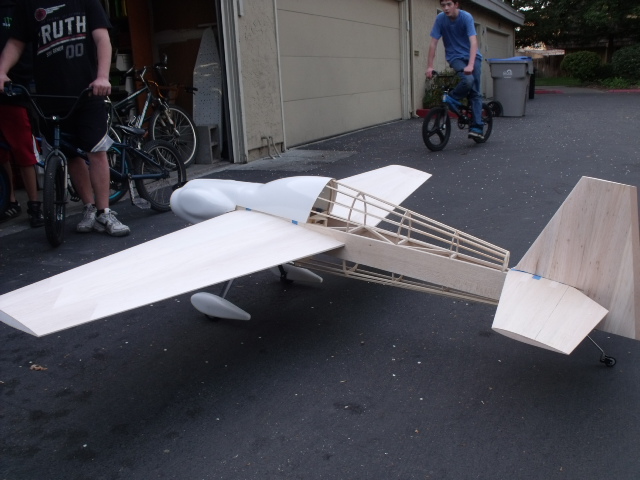

Progress is still slow. Racing season is coming uop so I had to dust off the race planes and take some laps. Today I did manage to work on the tail mounting some. This consisted of making up some light ply doublers and a vertical former that will key the horiz stab and vert stab together.

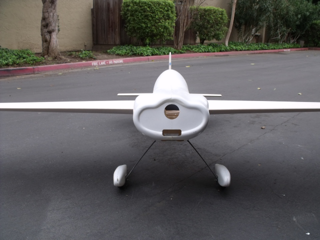

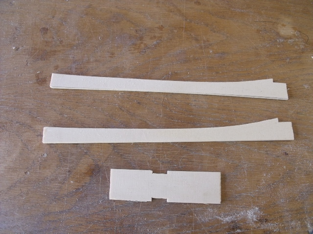

Now that all the big building is done and we are to the little detail stuff, I am getting a little more motivated. Todat I seperated all the control surfaces on the tail and built control horn pockets for the G-10 control horns I will be using. Once covered the horns will get a film of epoxy on the base and then slid into place. I was also able to get the canopy mounts done. CF pins up front and tabs in the back. Had to do this one different, the tabs are mounted to the fuse and insert up into the canopy. Not enough room to do it the other way when the wings are in place.
Chris, yes I am kinda stuck in the race theme. It's all good some of the Red Bull airplanes are spectacular. Almost makes me want an Edge, they just don't fly all that well with the strait leading edge though.

Nice work, I'm impressed by your edge. How do you cut it so straight and smooth? Do you use guides on top and bottom to get it symmetrical?
Also, where do you get the control horns?

Jer, most of the parts shown are cut with a Dremel saw. One of my favorite quotes is " The difference between a good airplane and a great airplane is the amount of sanding" I have a ton of sanding tools of all shapes and sizes. It's a matter of taling the time to work the part. The control horns were ordered from iflytailies.com They are a glider outfit.

Well things are starting to move a little quicker now. The wings have been sanded, all I need to do is cut out the ailerons, face them and do servo mounts. The tail needs to be hinged and beveled then the airplane is ready for paint and covering.

Don, thank you for the complements. The Lasers pictured are actually based on the Lanier kit. All the fiberglass parts would indeed fit a stock Lanier kit. The stock airfoil as shown on your plans works really well. I was going to use it but I was unable to get my set of plans and templates back from a foam cutter I tried to have cut my wings. I ended up using an airfoil that has been working really well on my pattern airplane. For this type of airplane, I suggest you do not incorporate washout. The wing does not need it, there is not enough taper and the wing loading is low. No dangers of tip stalling. The Lanier kit with the proper materials used can easily come out at 16 lbs.
