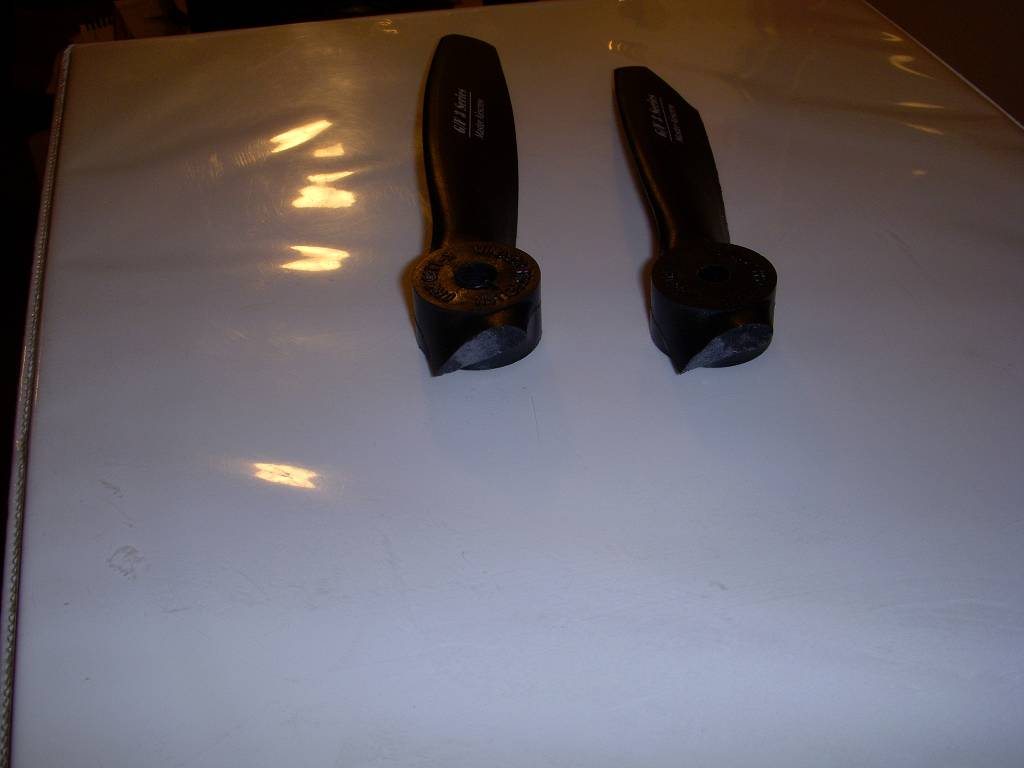

I'm going to give facts here, you can draw your own conclusions.
Last week, I was flying my OS .55 AX powered Deception 40 and in a down-line with the engine turning very high rpms, the prop let go. The firewall was ripped from the plane and the cowling was trashed. I brought her back dead-stick and landed with the engine, firewall, and what was left of the cowl hanging from the throttle cable.
I thought I just pushed it too far.
Today, I was flying my new Curare. At the time, I was just flying straight and level at around half power. There was a loud vibration, the canopy flew off, and the engine shut down. Another dead stick landing. Checking the plane revealed that the prop had failed at the root of the right blade in an identical manner as the one on the D-40. This caused my engine mount to fail. Fortunately, there was very little damage to the plane.
Both props were purchased at the same time from my lhs. They are both Master Airscrew G/F 3 Series 11-8.

Looking closer at the failed props, there is a "crease", or a transition between the hub and the blade. The failure is exactly on that crease. The failure is not located where the spinner would contact the blade.

Hello,
Looking at the blades it seems that in both instances, the same blade failed. This would seem a little unusual. Out of curiosity, do you know which blade you hold on to while tightening the prop nut? The reason why I ask this is that I noticed some crazing on my APC-E props (which are pretty thin) and it always seemed to be the same blade regardless of prop. Then I realized that the blade showing the damage was the one which I normally hold while tightening the nut. I am much more careful when I tighten the nut now and the problem seems to have goen away. I must have been lucky since I have never had a blade fail.
Teo
Teo

This is a theory that has merit. I don't pick a particular blade to hold onto, I just grab the one that is convenient to the way I am holding the wrench. But since it's always the same hand, and the same wrench...
I could see that procedure putting alot of load on the blade. But how can you lower this load? Is there a procedure that minimizes it?

Looking a little closer at the fractured ends it looks like both props may have been cracked for awhile. The light gray areas in the photo are where the blades were still connected and the darker areas are where the cracks were. The reason they are darker is because the cracks allowed oil to seep into them. I've seen this type of failure in metal quite a bit and it looks very similar to your props. I doubt that this is a manufacturing flaw. I think the blades were stressed somehow.

I think that you are correct that the dark areas are areas that the crack existed prior to the failure and the light areas are the areas that failed when the blades separated. I don't think that the dark color is oil soak, it's just a different type of crack surface.
My new theory: I did not sand the flashing off of these props. I think that the sharp edge of the prop, combined with the stress riser of the crease, combined with loads due to holding a blade while wrenching on the prop-nut, caused a crack in the blade at the crease.
This crack grew during operation and then failed.
