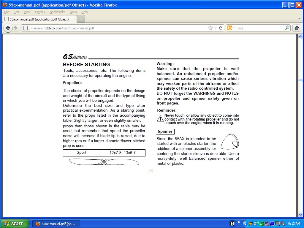

Here's what TFM says.
I went down a size (and increased the pitch from the suggested 12-7) due to ground clearance issues on the D-40. I don't have enough clearance in the grass for a 12 inch prop. I have no such excuse for the Curare.
I see no warnings or information on MAs site about using that prop on a .60. It says: "Acclaimed Sport Props. Made of Glass-filled Nylon for strength & durability"
I'm not saying that what I did is right, just showing how I got here.

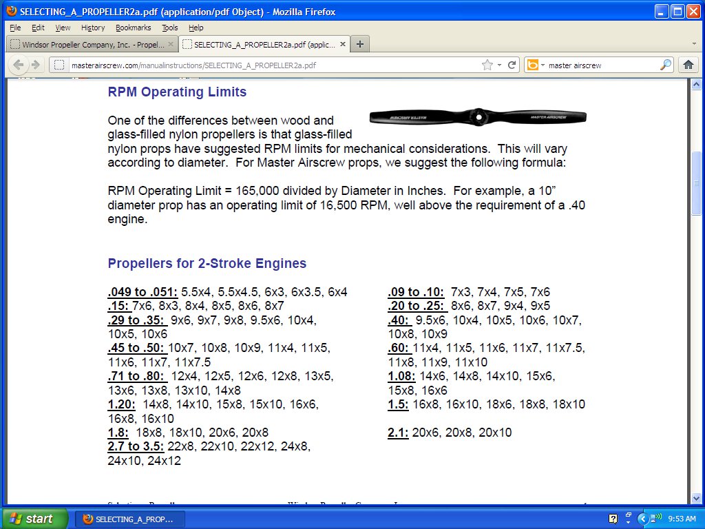

Back in the day, we used to boil the props in water for a minute or two to get rid of 'stress'. Haven't used that technique in decades.
The manufacturer website says 15,000 RPM max for their 11" props, based on dividing 165,000 by the prop diameter:
http://masterairscrew.com/manualinst...tructions2.pdf
They have a Formula 1 high-performance series that will probably hold up better, or try an APC. They rarely fail, and need little balancing. They have lots of flash and sharp edges though.
Balancing is a forgotten item until one has a failure such as yours. Really doesn't take that long, is good for the airframe and electronics also.

Both blade failures appear to be fatigue related, not overload per se. The breaks are clean, and there is evidence of crack propogation. High RPM caused final failure as the cracks spread. Fatigue is related to operating RPM - especially dangerous if you transition slowly through critical flex frequency of the blades, ESPECIALLY bad if critical frequency is at or near full operational speed. Relatively small root section vs. heavy blade (as in the case of both of these MA props) lowers critical frequency, putting more fatigue stress flex cycles on the blades as prop goes from idle to full load.
The section area at the breaks is relatively small when compared to other well designed glass reinforced props such as APC.
MA props are not very efficient aerodynamically. Propeller efficiency of any APC prop compared to "equivalent" MA is noticeably higher. I have compared them in the air, and the aircraft performance is noticeably better with the APC. This, along with the apparent danger associated with MA props should convince anyone to use APC, not MA.
MA props do have their place. I use mine for stirring paint and large batches of epoxy. Literally. I would not mount one on the crakshaft of a model engine any longer.
