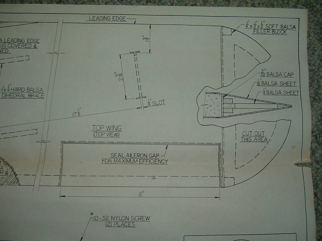

One final request - could you take 4 pictures of the plans and post when you get a chance? Just show high detail shots from the middle of the plans to each corner so that all the details and fine print can be read.
Old 01-07-2012 | 08:44 AM
  #27
plumberdeluxe's Avatar
My Feedback: (209)
Joined: Aug 2002
Posts: 565
Received 34 Likes on 32 Posts
From: Thornton, IA
Default RE: Pulsar Bipe Anyone?
Let me know if this helps.
Dave

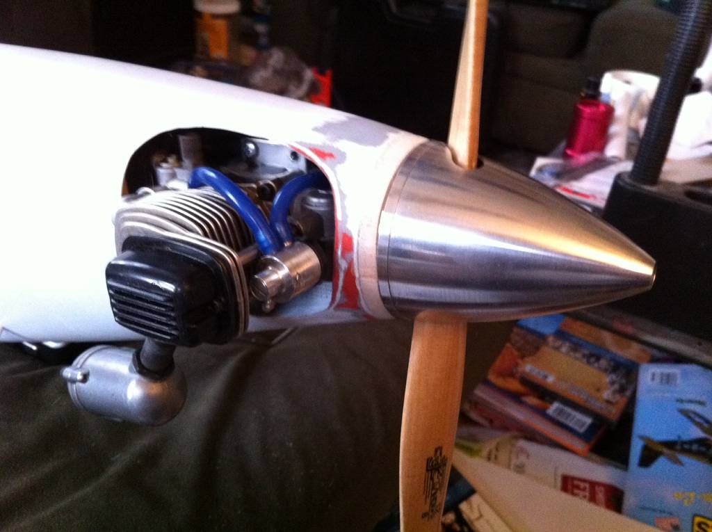

Got my spinner today. It's a Dave Brown Ultimate pointy job. I think I might actually go back to a normal spinner though as this one doesn't follow the contour of the bottom of the fuse as well as I thought it might. We will see as it goes together.
To get the spinner backplate spacing correct I had to extend the fuse 1/4 of an inch with the YS 63. My firewall was already glued in (well) so I wasn't going to risk tearing it out. Prop is a 12x8.

Amazing! I didn't think a YS 63 could pull a 60 size bipe along with authority.
David

Well honestly I have no idea how it will do but it will spin a 12x7 or 12x8 at around 11k, so it is similar to an O.S. 60FX. It just looks and sounds way cooler, lol.

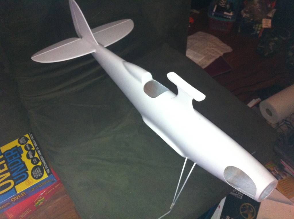

I started the fuse and began to get the tail ready.
Hope my fuse looks as nice as the other guy on here.
Still pondering engine choices.....

Tail wheel installed and fuse is cut for rudder and stab. Some color on the tail as well.
Not sure if I'm going to stick with this color and pattern.
Was bored and wanted to see how it looks.
No pinstripe yet so I'll walk past it a few times to decide if I like it.
