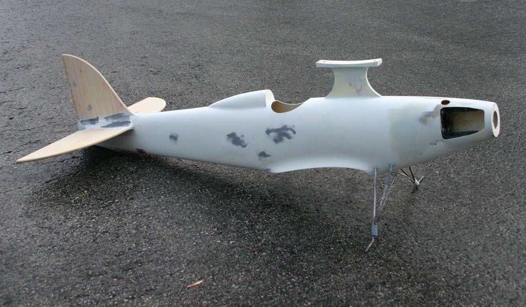

Just started a Pulsar Bipe today.
In case you don't know what a Pulsar is,
A Gel coat fuse and foam wing Pattern Bipe from the early 1970's.
They fly like on rails.
Lets hope this one does anyway............
Was wondering if anyone has interest in watching it come together?
Would love to see pics of other Pulsars if there are any around.

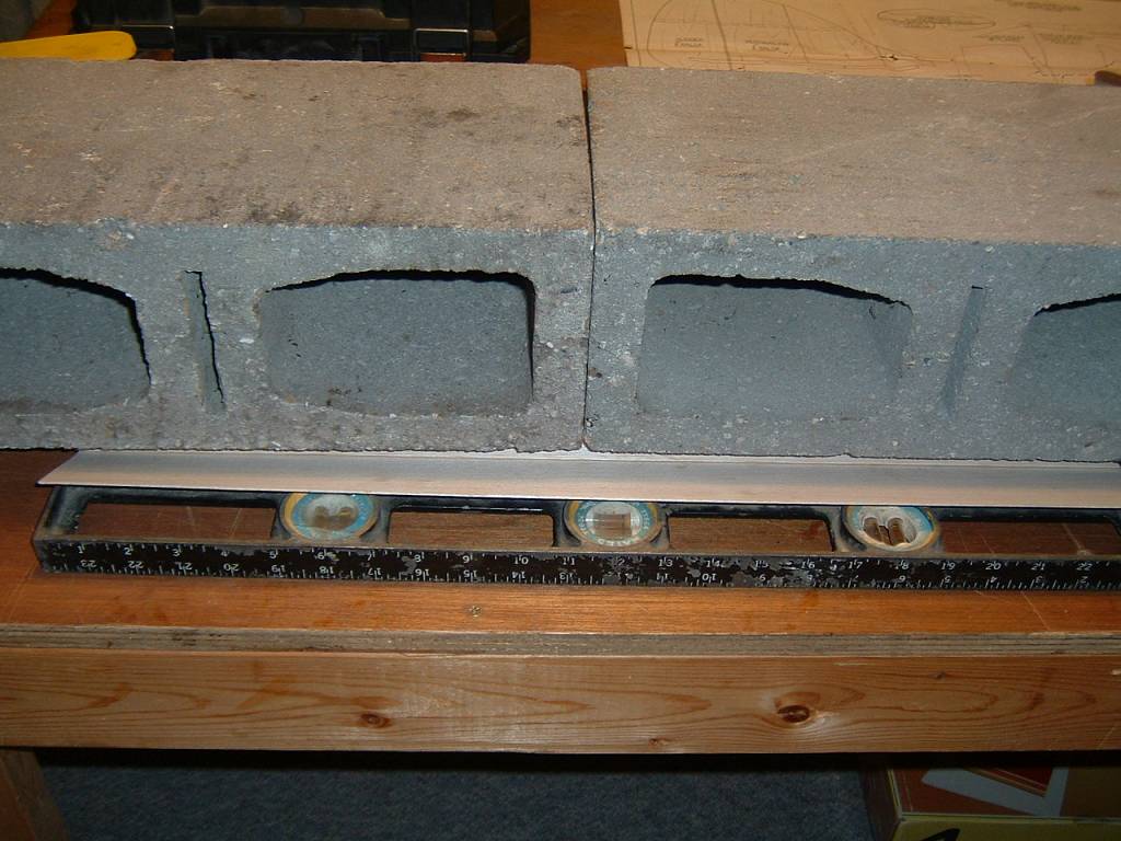

Under the blocks is the first wing panel after being sheeted.
I'll leave it there for the night and trim the edges tomorrow.
This wing panel gets sheeting around the leading edge, makes a real tight turn, and back to the trailing edges in one piece.
Would love to see some Pulsar pics if anyone has one.

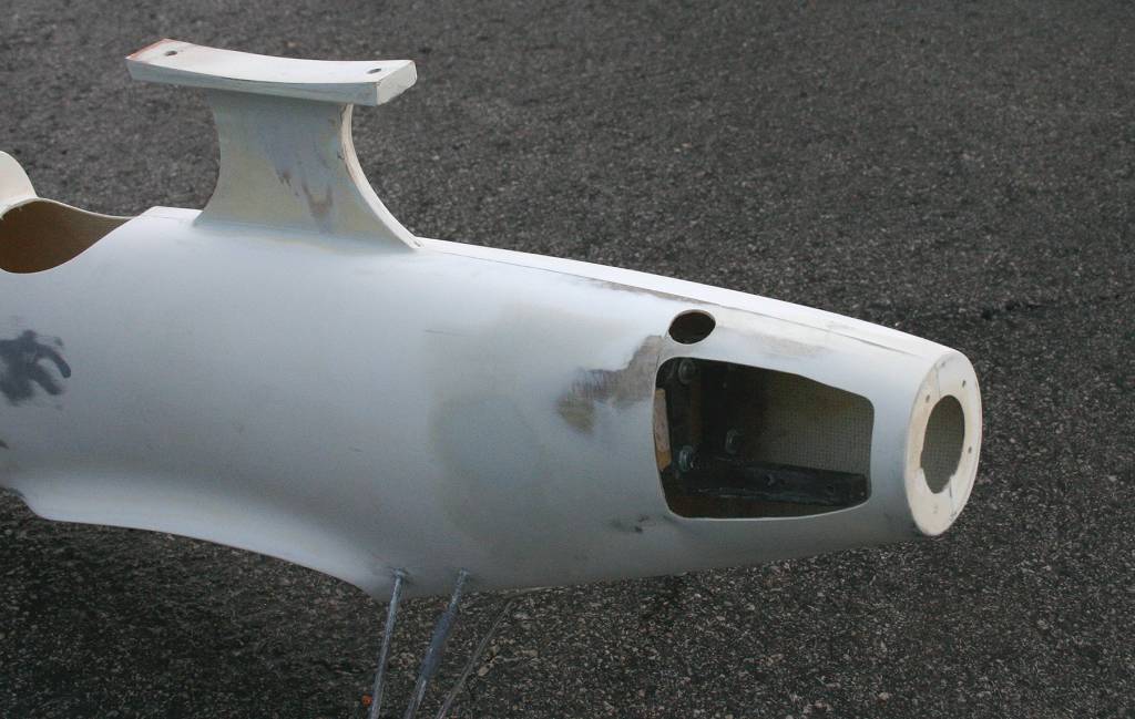

My blue and yellow Pulsar was built in 1978. Power was a K&B 61 pumper with pipe. I bought a used one here on RCU a few years ago and started to restore it. The fuselage is in progress with the glass around the nose fixed and a new firewall installed. The tail parts are new. For nostalgia reasons I am staying with K&B, but will use the twister head. It's been on the back burner for a while.
I loved the plane and will follow your progress. Jim

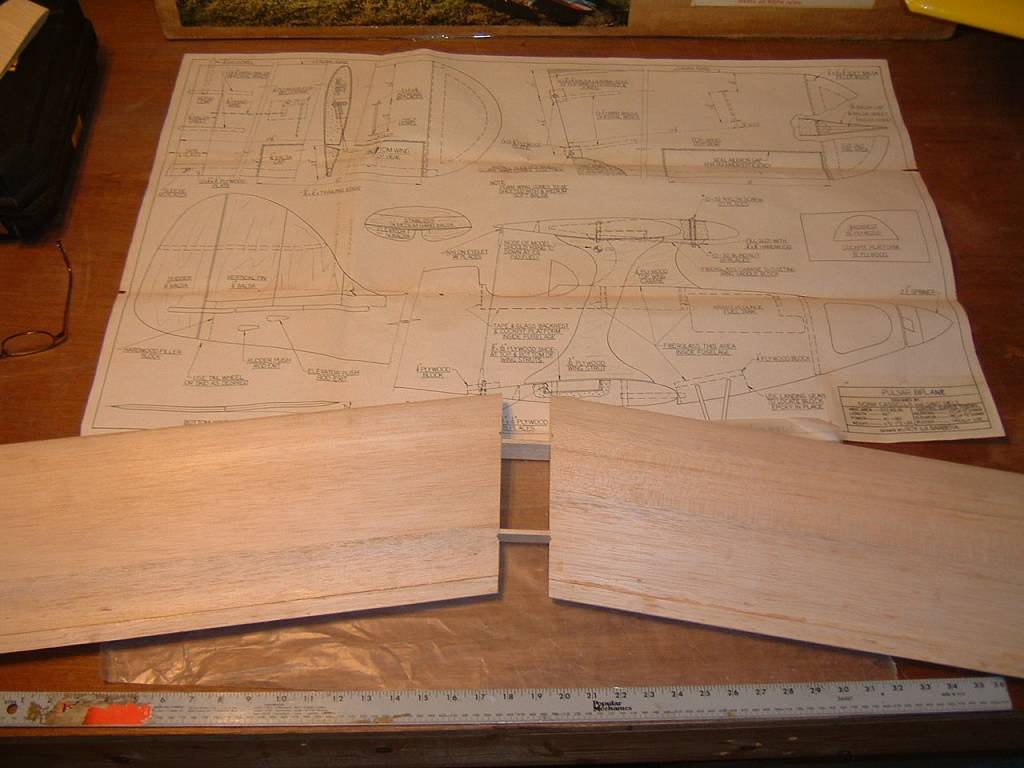

Very nice to see jjscott. Hope mine looks as good upon completion.
I got the wing panel trimmed this morning and getting ready for the next.
I started with the top wing.
It looks good despite the tight turn around the leading edge.
I'm thinking ST 60X for this one.

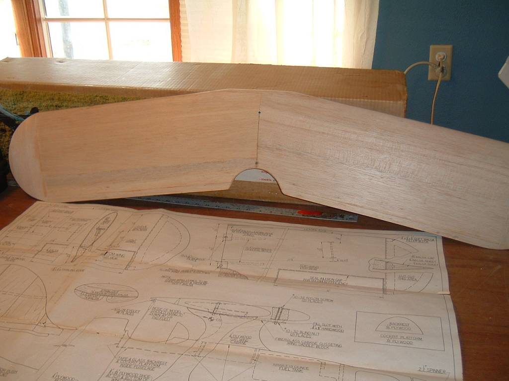

Here is the basic wing, just out of the crutches.
I'll make a pair of center braces and join it today.
Then its time to make some wing tips.
This is the top wing............

Here is the wing with center section complete.
I'll set it off to the side and start the fuse.
