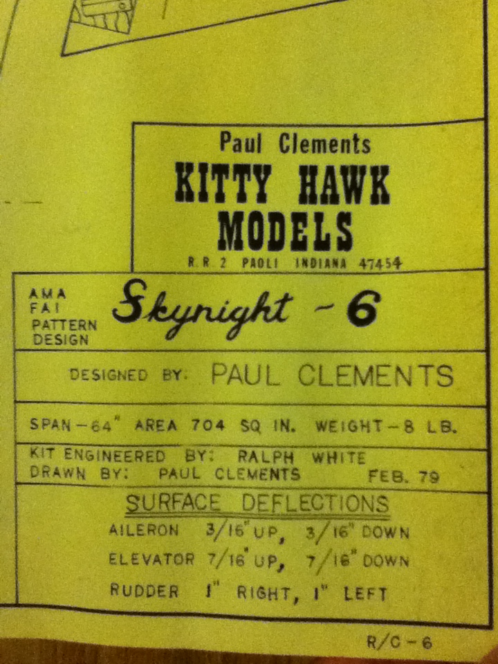

Yep, Ralph White did this kit also. Be great to hear his comments if he's following along! The plans note the dihedral is measured at the wing tips, so I believe you are correct. I'll cross reference the plans too...
The plans are dated '79. The plan notes suggest using epoxy to bond the stab, but polyester resin to fuel proof the firewall area. I think the fuse is resin, not epoxy?

Yes, my wife, Martha, and I did produce the Skynight 6 kits for Paul Clements. Unfortunately when we sold Fliteglas Models to Bob Dively around 1982 all the molds whet to him. He later sold the business to someone else. I have no idea if the molds still exist.
You are correct Daniel, the fuse is made from polyester resin not epoxy. Our resin was fairly flexible and a lot of people thought they were epoxy resin.
