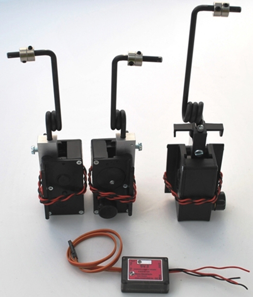

Old 05-16-2012 | 12:18 PM
bem
Joined: Feb 2009
Posts: 1,688
From: SWEDEN
Default RE: E-flite retract water proofing
Hi,
Giezendanner-Technik electric retracts has also the control board separate from the gear. These retractsare expensive but probably good and reliable (has been on market for long time).
We will see when my Marabu arrive from them where their electric EL-5 retracts (see image below)will be in use.
/Bo

Old 05-17-2012 | 05:10 AM
My Feedback: (43)
Posts: 2,297
From: Carrollton, VA
they look as big as the old Kraft gear.
