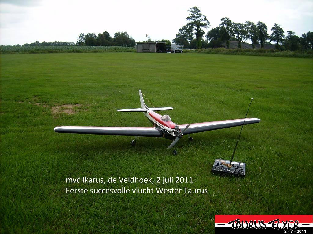

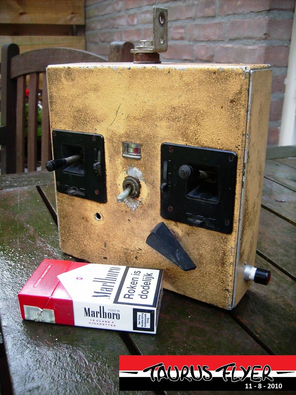

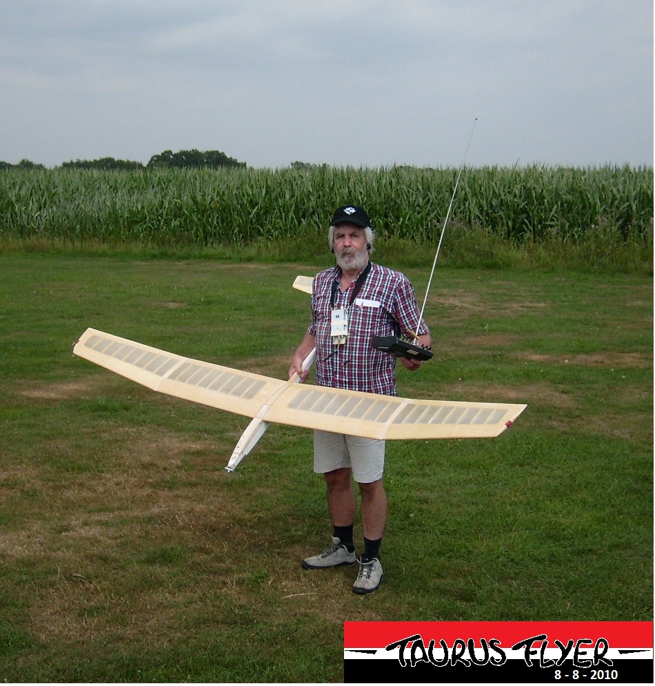

I have flown for 10 years longer the first period with scratch built radios without any problem but, about 35 years ago I did buy my Multiplex transmitter.
See the photographs, I controll all my planes with the transmitter over these 35 years, much more than on the photographs,
Is there one reason to buy another? Do I read about "brown out"?
Before my Multiplex, I did fly 26.995 MHz. color "Brown"!! Never had one single "brown out" only "brown on", see photograp 5.
(Only for my Orion I use another transmiitter, Multiplex, I received from an estate and I want to have "in the air" for memorial reasons!)
About 35 years ago I payed 1600 Dutch guilders for my new Multiplex Profi Modul; transmitter, receiver, four servos and battery's, .
This is classic RC pattern flying and that's why I have to smile about computer radio's!
Oh, maybe a good advice, mount your servos far away from the center of gravity, it must be possible to mount these in the wings for the ailerons and in the tail for elevator and rudder, vibrations will reduce the hysteresis of the friction of the linking!!!

bw it isn't "Old stuff" !
I bought my new Multiplex Profi Modul transmitter because the original encoder system of my earlier digital proportional system couldn't be extended with mixers.
Sinds I use the Multiplex, the transmitter is frequently updated with my own custom build mixers which I also needed to fly experimemtal airplanes,
These type of mixers still aren't available for "modern" computer radio's and one of these I use for rudder control instead of differential linking of the ailerons.
On the photograph the Robbe Mäxi, equiped with electrical retracts with screw spindle, 1970? , but...... separate battery for the electrical retracts.
in this plane a receiver battery of 500 mAh 4.8 VDC was enough to fly pattern.
The transmitter is the same as I showed in the other post, the retract switch is on the left side below the stick.
