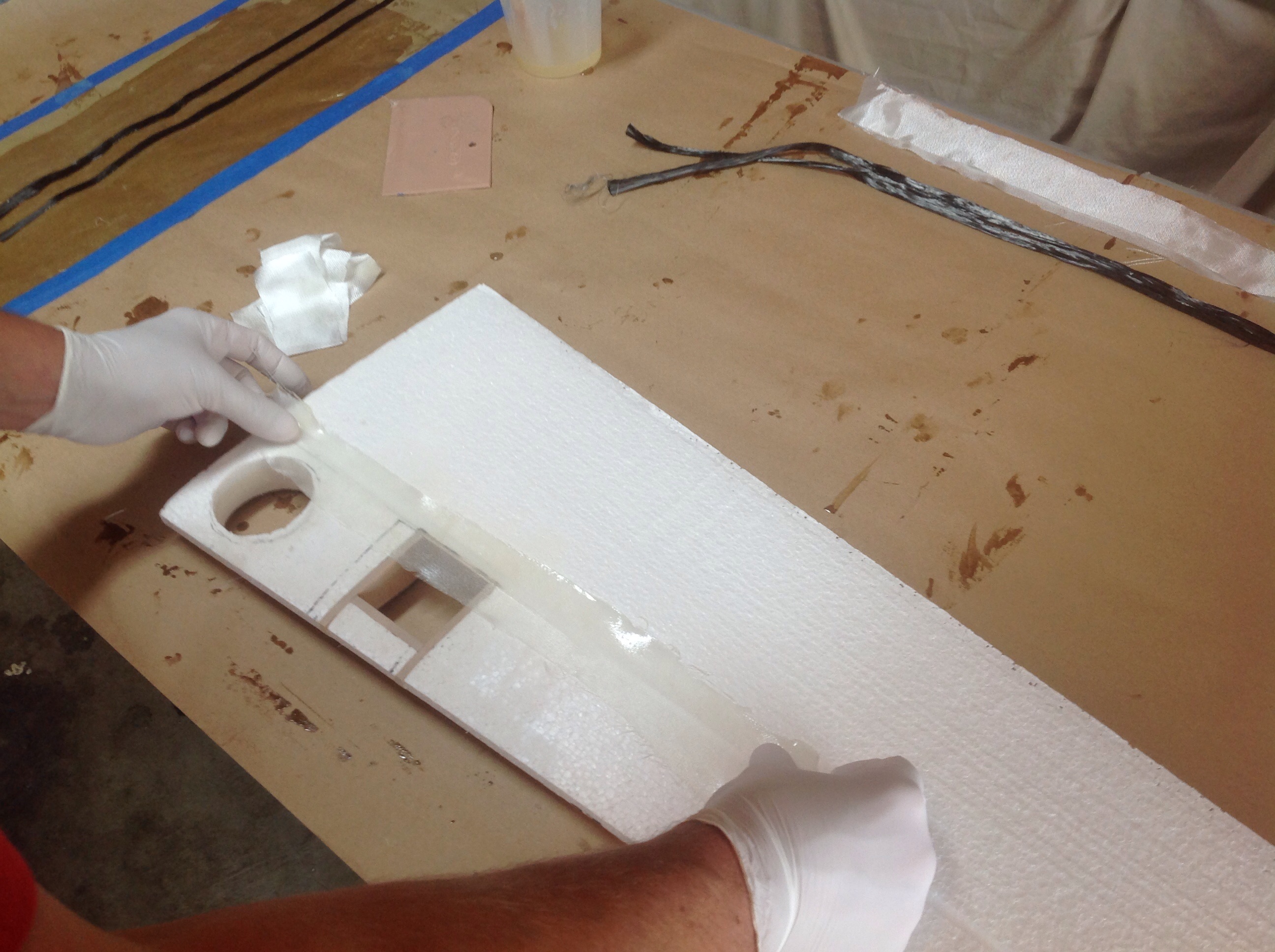

I usually make the retract cutout in the core first. Glue the retract mount plate into the core before you sheet it. I cut a groove in the core and laminate a balsa spar with carbon fiber tow. Try to extend the retract plate to the spar. Glue all of this in when you apply the sheeting and bag the whole mess. I like to build the servo mount to join the spars together at the wing seam. When you glass the center section, it will tie the load paths together.

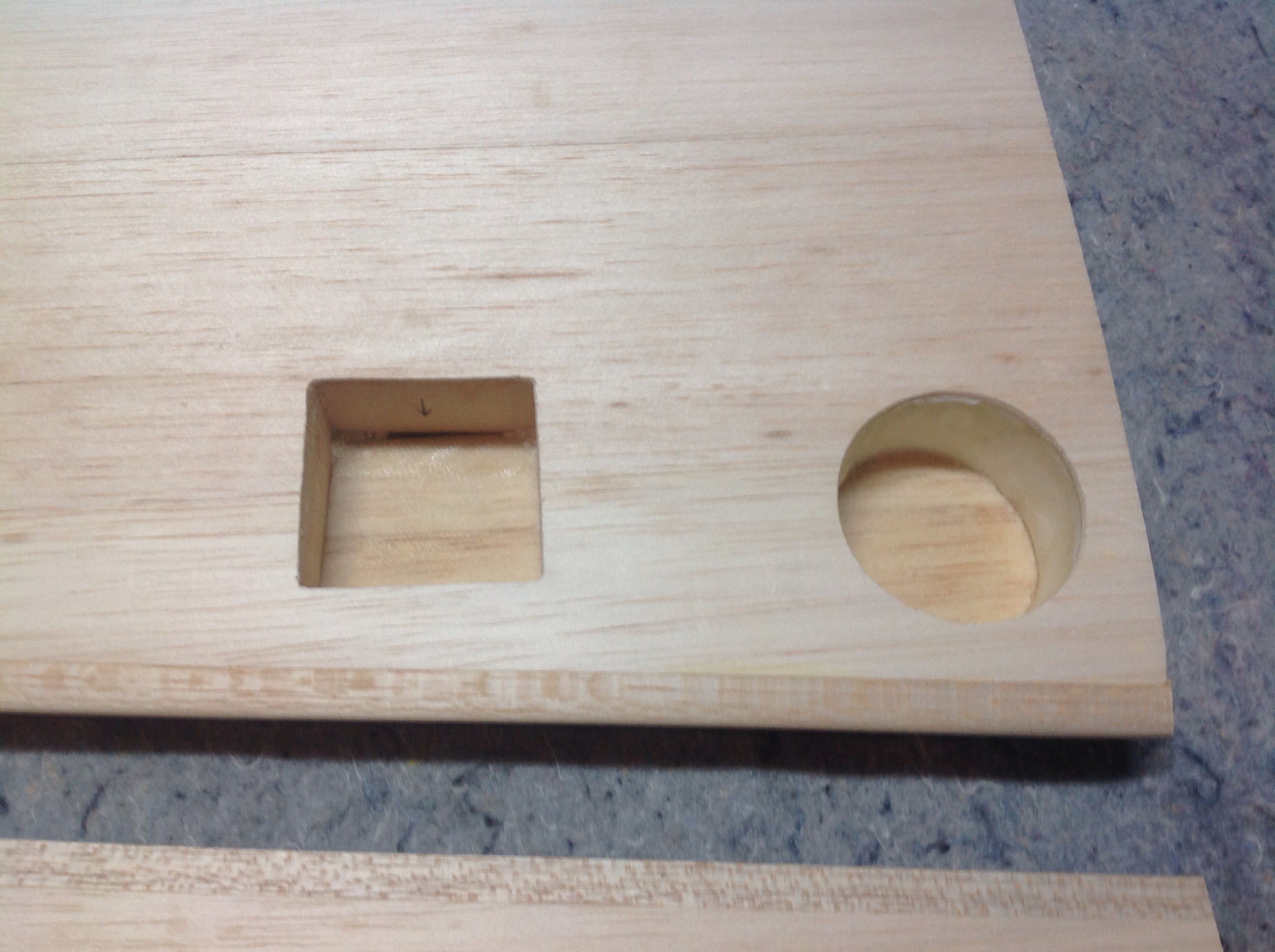

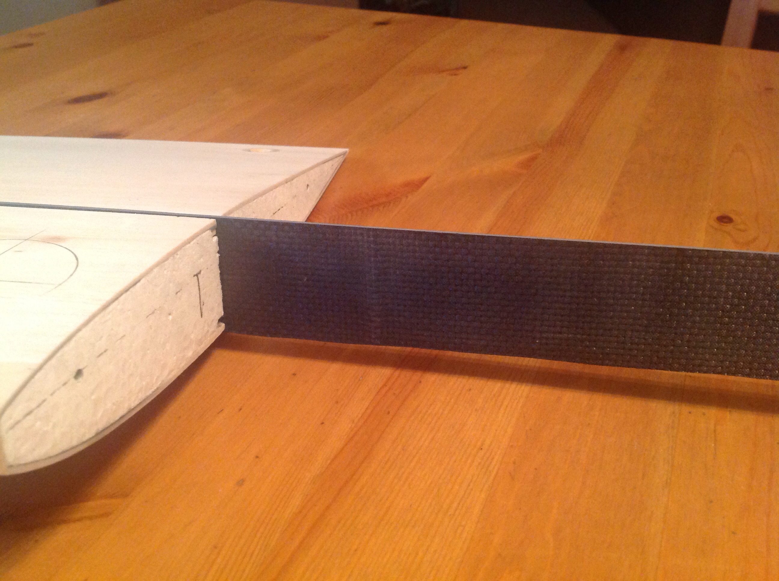

I use a hole saw to cut the wheel well then I make a verticle grained balsa box in the core. The balsa box butts up against the spar. After the core is skinned the wheel well and retract box is opened up. A ply plate is fabricated to mount the retract and installed into the box. The exterior is finished off with some balsa. When joining the wing, a vertical grained balsa/CF joiner is used and butts up to the rear edge of the spars. Pictures are worth 1000 words.
