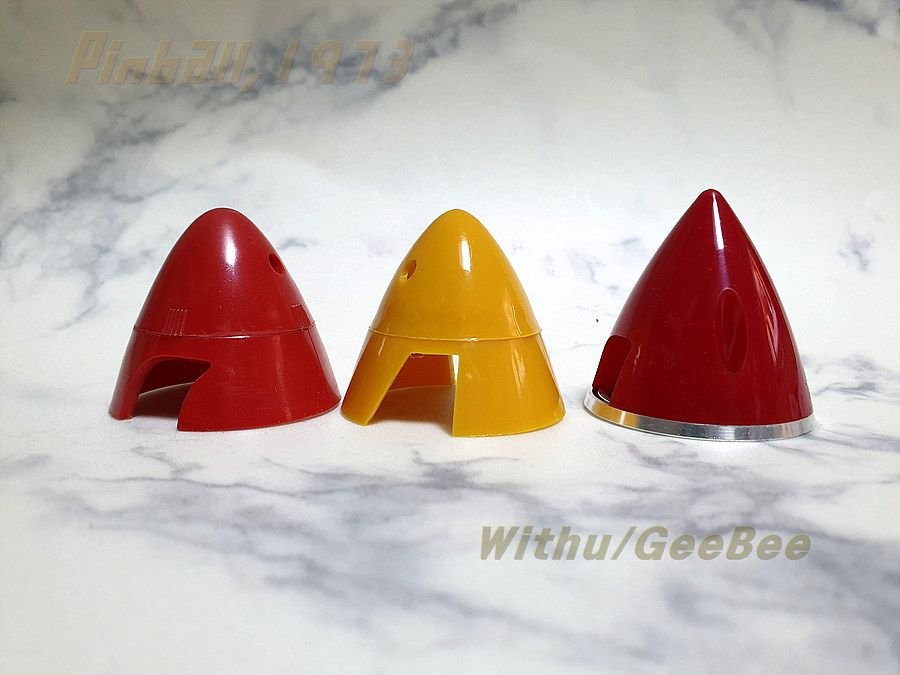

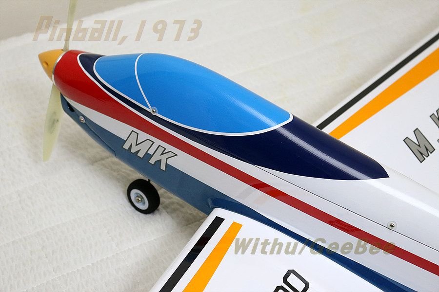

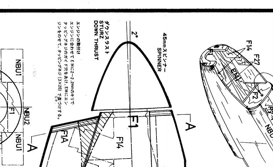

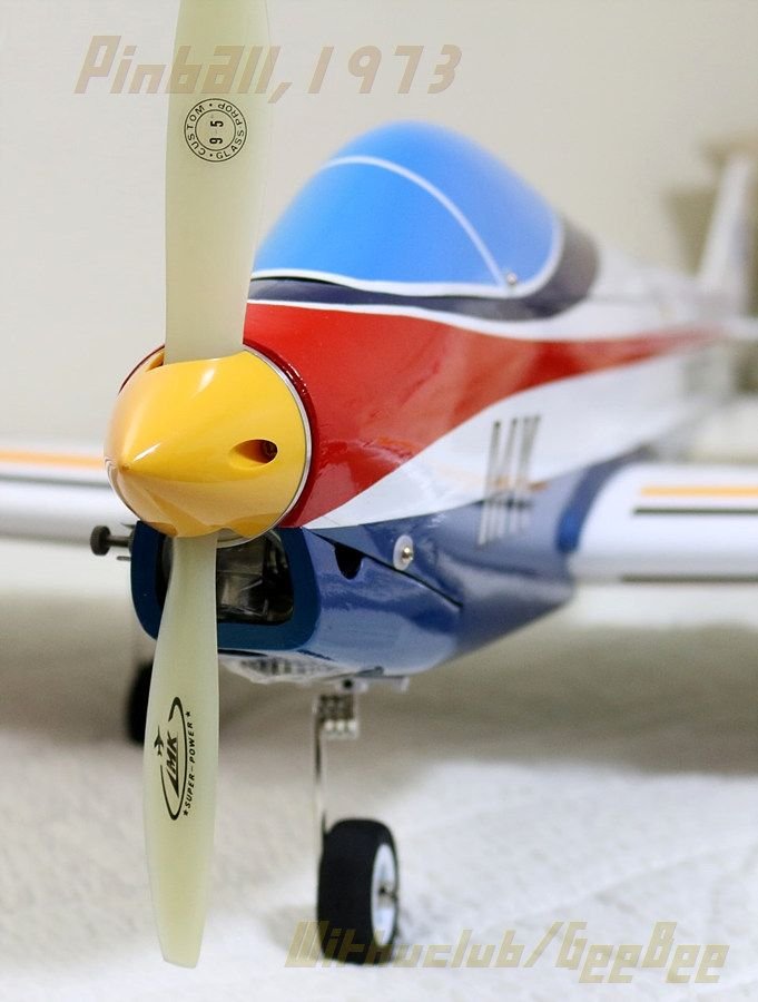

The shape of the spinner is quite important in classic RC plane.
I think it has a lot of Influence on completeness.
Spinners from the 70s and early 80s.
From the left, pony, ishipla, and modern TY-1 spinners
In this case, modern TY-1 spinners are appropriate.
And It's easy to get.

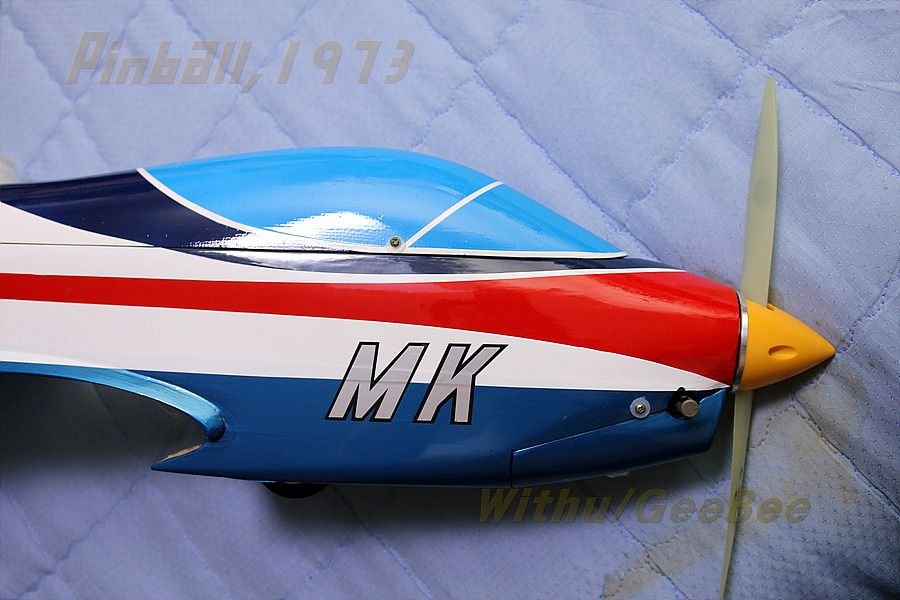

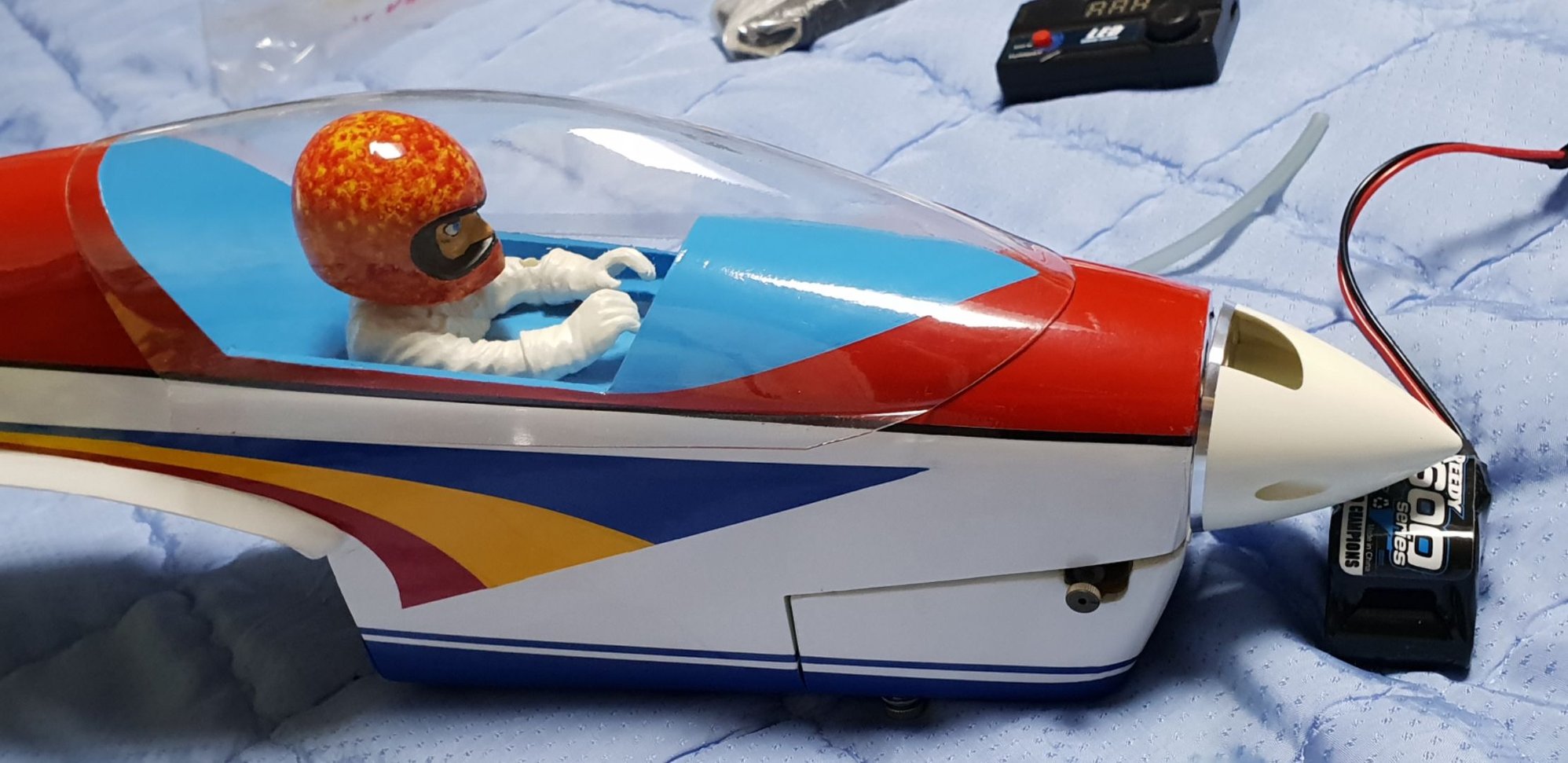

Default Fuselage logo
from a very old MK PLANE STICKER (1,200 Yen )
almost done

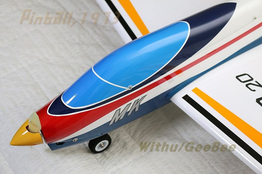

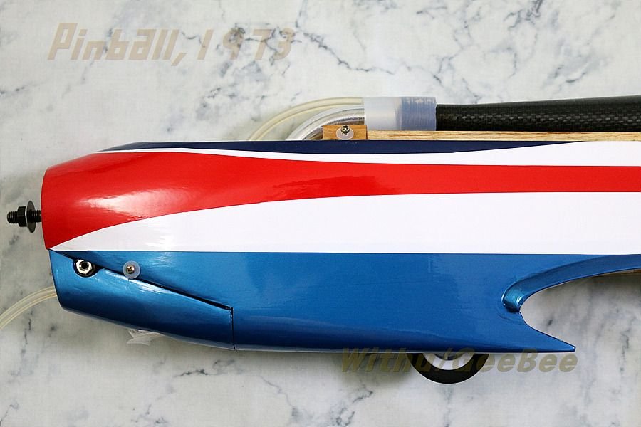

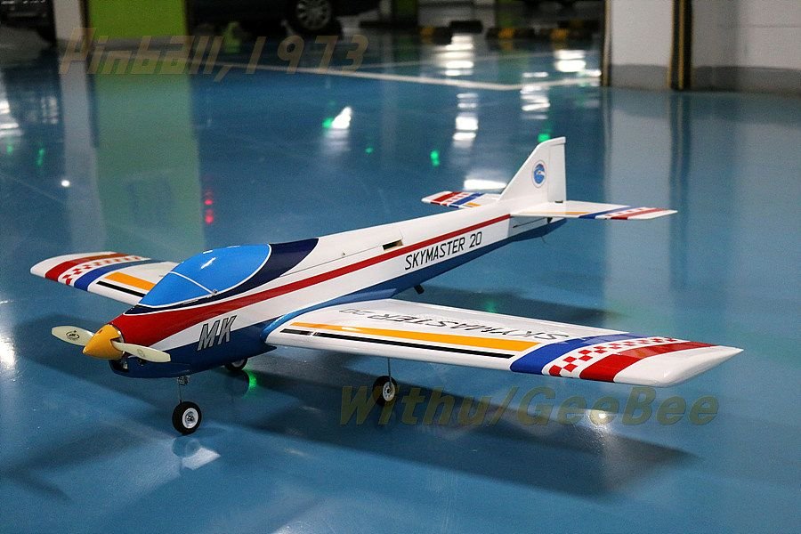

It's a really beautiful luxury little plane.
The engine and exhaust pipe are completely embedded inside the fuselage, with top turttle & undercowls.
As far as I know, it's the only kit in this 20 class.

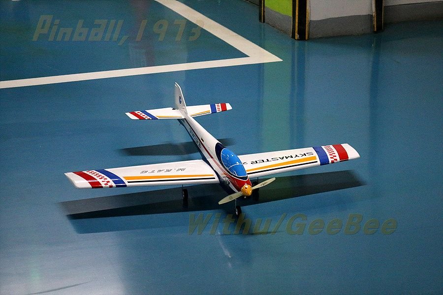

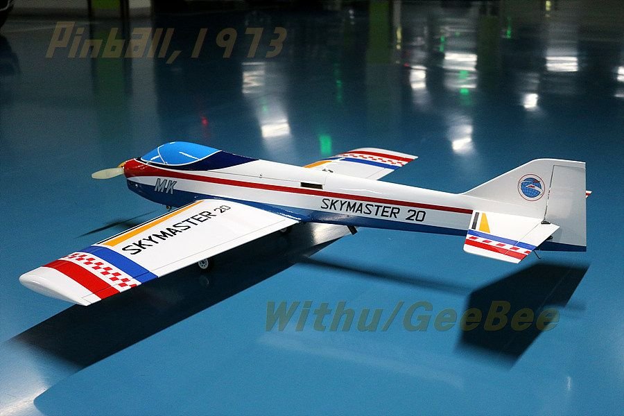

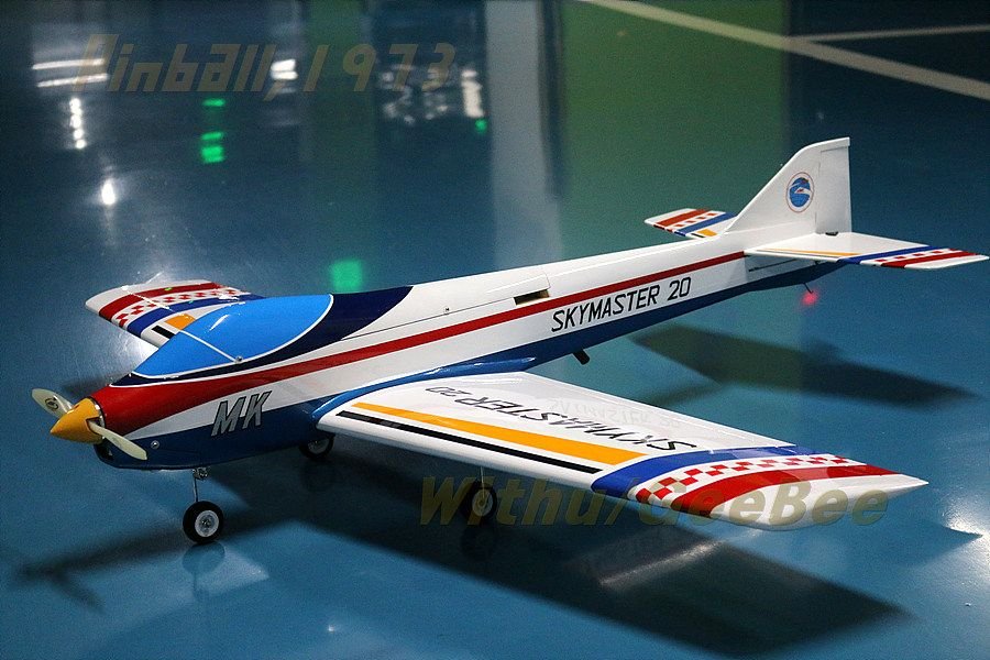

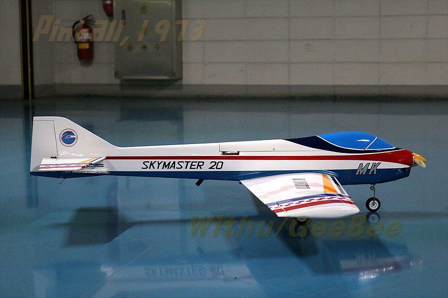

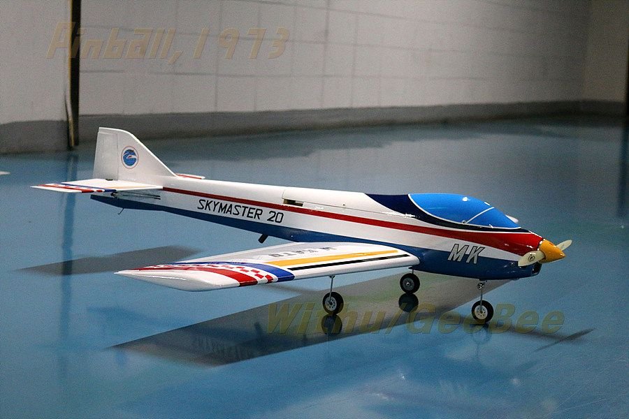

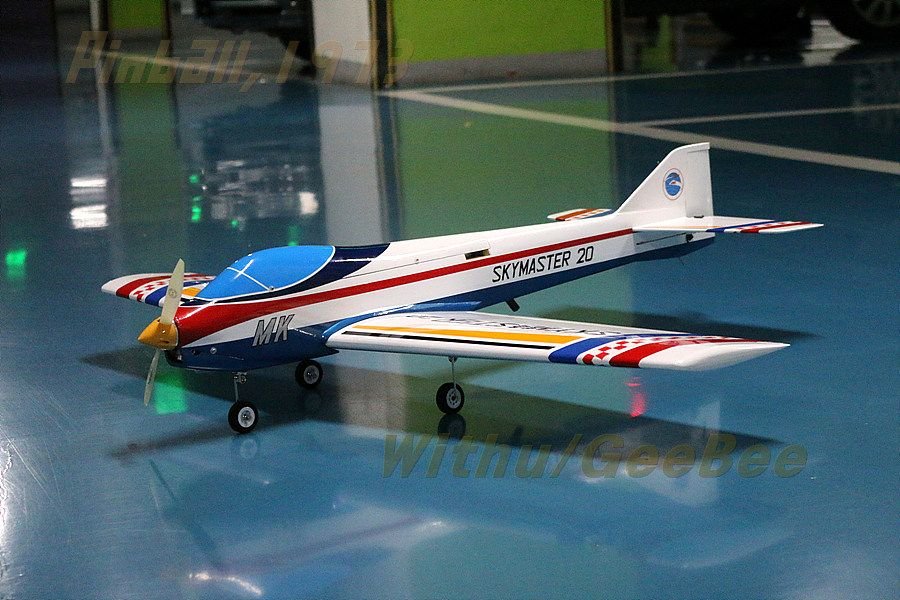

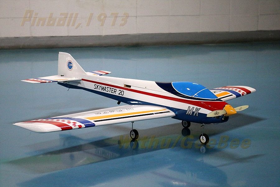

MK SKYMASTER 20
wingspan 1,200mm
length 1,103mm
engine OS 25 vf abc
Asano tunded pipe 25-32
Hatori header
servo Turnigy TGY-390V *3
HITEC HS-5070*1
fuel tank MK 150cc oval type
spinner TY-1 45mm
prop. MK 9-5
wheel MK wheel 40mm * 3
retract OK tahmazo e retract nose
e flite main retract 10-15
weight 1392g(49oz.) + JR RG712BX + 7.4V 600mah =
1450g(51oz.) without fuel
Thanks for watching!!
