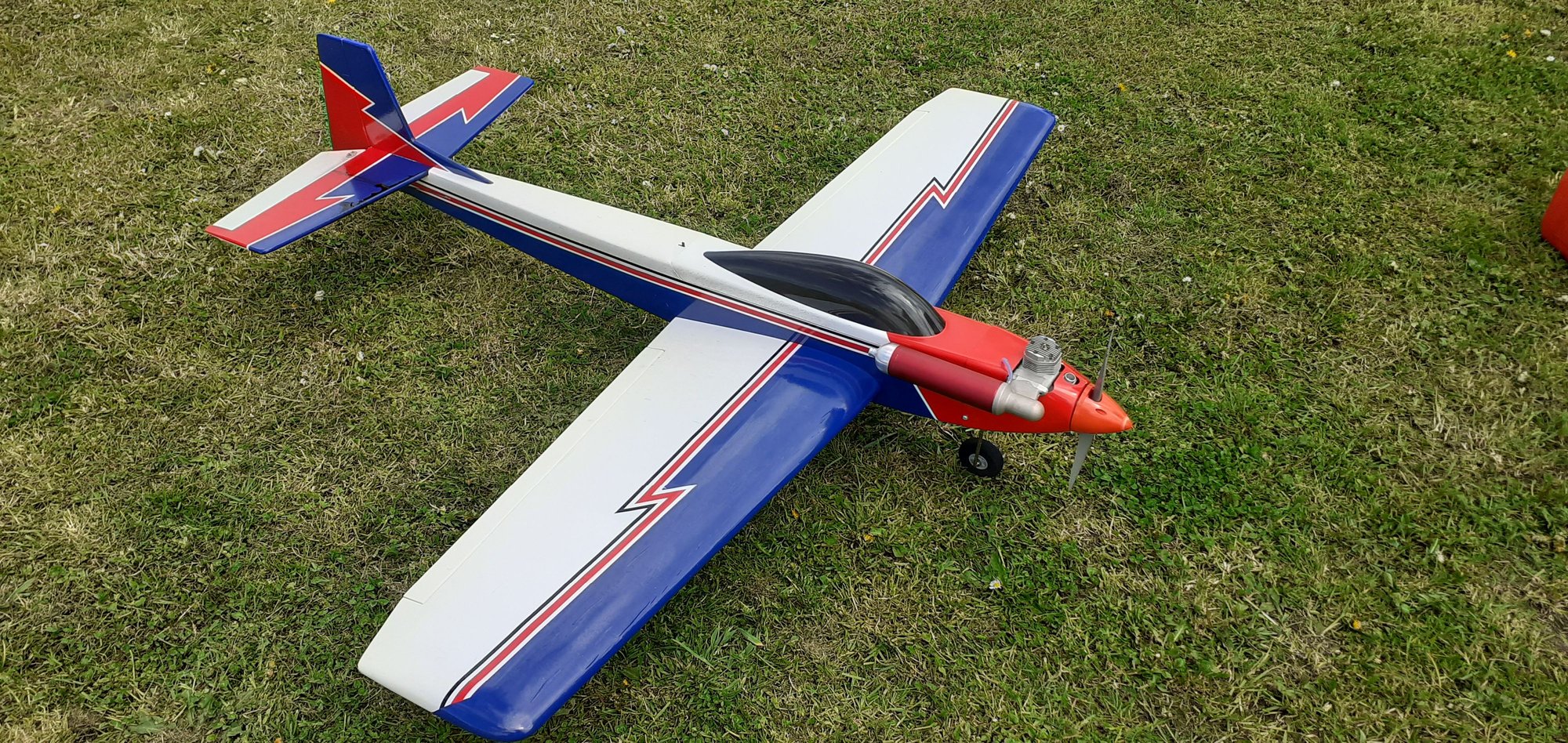

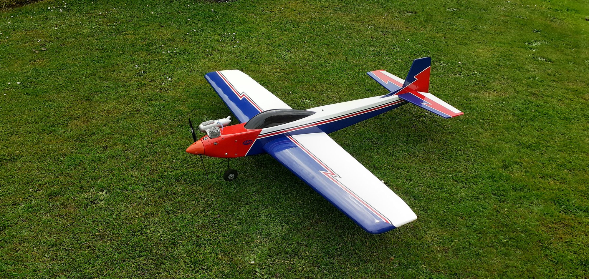

I have a Tower Hobbies Kaos 60 with a OS 65ax and would like to fit a Jett Muffler.
Can anyone tell me a good prop to use with this combination?
Any change from a #8 plug?
Is an extra head shim required?
Fuel I am using is 10% nitro 18% oil (Klotz super techniplate)
Geoff

Hi Geoff,
The Jett muffler/mini pipe has an optimum RPM range. I will suggest starting with a 12 x 7 (I prefer APC props). You might try sending an email to Dub Jett, too. He can probably give you some specific recommendations. You should not need a head shim, the OS #8 is the correct plug and the fuel mix sounds good.

Hi Will
Thanks for the reply much appreciated. Will try your suggestion after I get a few runs on the motor with the standard muffler as at present it has only had a couple of starts.
Have also ordered a s/s bearing from Boca as I believe the 65ax can have problems with bearings when running a tuned muffler.

At present I have a retrimmed Tower Hobbies Kaos 60. But am looking at a couple of options Blue Angle, UFO of Phoenix 7.
Also looking at getting an HP 61 pipe from Mecoa if the Jett muffler does not work out.
Geoff
Well i guess I have answered my own question. APC 11x7 prop with the jett muffler and 1/2" spacer block. Performance is like night and day compared to the OS muffler. Pulls through large diameter loops with out slowing and up lines are perfect now.
The jett muffler /exhaust may not be the best option for noise sensitive flying fields.
Defiantly higher noise level over the stock OS muffler.
Geoff
