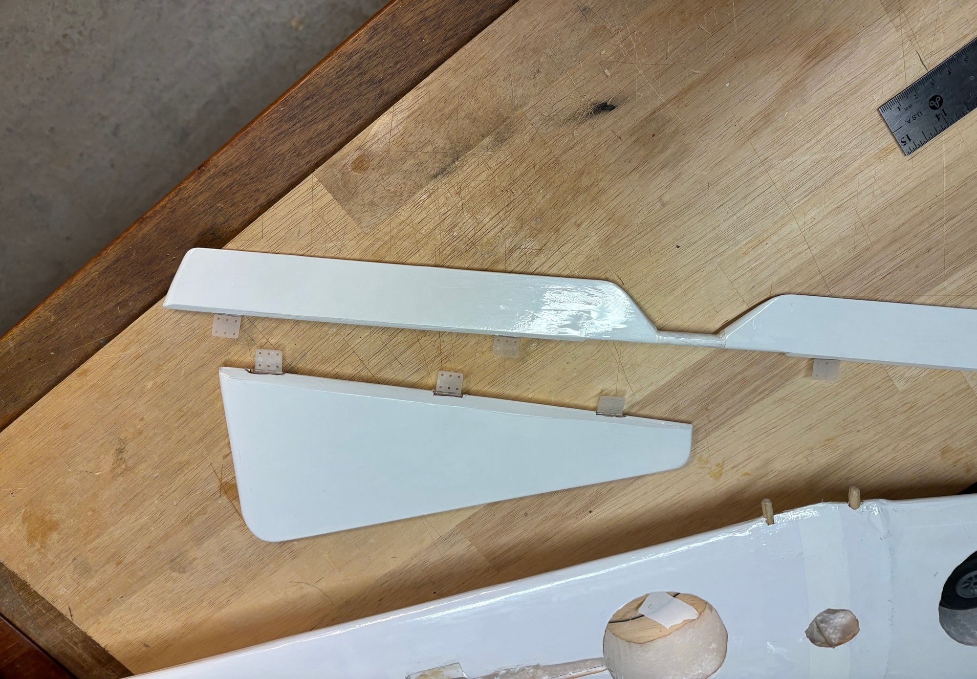

Rudder and elevators hinged, ready to attach.

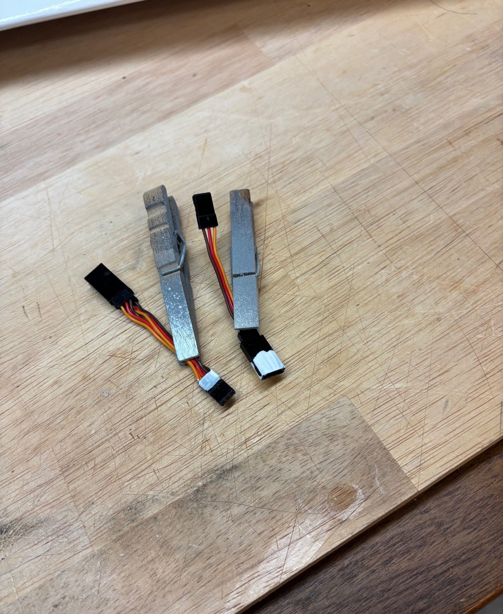

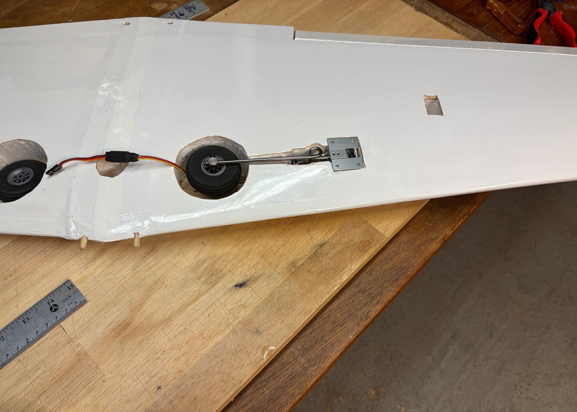

Because there will be 2 connections from the wing to the receiver, I color-coded one of them.

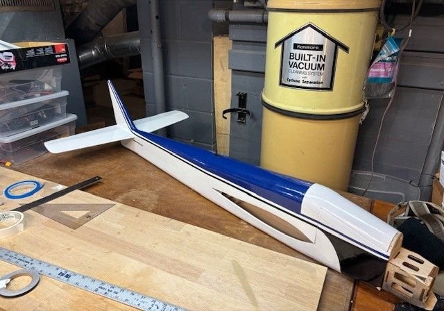

So now all the blue color and the black trim have been applied - time to start with the red stripes. Right now, the completed bare frame weighs in at 2 3/4 pounds.

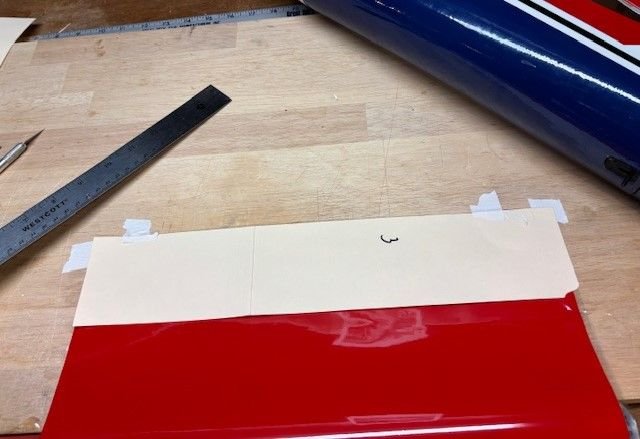

The stripes and spaces are 3", so to keep them consistant, I made a template at 2 7/8", then use 1/8" striping tape to make the edge for the next stripe.

Rather than keep measuring 3" on the monokote, I made another template. I tape the monokote, then tape the template. Next I put a steel ruler at the edge of the template, and cut. Saves a lot of measuring.

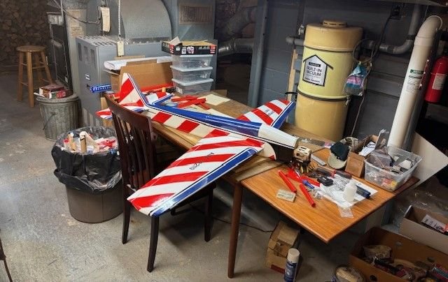

The covering is now complete. 44 red stripes that took about 15 minutes each - phew!

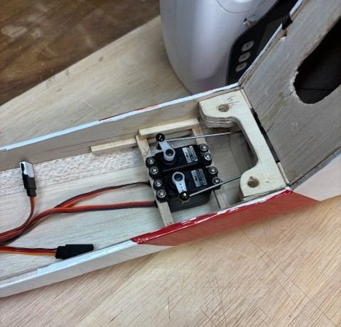

Now I can start to install the equipment. I'm going "old school" for the R & E pushrods - threaded rod married to 1/4" dowels. only difference is using medium CA instead of 5 min epoxy to coat the thread.

Hooked up the pushrods to the servos, using those brass cubes with setscrews - only problem is when I looked at the side view, those cubes stuck up into where the wing goes. *sigh* So I had to remove the servo arms and re-install the connectors upside down.

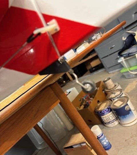

Really getting down to the final parts. Here's the free-wheeling tail wheel. I figure that with the large rudder, it will turn the plane, and the wheel will just follow.

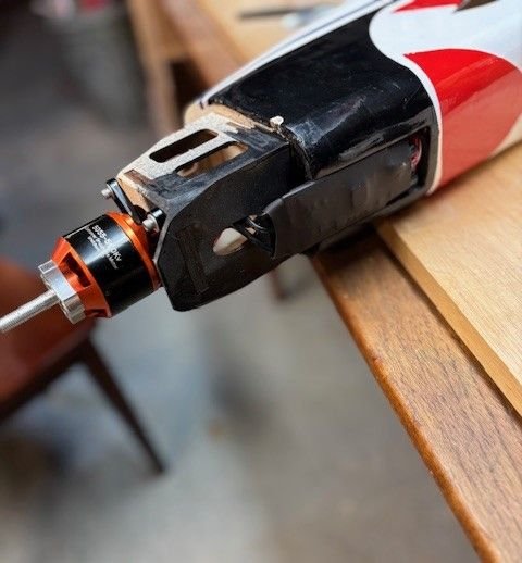

Ah, the propulsion. Motor attached, and the ESC is nestled in its pocket.

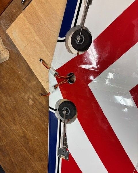

Landing gear attached as well.

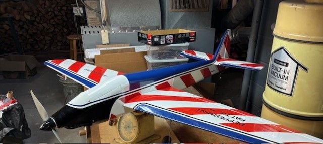

And with that, I declare the plane is finished !

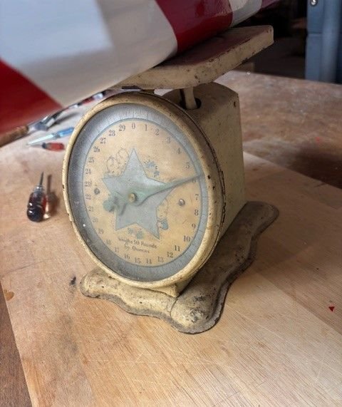

Final question - How much does it weigh? The answer, just under 6 pounds with the battery installed ! My old Patties used to weigh 7 1/2.

One last item - balance. She balanced right on target without adding any weight.
