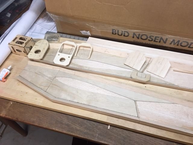

WEDJ 11-03-2023 05:06 AM
So next I cut the outline. Very important to put the stab at 0 degrees. The rudder hinge is 10 degrees.
https://cimg1.ibsrv.net/gimg/www.rcu...83f6d17926.jpg

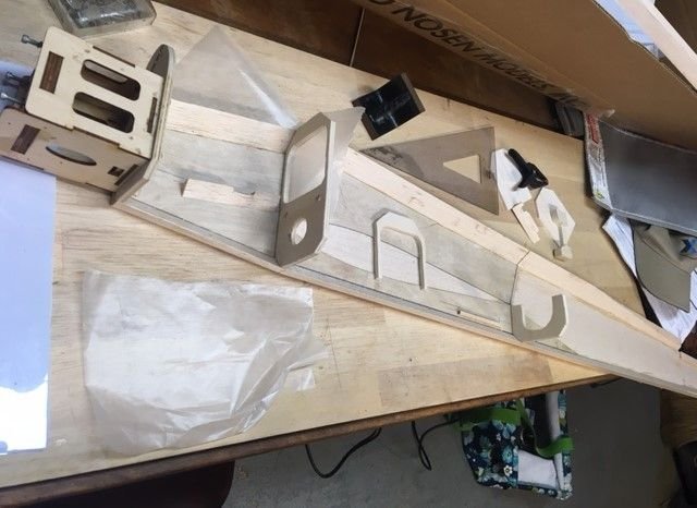

WEDJ 11-20-2023 10:26 AM
Now both fuselage haves are done, here is the firewall and motor mount. Next step is to make all the bulkheads then join the fuselage together.
https://cimg8.ibsrv.net/gimg/www.rcu...313aae967a.jpg

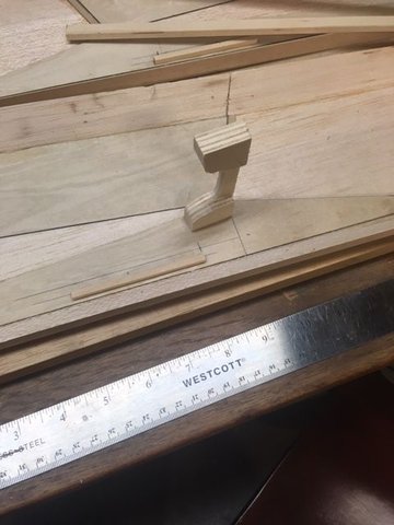

WEDJ 12-13-2023 07:36 AM
Here's a shot of the wing attachment, it will be tapped for 1/4x20 nylon screws. Also visible just above the triangular stock is the support for the servo rails.
https://cimg2.ibsrv.net/gimg/www.rcu...853bea4e85.jpg
WEDJ 01-20-2024 06:16 AM
So after a break for the holidays, I attached the three primary bulkheads: firewall, wing LE and TE. Next comes joining the two halves.
https://cimg1.ibsrv.net/gimg/www.rcu...dc81e0d08b.jpg

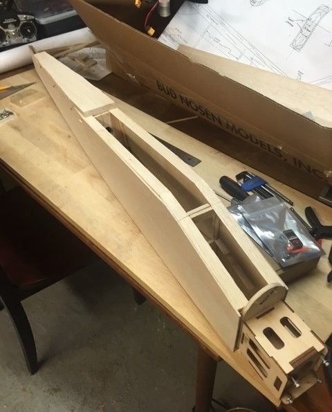

WEDJ 01-29-2024 05:39 AM
Fuselage sides joined and connected at the rear. A straight line on the bench was used to make sure it was straight. Next the 1/2" balsa to was glued on. Need to make another 1/2" piece for the removable hatch.
https://cimg5.ibsrv.net/gimg/www.rcu...d6355fecfd.jpg

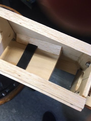

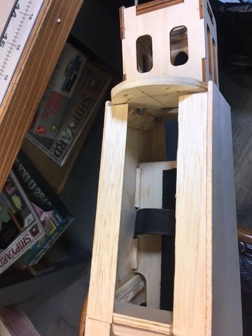

WEDJ 01-31-2024 07:24 AM
Test fit the battery on its mounting plate
https://cimg7.ibsrv.net/gimg/www.rcu...eed053f064.jpg
WEDJ 01-31-2024 07:25 AM
Installed battery plate with triangle stock. the velcro is epoxied to the plate.
https://cimg2.ibsrv.net/gimg/www.rcu...a2c9c86cec.jpg
WEDJ 01-31-2024 07:26 AM
Also put in support bracing on the other(top) side of the plate to secure it.
https://cimg5.ibsrv.net/gimg/www.rcu...42afbaac01.jpg

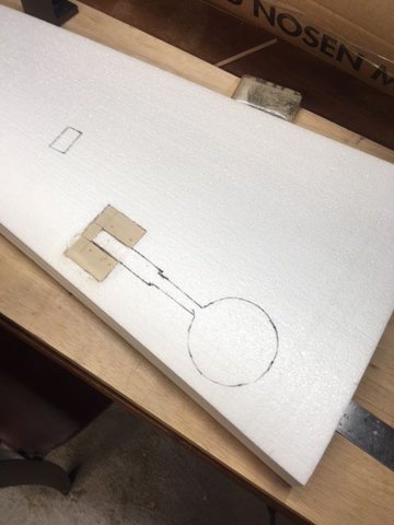

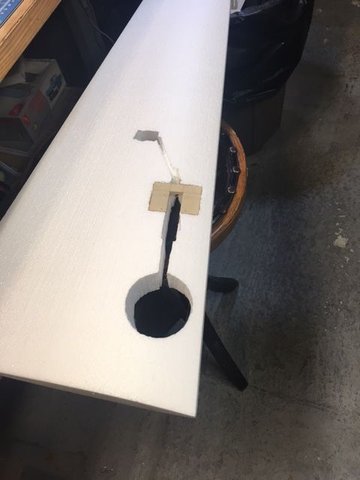

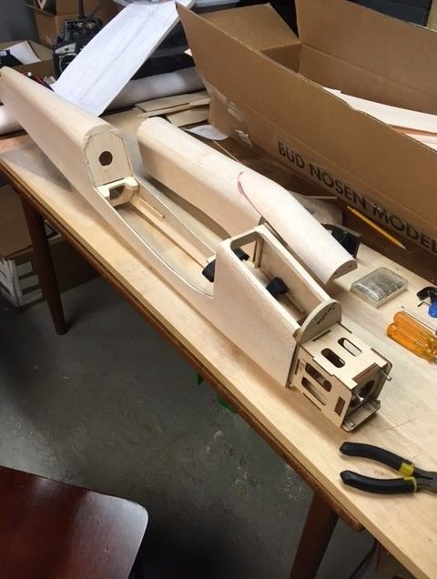

WEDJ 02-05-2024 06:15 AM
Now the rest of the top blocks have been added. Time to take out the plane, angle grinder, orbital sander, etc.
https://cimg7.ibsrv.net/gimg/www.rcu...6662f9be1c.jpg
WEDJ 02-05-2024 06:18 AM
Used a 4" blade foam cutter from Hot Wire Foam Factory to make the cutouts for retrcts and aileron servo. The tool was really easy to use.
https://cimg2.ibsrv.net/gimg/www.rcu...07e8c3a94e.jpg
WEDJ 02-07-2024 04:08 AM
So those big blocks are starting to take shape.
https://cimg6.ibsrv.net/gimg/www.rcu...be3062de20.jpg

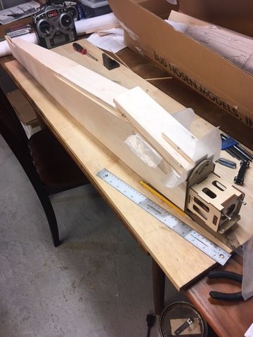

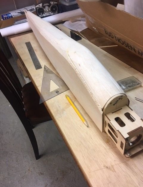

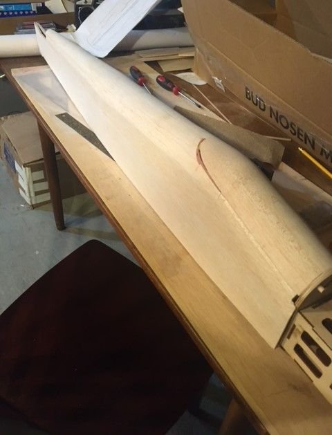

WEDJ 02-14-2024 02:07 AM
The top blocks are rough sanded to final shape with 60 grit sandpaper. Automotive putty filled a little gap.
https://cimg2.ibsrv.net/gimg/www.rcu...40568dc397.jpg
WEDJ 02-14-2024 02:09 AM
Next is a big step - cutting the access hatch free from the fuselage.
https://cimg7.ibsrv.net/gimg/www.rcu...c6b672dcb2.jpg
