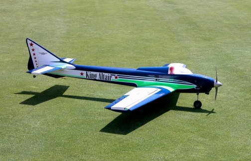

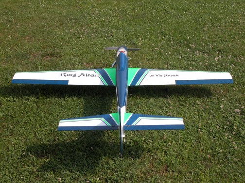

The King Altair is a big plane-especially for the time period, ('67). It flies somewhat slower than other SPA planes, (which doesn't bother me), but is somewhat challenged on verticals with an OS 91 based on its size, relatively thick wing, and higher weight. It also presents beautifully, (IMHO), and is very smooth and graceful looking in the air--has a long tail moment. I have been flying it at home with a Saito 100, and probably will use that engine in Novice class. It gives it a little extra "zing" in the verticals.
Jack Dunn, clipped the wingspan from 80" to 70" by removing wingtips, and about 2 in from each side. He also changed the shape of the vertical fin to give the rudder a vertical hinge line for knife-edge, point rolls etc. The ailerons have been changed from strip to about 18" long on each wing, and 2" wide.
I bought the plane from Rusty Miller when he got out of R/C, and before I joined SPA. I was so impressed with everything about the way the plane flew, (it may not be the perfect SPA plane for the higher class maneuvers, but where I am, it suits me perfectly), that I decided to scratch-build two of them--they are nearing completion if I can just discipline myself to keep working on them a little each day. Since I started building, I have joined SPA, and have been flying other planes to be sure to keep the K.A. in one piece, while I use the original as a reference, (there are a lot of small "engineering" changes made by Jack, and it's helpful to see how he did things).
I am making a concerted effort to remove any unnecessary weight during he building process. Because of the building project, I haven't flown the Altair this season, but I'm planning to bring it to Cullman Oct 8th.

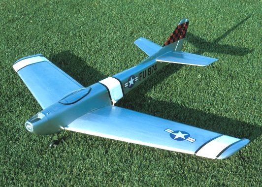

Which Phoenix is your favorite to fly? Don't know if I mentioned it elsewhere, but the first plane I built was a Phoenix 1 from RCM plans when I was about 14-15. I showed the picture to your Dad at a Detroit Invitational meet in '66, I think--he just kind of smiled at me. It was a little rough-looking, and I couldn't fly it--but who cares---it looked sooo cool with those swept wings. By the time I was experienced enough, it was too old and brittle to fly. Some day, I'm going to build another just to complete the cycle.
I've included pictures of the Altair and Phoenix

Nice photos of the kingaltair. If RCM magazine had some color photos of some newer built models, they might just sell more of the older plans. Another note, I contacted RCM about the availability of all their plans, and most have been scanned from mylar to computer file format. All are available. Wish I could say the same for MAN's. If it's not in their current plan catalog it's gone for good. What a shame.
