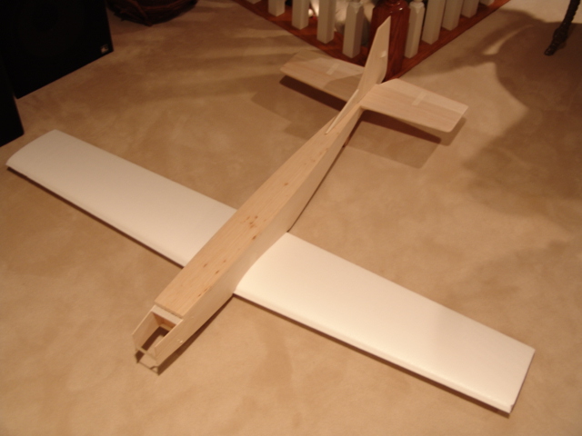

View of the fuselage with the sides glued to the top. I shaped the triangle corners on the tail section by test fitting the sides to the top and then glued the two sides together at the tail first. After the glue on the tail was set I took it apart and put epoxy on the firewall sides and the second former and Titebond on the third former. Titebond was put on the top edges and triangles on the fuselage sides and the sides reassembled on the top and taped. I placed the fuselage on the workbench upside down and put weights on it to hold it together. The scribed line on the underside of the top was used to make sure the tail point of the fuselage was centered.
View of the progress with the fuselage parts sitting on the wing cores. The nose blocks and nose ring are not installed yet. A lot of razor plane work will be done to make the top of the fuselage very rounded and flow into the rounded nose section and 2” spinner.

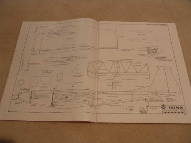

ORIGINAL: smallcirrus
I think its very cool that somebody else is a fan of the Cold Duck my father scaled that plan to take a 40 fsr in the early seventies and then in the early eighties he rescaled the plans to suit 25 size engines. I have the original prototype of it that my father built as a construction and plan article for the magazine he published, what father did was to simplify some areas of the model yet keep all the basic charm of the original scaled down to a 25 size sports model, the one I have is powered by a 25 year old OS 25 fsr and it is still a great fun aicraft to chuck around even today.The so called Mini Duck keeps nagging at me to biuld an even smaller one for electric power,perahps one day I'll get around to that as a project.
regards
Alexis
Alexis,
I’m a big fan too but I have a little biased connection with the Cold Duck. Interesting about your father rescaling it to a smaller size and I’ve met other people that have built it from the RCM plans as well. Apparently the original RCM article made it all the way down to Australia! It would be great if you could post a photo of his article and your current Mini Duck on this thread.
Some images of the original June 1971 RCM article are below.
