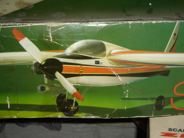

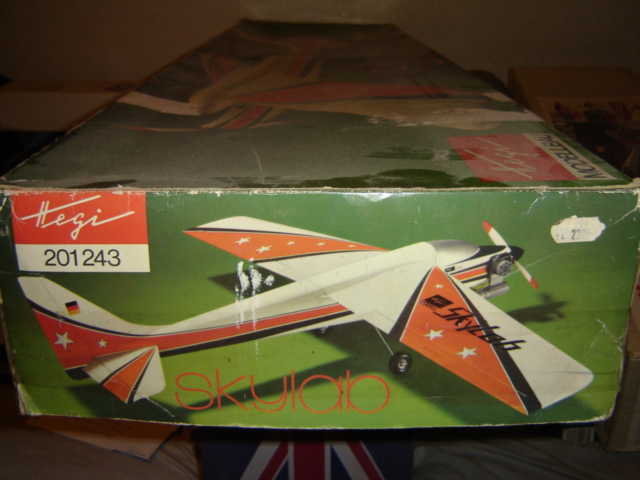

Hi Kris,
Here is a few details off the Skylab box,
"The wings have 3 degrees negative rake vee design"
Wingspan 1660 mm
Wing Profile NACA 0015

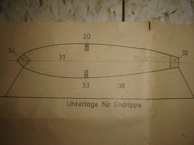

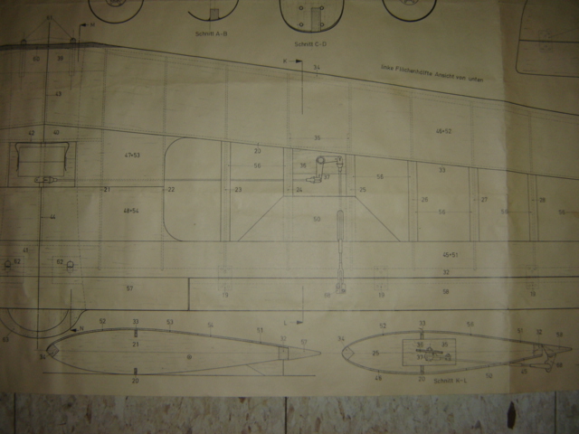

The plan only shows one wing panel and a couple inches of the other. The trailing edges are in a straight line with each other. On the plan the trailing edge is not swept back. The pictures on the box certainly look like the wing is a little swept back! The leading edge tappers 4 inches. The root chord is 12" and the tip is 8".
Shown on plan the anhedral {Unterlange fuer Endrippe} is exactly 2 cm or about 3/4 inch at the tip.
Unfortunately my kit is missing the instructions. Maybe I can get a copy from Hegi.

Hi Kris,
I think a foam wing is good. A little heavier but stronger. Would you like templates of the root rib, tip rib and wing tip? This would help you make an exact copy of the wing. PM your address and I will mail them to you!

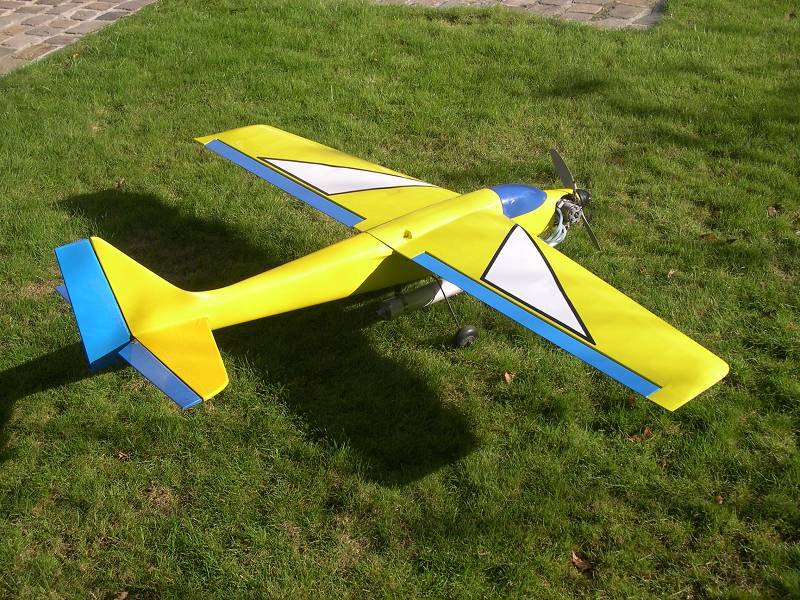

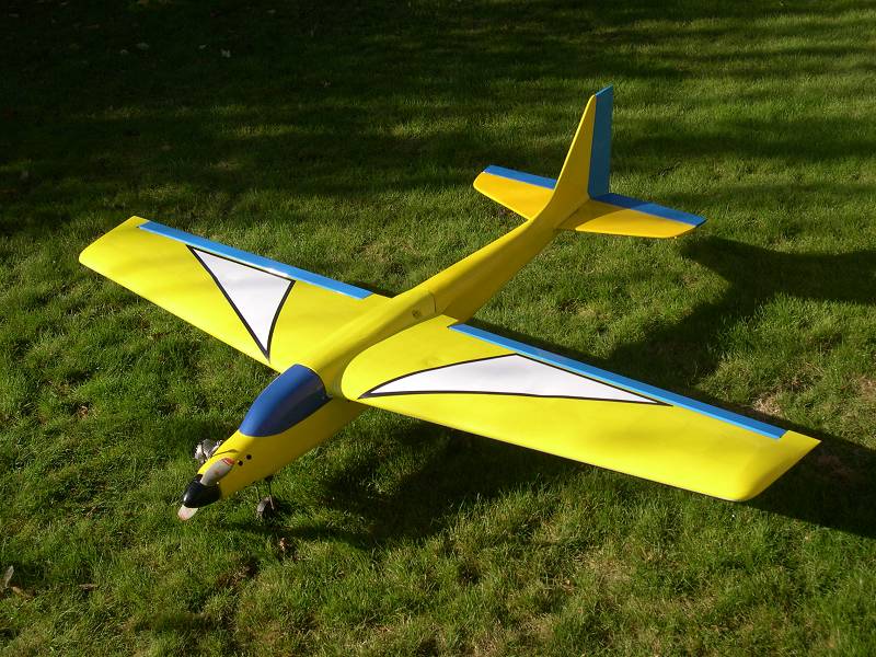

Well, the Skylab is finally ready for its new maidenflight. Hope the weather will be clearing up soon, and the engine will behave well. I tried to start it up to adjust it, and it was a bit balky. Webra .61 speed with Dynamix carb, Robbe 11x7.5 prop, methanol/carbulin oil mix ( 16% oil).
Total weight ( no fuel) 3200 grams.
Thanks again to Mike who helped me out with the wing templates.
Kris
Kris
