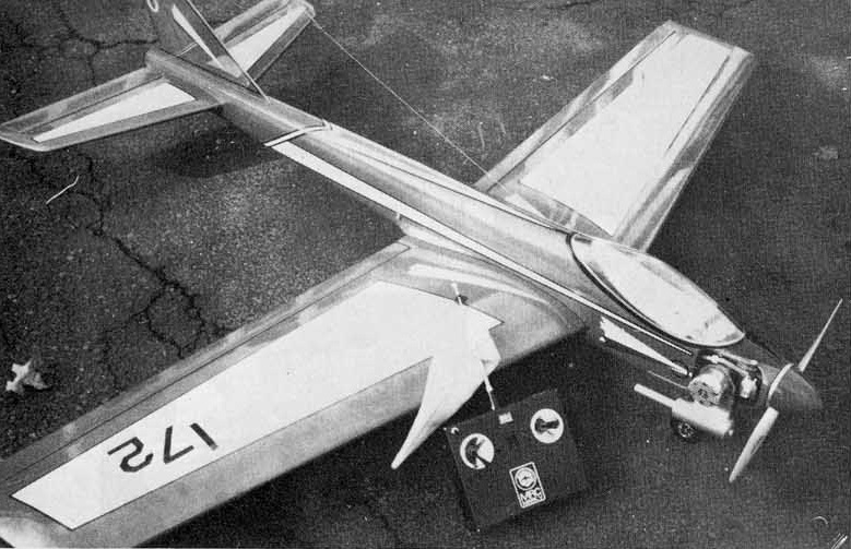

Kato continued to develop the design with a second variant that had the wing sweep reduced, larger wing area, thicker airfoil and shorter nose moment. The thick airfoil did not work well because it slowed the speed of the aircraft too much so a new wing was designed with a thinner airfoil. The new wing also reduced the overall aircraft weight. Note that it still has wing fences. See image below.

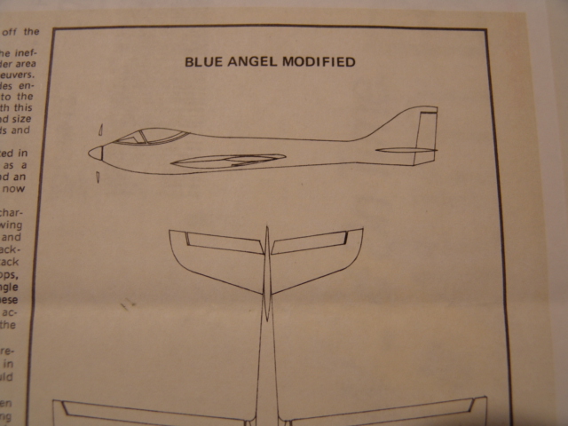

Enter Mr. Yoshioka! Yoshioka buys a Blue Angel kit but believes it would perform better with an improved ruder design that goes all the way to the bottom of the fuselage and making the tail of the fuselage narrower to match up with the rudder. See post 1133 above for the American Aircraft Modeler (page 31) for more detail on the changes.
This variant is called the Blue Angel Modified and with it Yoshioka wins the 1973 world championship. Ironically, Yoshioka beats Kato in the competition with his own but modified design.

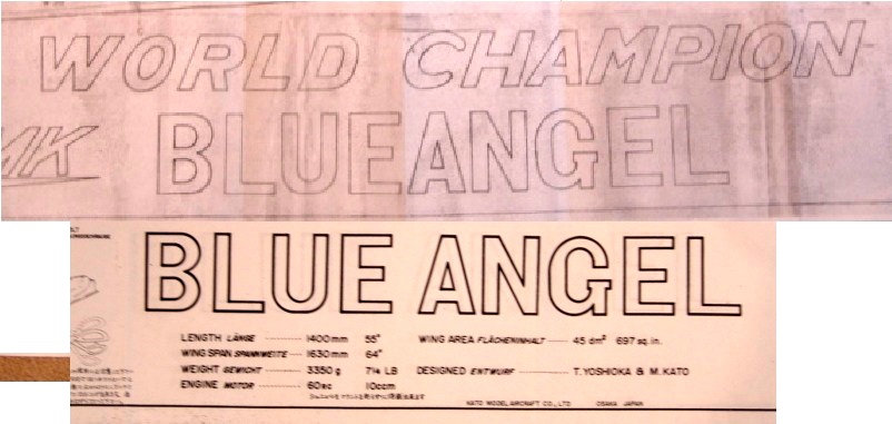

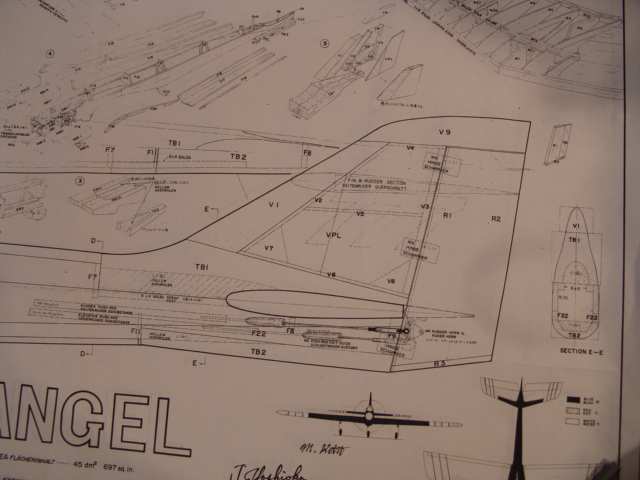

The most notable difference you see first between the "Sound-barrier" (early) plans and the “grotto2” (late) plans is the name on them. The early plans are titled WORLD CHAMPION BLUEANGEL and the late just BLUE ANGEL. Odd that there is no space between the name BLUEANGEL.
ID:	1434894   Click image for larger version

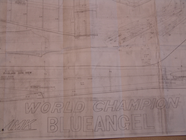

8178,
BLUE ANGEL characters are the same.
WORLD CHAMPION probably later added on the plans after Yoshioka became world champion with that plane.
The characters of WORLD CHAMPION are not so nice, see the -O- and -C- so I think a different draftsman
Later plans they did use the same characters (sjabloon/template) for BLUE ANGEL
Cees

ORIGINAL: Taurus Flyer
8178,
Cees
Could be but they are not located in the same area on the plan sheets.
Old 05-12-2010 | 12:33 PM
  #1190
Taurus Flyer's Avatar
Joined: Jan 2004
Posts: 2,408
From: Almelo, NETHERLANDS
Default RE: Blue Angel - Build
8178
Each template of a character you use separate. Even the B, O, A, R, D etc are difficult to make because you have to use two positions to construct one character.
You see the characters of the two BLUE ANGEL names are al the same for example look to the -G-.
Of WORLD CHAMPION there are a lot of shortcomings visible, parallelism, distances, so other draftsman or he did it on monday.
Very interesting to look for a second check!!!!!
Do the characters have the same dimensions?
Cees

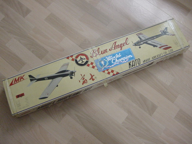

.... my Blue Angel kit then seems to be the early one, too - it always made me wonder that the carton box had 2 different airplanes pictured on its top lid, the Blue Angel and the Fuji.
The Fuji kit is packed into the same carton, but missing the blue "World Champion" Sticker....
ID:	1435001   Click image for larger version
ID:	1435002   Click image for larger version

Gents,
Look WORLD CHAMPION designed by:
Mr. Kato and Mr.Yoshioka
We see the names also on the other drawings, but this is the oldest one I think, and maybe kitted "world champions design".
Edit, second picture: This proves I think Mr Kato and Mr Yoshioka did cooperate after Mr Yoshioka became champion.
Cees
The Fuji kit is packed into the same carton, but missing the blue ''World Champion'' Sticker....
Wow! A real Blue Angel kit, very nice!
I’ve seen that box type before and it is odd that they had the first kit variant and the Blue Angel Modified on the same box top. And it is odd that Blue Angel Modified is not in Blue Angel colors.
We see the names also on the other drawings, but this is the oldest one, and maybe ''world champions design''.
Cees
Yes, the names are on both plans.

On the left is the early Blue Angel tail assembly and on the right the late. The early Blue Angel uses slabs of balsa for a vertical stab and uses only small blocks of balsa beside the stab base to fair into the fuselage. This makes more of abrupt change between the fuselage and the stab compared the late that uses a large hollow balsa block that makes a smooth molded like transition from the fuselage to the hollow built-up stab base. The built-up vertical stab on the late is much thicker. From the top view the early fuselage sides flow directly into the leading edge of the rudder making the fuselage narrow. On the late the fuselage is wider than the front of the rudder by about 1/8” on both sides. So the back of the fuselage is a least ¼" wider. The base of the early vertical stab is about 3/8" and the base of the late is about 1”. The rudder on the early is taller and the stab cap shorter. The lower part of the fuselage on the very back is not a carved block like the late.
The drawing error on the late plans where they have the rudder pushrod connected to the rudder in the wrong place causing interference with the elevator is not present on the early plan.

For me it is logical the BA kits we see "all over the world" after Mr. Yoshioka became champion, or not?
So the plan with WORLDCHAMPION is the oldest one and maybe of the kit Mr. Yoshioka did use in the first place to build his own plane for the world championships?
This plan, edited with the modifications and "WORLDCHAMPION" we see with the names of both Mr. Kato and Mr. Yoshioka.
Can that be true?
Or easy question? Is there any date on the plans?
