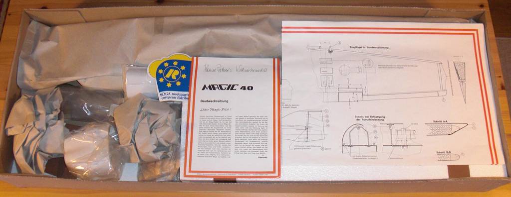

Hendrik du Preez,
Is it a Rögamodell Magic 40 You have? If Yes, then I have building instruction and "plan" if you want a copy of it. All text in German language in building instruction and on the plan.
/Bo

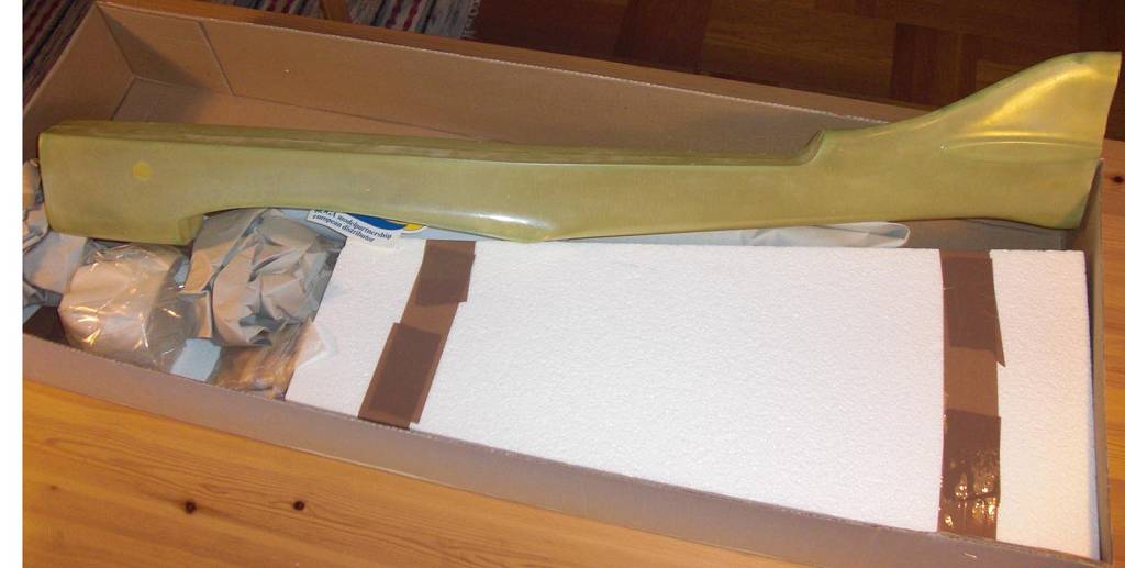

David,
R&ouml;gamodell Magic 40 (and I'm sure Magic 60 also) has epoxy fuselage and epoxy top deck. The cowl is ABS that is meant to be reinforced with some layer of epoxy+weave inside for extra strength - would be easy to make an allepoxy cowl with the ABS cowl as mould. There is also an ABS part to cover underside wing at fuselage.
It is not mentioned any special make and model of .40 engine (on box it say only "Motor 6,5 ccm"). In the building instruction it is mentioned two part numbers to R&ouml;gamodellcatalog for exhaust bend, one for engine with side exhaust (part no 01 4009) and another for rear exhaust (part no 01 4008). Hanno Prettner had in his Magic 60 a Super Tigre X 61 TST RE RC with Super Tigre pipe. Super Tigre had also at this time, 1982, an X 40 RE RC with pipe so I guess that could have been used. But probably R&ouml;gamodell had some prefered engine make and model for their Magic 40. But I have not any R&ouml;gamodell catalog from that time so I do not know.
Your OS40 VF: Is it not a ducted fan engine? Maybe little to high rpm engine for this pattern plane? (remember Hanno Prettner was using a Kato variable pitch prop on his Magic 60 and wanted low RPM - about 12 000).
YS 45FR: If it is side exhaust that is probably one disadvantage since rear exhaust engine on a Magic (40 or 60) would be better, to geta straight exhaust line and not need to have a sligtly turned clockwise (seen from front)engine. There is a picture in R&ouml;gamodell building instruction about side exhaust engine mounting.

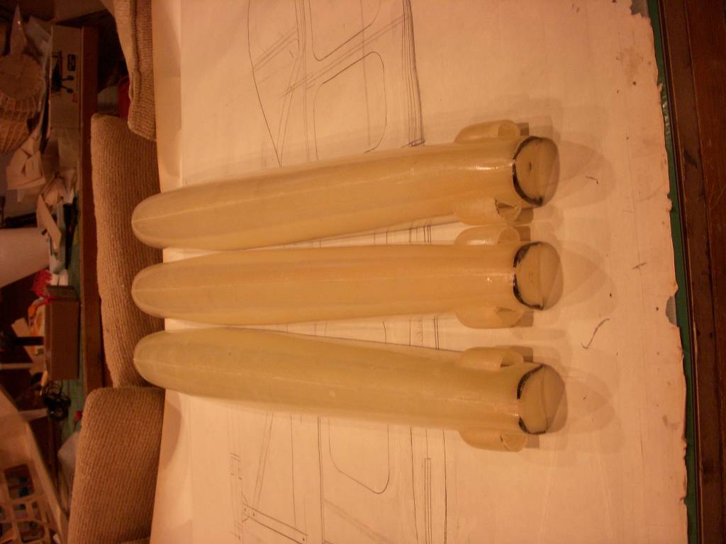

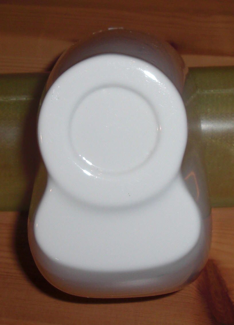

I make the Fiberglass Turtle deck for the Magic 60 if you need one.

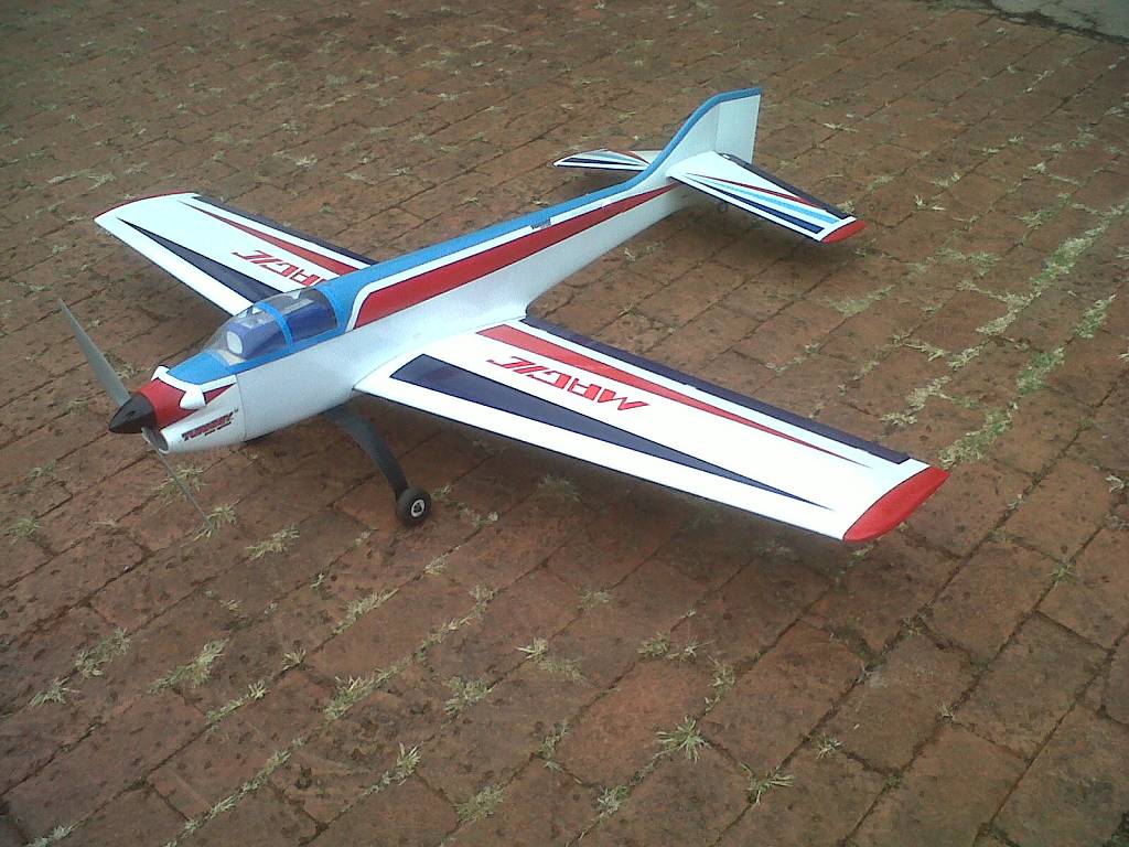

Good afternoon fellow Magic lovers
My Magic is complete now. The plans and advice posted on the website made it possible. It has yet to fly. I am working on the courage to take it up. It is not your typical park flyer and quite intimidating.

Hendrick,
Congratulations on the completion of your Majic. It is certainly a beautiful airplane........ I see you made yours electric. If I may ask, what is your power setup?
Good luck with your upcoming maiden. Don't let your nerves get the best of you. I'm sure you'll do just fine.
David

The Electric Magic (Apologies Hanno!) is fitted out with brushless motor TURNIGY TGY AerodriveXp 46 SK Series 50-55 580Kv 1580w and speed controller is TURNIGY Plush 80A w/ UBEC Speed Controller . The propellor is a APC 14X7 electric. The battery is a Turnigy 6 cell 3000mAh .
All up weight is a low 3,5kg. Covering is Solarfilm and Oracover.

Nice job! It sure would be interesting to see how she performs. Good luck with the maiden!
