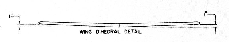

LOved my Deceptions (all 6 of them). I built 2 from the Bridi kit and 4 from scratch (MAN plans). I seem to remember that Bridi plans showed too much dihedral and the MAN plans were correct (something like the center section 1/2" above a flat surface with the wing upside down). Also, I always built the rudder full length (not stopping at the stab). Otherwise, a great flying plane.

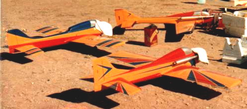

Here's an old shot of two Deceptions setup with side and rear exhaust
engines. I liked the side exhaust setup myself. This is a great flying plane.
Ron

Rainedave,
Deception was designed and built by Jim Kimbro in California while he was working for Phil Kraft. As part of my SPA validation quest, I located and contacted Jim and got the note that he first flew it on November 1975. The MAN article appeared in the 9/78 issue and is still available on e-bay from time to time. Jim flew his with side exhaust Rossis on a pipe. Why he called it Deception, I don't know. By the way, Jim recommended that the rudder not be extended to the bottom of the fuselage. The upper only design redcued the yaw-roll cuouple that pattern planes had back then. Mine is as per Jim's design and knife edges with no yaw-roll issues to trim out. Remember, we had no computer radios back then to overcome design defects.
The rear exhaust version is UGLY. The canopy in the photos is also used on the Bridi Escape from early turnaround days. I'm building one of these also with a backdoor Rossi.
The dihedral on the Bridi plans is wrong.

I, too, thought that the Bridi kit called for too much dihedral. When I was in California on a business trip in the early 80's I had the opportunity to meet Joe Bridi and I asked him about it. He replied that Jim Kimbro (the designer) had made the modification to the dihedral that Joe incorporated into the kit. Nevertheless, if you use the rudder as designed (the movable portion only extends down to the top of the fuselage) I still feel that the kit dihedral is too great. That was how I built my first one. My second had the movable portion extended all the way to the bottom of the fuselage to get more rudder authority and to lower the center of pressure on the rudder. If one were to do this, then there would be less adverse roll induced by the rudder deflection and the amount of dihedral should definitely be reduced. Dihedral will result in a roll in the direction the rudder is deflected. A rudder which has the center of pressure above the fuselage will result in a roll opposite the direction of deflection. Dihedral should be balanced against the adverse roll induced by the rudder. There are other considerations, of course, but this is certainly one. Back then I asked Don Lowe about this situation since he has a background in aerodynamics. His repsonse was that it was simple to take an electric saw and cut through the top of the wing center section, adjust the dihedral, and put an epoxy bandage over the cut. That way you could slice and dice and adjust the dihedral all you wanted. That was how he dialed in the correct amount on some of his designs. But, I never could bring myself to cut the wing on a successfully flying model. Not enough engineer in me, I guess (actually I am a theoretical physicist).

Jeff,
Nice summary. However, I built it with the "short" rudder and the lower dihedral and it doesn't have any coupling issues that I can find. Agine the real world vs. aerodynamic theory.
(BTW, I've got two degrees in aero from Georgia Tech and this is far from the first time I've had results not quite in line with my "very carefully and accurate" calculations (g))
I've also cut wings like Don suggested. This was one of the tuning techniques in the "good old days".

Rich,
That's good to hear about how yours turned out. I am still waiting for the MAN plans ("any day now") and I was debating which rudder configuration to use. Now I am leaning towards the standard rudder and the original dihedral called out on the MAN plans as yours has worked out well. Back when I built mine as per the kit the dihedral on #1 was too great even with the short rudder. I built the second with the lengthened rudder but I hadn't thought through the dihedral issue fully. As I recall, I did reduce it some, but not enough. Now it seems as if the original dihedral (not the kit) combined with the short rudder was the correct amount to begin with. Ah - if only I had a time machine...
