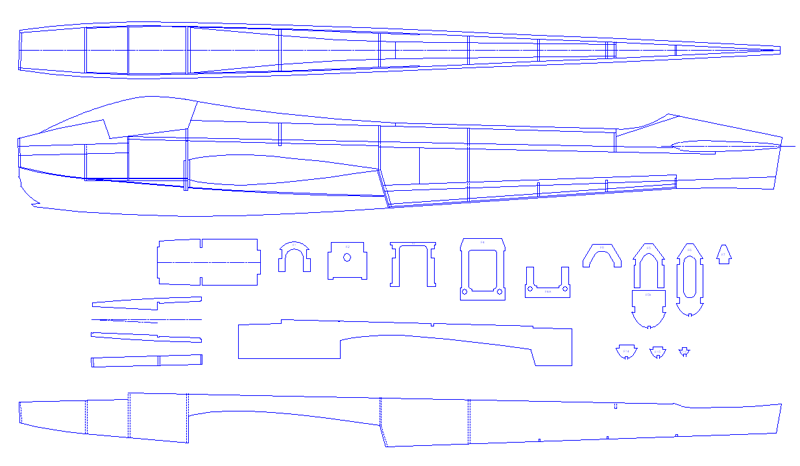

Thanks for the encouragement, guys. I've drawn all the formers. I just need to double check everything for accuracy.
antique opa, there's an easy shortcut to drawing in cad. It's called Deltacad: http://www.deltacad.com/demo.html
You can get the free demo to try out. Granted, it's no where near as powerful as Autodesk, but then, the full license only costs $39.95.
Deltacad has its limitations, but for hobby use - like I'm using for - it works great. The best part is that it's very easy to learn.

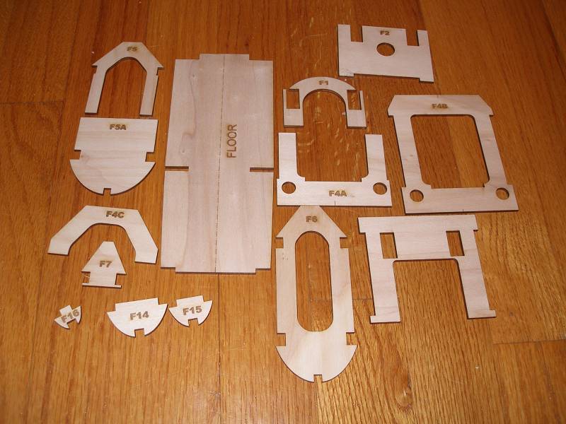

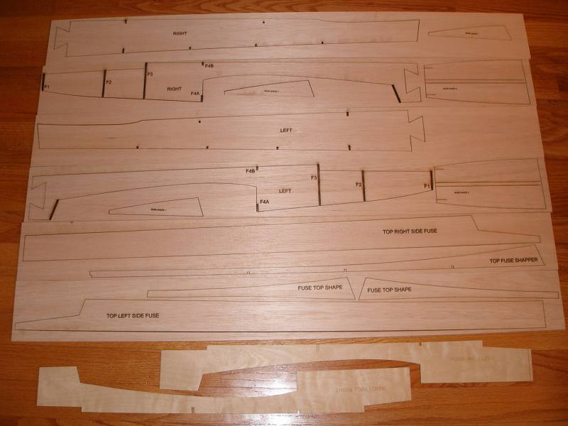

I worked on the plans you sent and made a few mods to see if I could get a short kit cut that may be of interest. Maybe someone has a canopy and belly pan I could model later to see if the fit works without much change. I will attach a few pictures ...
Later,
Greg

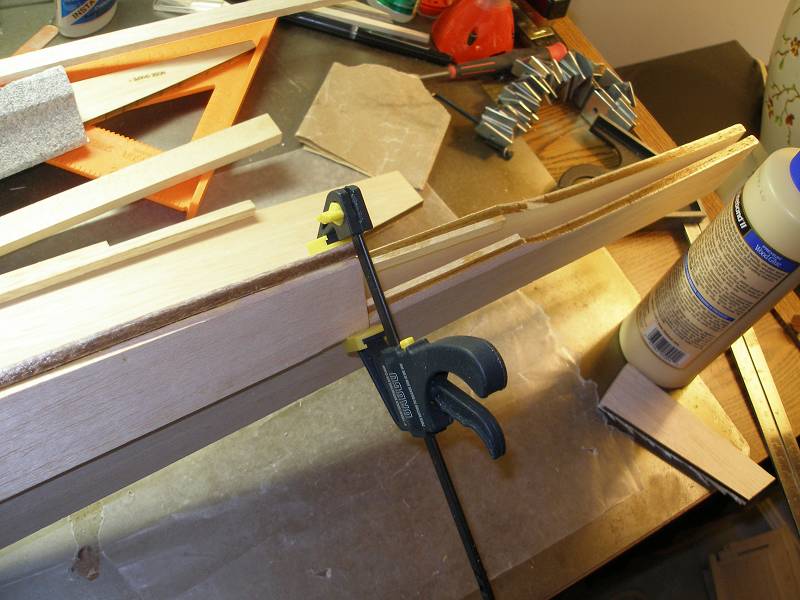

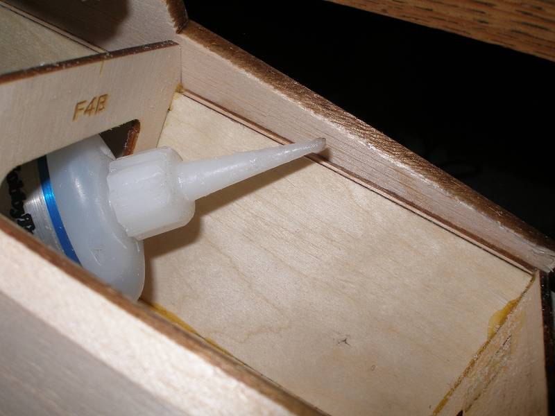

Here are some more pictures... attaching the fuse and inner fuse wall.

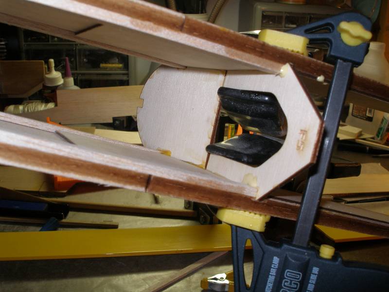

More pictures... attaching the engine mount formers and fuse sides starting from the front.

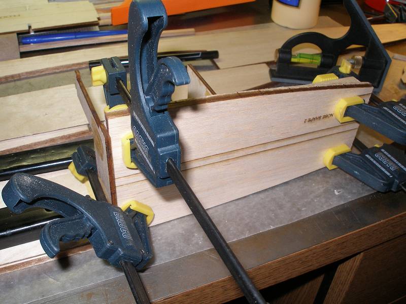

More pictures... finishing the front for the run down the back.

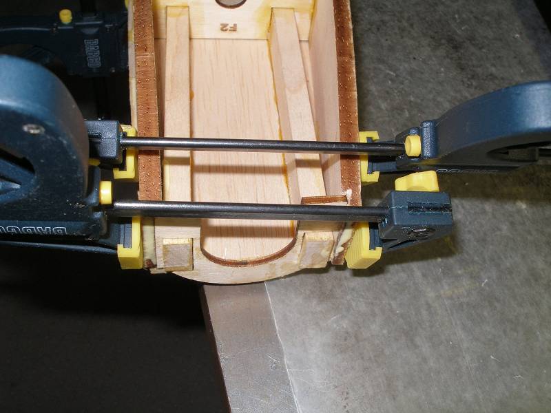

Old 10-18-2007 | 11:47 AM
  #42
cam-flyer's Avatar
Joined: Jul 2007
Posts: 101
From: Charlotte, NC
Default RE: Aurora 60 Plans?

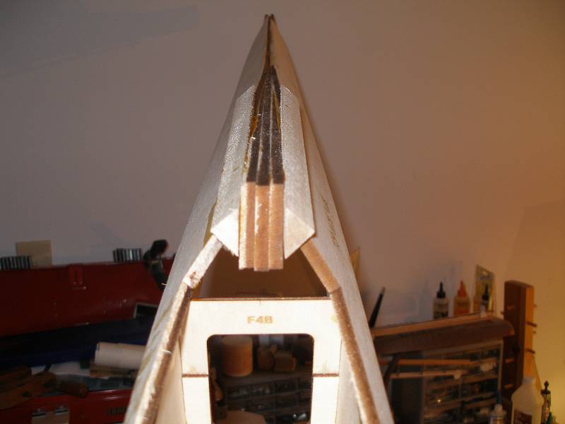

Attaching the top fuse shaper and top fuse shapes...

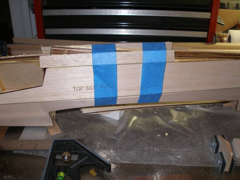

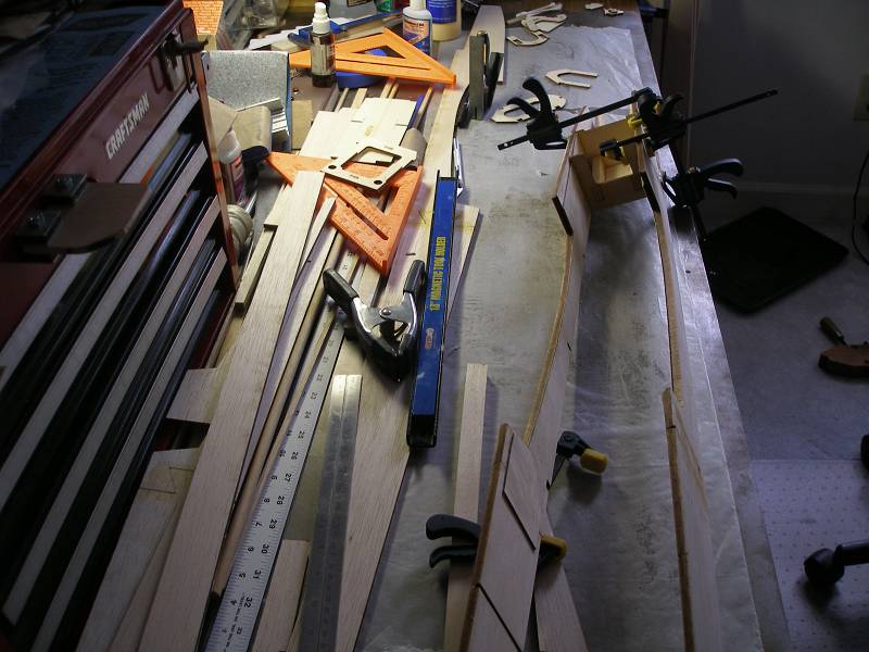

Do some flat sanding to attach the top left fuse. This piece will be used to clamp the other side down.

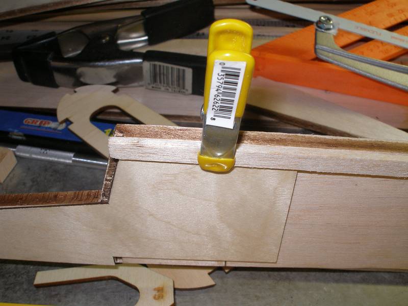

Old 10-18-2007 | 12:00 PM
  #45
cam-flyer's Avatar
Joined: Jul 2007
Posts: 101
From: Charlotte, NC

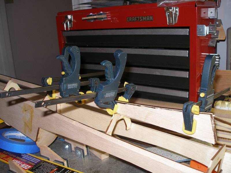

Attach the top left fuse.

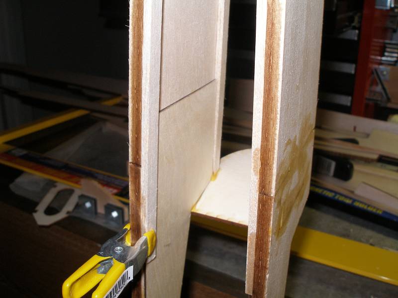

Old 10-18-2007 | 12:17 PM
  #46
cam-flyer's Avatar
Joined: Jul 2007
Posts: 101
From: Charlotte, NC
Attach the top right fuse, clamping from the left.

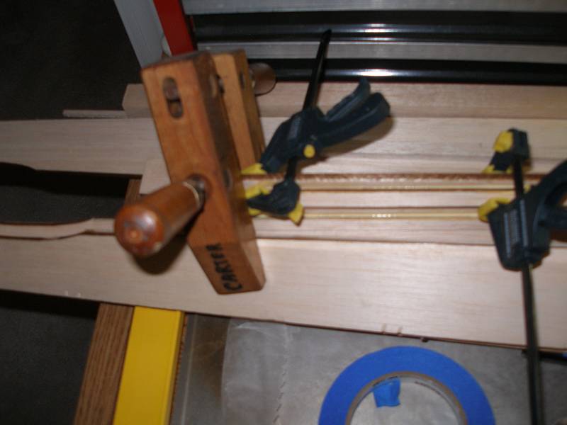

Old 10-18-2007 | 12:29 PM
  #47
cam-flyer's Avatar
Joined: Jul 2007
Posts: 101
From: Charlotte, NC

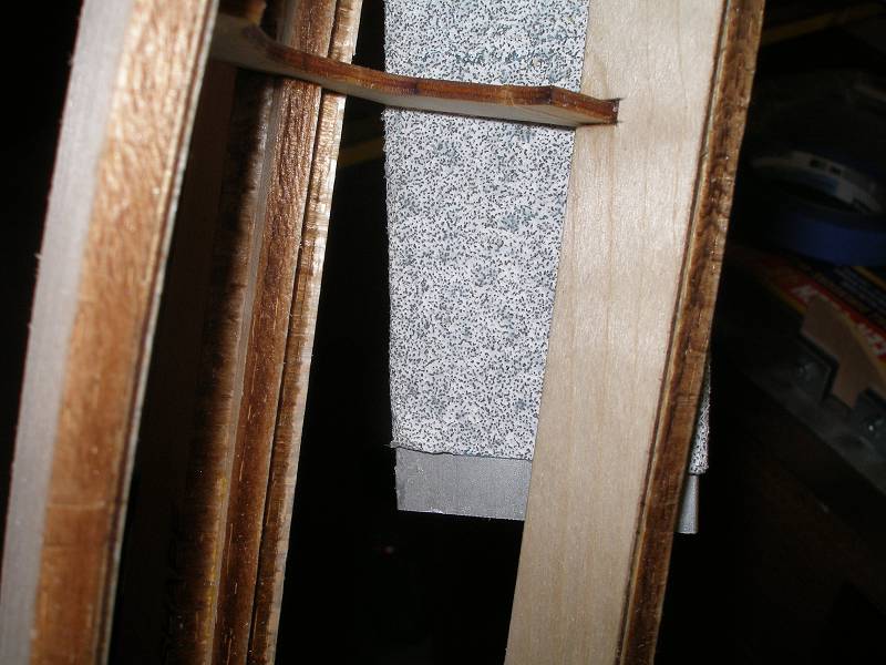

Smooth out the glue paint seal inside the fuse.

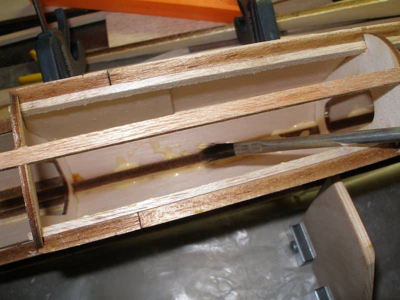

Old 10-18-2007 | 12:44 PM
  #48
cam-flyer's Avatar
Joined: Jul 2007
Posts: 101
From: Charlotte, NC

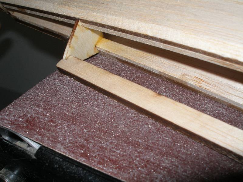

Attach some 6/8 triangle balsa sticks to the top fuse. Glue paint the inside.

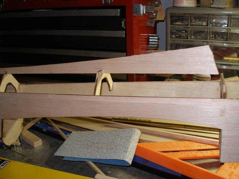

Old 10-18-2007 | 12:55 PM
  #49
cam-flyer's Avatar
Joined: Jul 2007
Posts: 101
From: Charlotte, NC

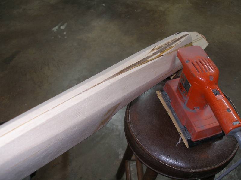

Rough sand the shape in prep for the good old hand sanding...
