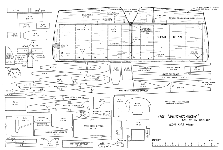

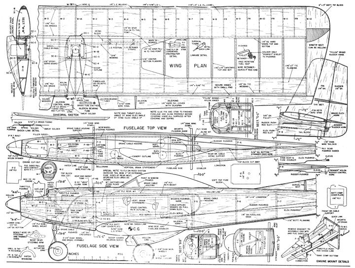

Mine copies aren't the best quality, but you can build from them. PM me your email address if you want them.

Jon, that's not a bad idea. It could definitely be updated and simplified quite a bit. Although, I still like the balsa block fuse top. With all the weight you'd save using current hardware and electronics you wouldn't even need to hollow out the top block into a thin shell. A 1" x 4" x 36" soft plank would do fine: build the fuse upside-down on the top block - ala Sun Fli/Kaos - and then rasp it to shape with a Sureform after it's constructed.
The throttle linkage on the plans looks like something designed by Caractacus Potts. You don't need a nose gear brake today, either.
I would go with a simple D-tube wing using one top and bottom spar. The cowl, chin and air scoop would still require some carving.
With those changes it wouldn't be any more involved that building a Super Kaos or Daddy Rabbit.

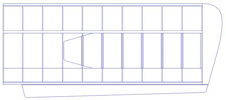

Now, don't go nominating me, but I have simplified and re-drawn the Beachcomber wing panel in CAD. More to come:

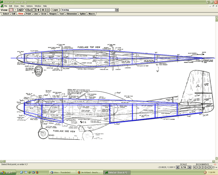

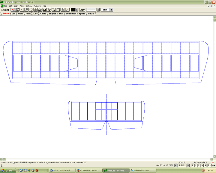

I started work on the fuselage. The wing and stab are done.

I'll be glad to share the plans when I finish.
Now, I need some feedback from those who have flown the Beachcomber, or, who want to build one:
The wing has 1.5° positive incidence as shown on the plans. The airfoil is symmetrical. Should I make everything 0-0-0 or leave the positive in the wing? There is no engine down thrust shown, but 3° of right thrust is shown.
I typically like to build planes 0-0-0, but, I'd like to hear what people have to say about this particular design.
