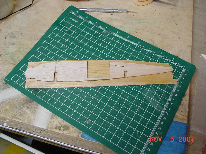

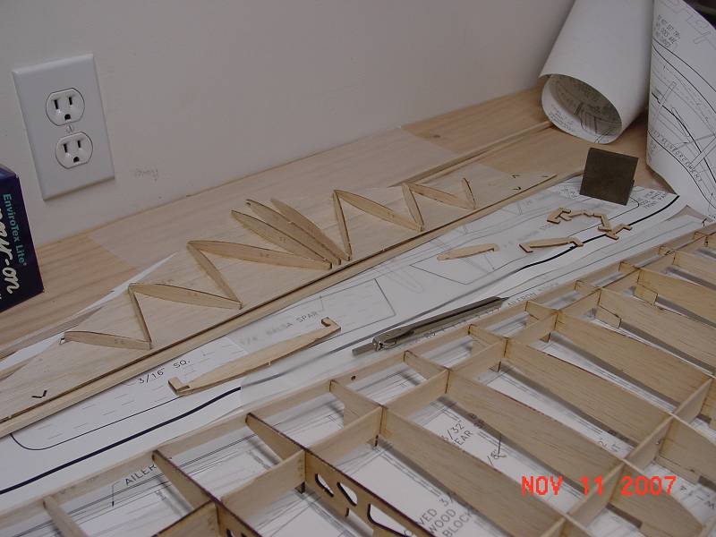

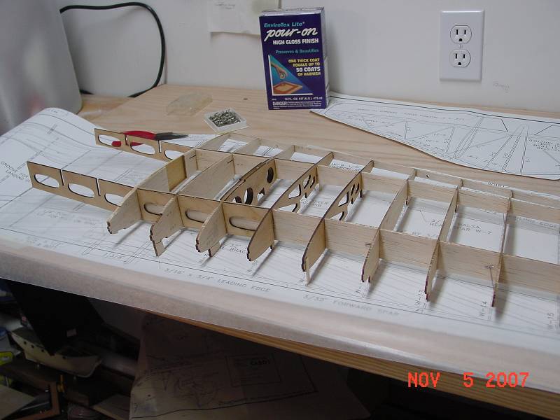

OK, here goes. I got a PassTime Perigee, and am starting to build it. Don't expect this to be a fast-moving thread, I hope to have her ready by early summer 08. Also, this won't be a stick-by-stick build, just the highlights, insights, and lots of assembly photos.
First impression of the short kit - very nice quality, light balsa, laser cut.
My biggest surprise as I started to assemble the wing - the spars are curved forward! Lots of pins into the board are needed to keep things aligned. One of the plywood dihedral braces needed a slot widened. A word about the spars, they are delicate. Read as in "I broke it several times playing around and fiddling with the ribs"
The center rib has only one supplied, not two as shown on the plans. This rib is out of thicker stock, but not thick enough to fill the slot. I added a doubler of 1/16 balsa to fill it out. Since I'm planning on outboard aileron servos, the center cutout was not needed, so the 1/16 atually strengthens this area.
Photo 1 - center rib doubled
Photo 2 - assembled egg crate
Photo 3 - curved spars

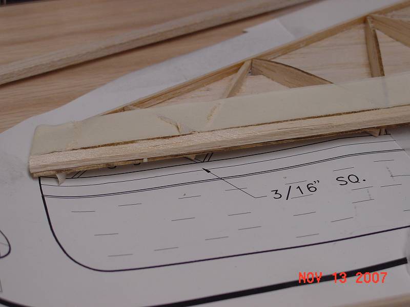

Well, I put the LE sub-strips on earlier tis week, but haven't had time to post it until now. Looking at it, I would highly reccomend this step. It forms a continuous gusset between the sheeting and the LE, adds a tremendous amount of strength and rigidity, for almost no weight penalty.

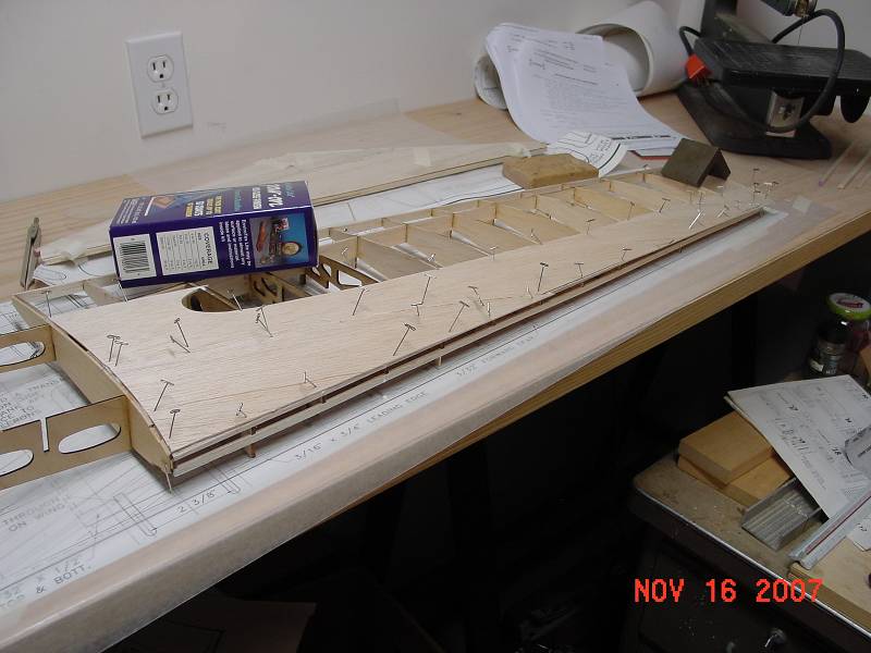

I almost forgot to show this part. The plans call for 4 of these plywood bridges at the wing root. I believe they were for strength where the rubber bands curve around to attach at the LE (the TE is hardwood in the center).
I thought about not putting them in, but then realized that for the LE dowels, they would have no internal support, just where they glued at the LE. Soooo, I'm going to put a shear web between these pieces, which will give the dowel some purchase at the rear.

And here's the next pieces of sheeting in place. Starting top look like a T-pin forest here.
