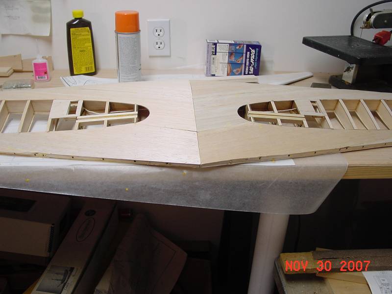

OK, now all the wing sheeting and capstrips are done and in place. Also both servo mounts. More on that below. Next step is to plane/sand the LE and TE flat and add the pieces. Then it's sand the tip ribs flat and add the tip blocks. Then some TE stock at the wing root, ply doubler for th wing bolts, and sand my heart out!

Servo mounts. Recall from above that the left panel was installed before building the right panel. Look closely at the photo below, and realize that I very carefully copied each dimension from the bottom of the left panel (right side of the photo, the wing is upside down) to the right panel, and then made the cut-out and the internal stuff to mount the servo. Then i step back, and say "you dumb sh*t, you forgot to mirror image the dimensions"
My only excuse is that the muffler is on the right side, so mounting the left servo further out will help compensate for the weight. (it won't make a bit of difference, but sounds like a good explaination)

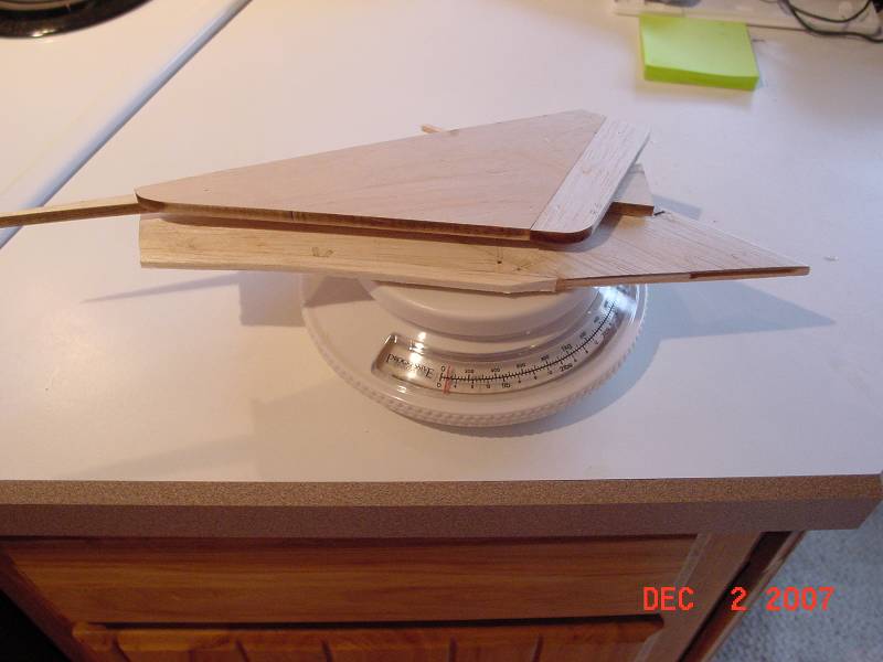

Well. I had to use a kitchen scale to weigh the vertical stab. all up, 1.5 ounces, very light.
I also weighed the wing, with the LE & TE installed but not sanded, no tips. It weighs 12 ounces.

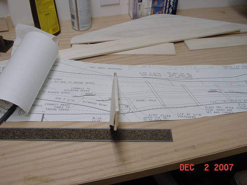

I copied the plan onto some orange paper (hey, it was free) and traced out what I wanted for the inner structure. Then I cut out the pieces, laid it out, glued, and here's the FLAT center structure. Notice the extra width at the rear, that is so the hinges will have a good purchase.

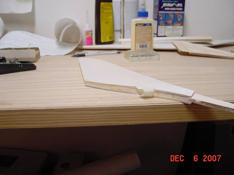

OK, now for some sanding. I decided to put a tape line down the stab so I have a guide line for the CL of the high point.
