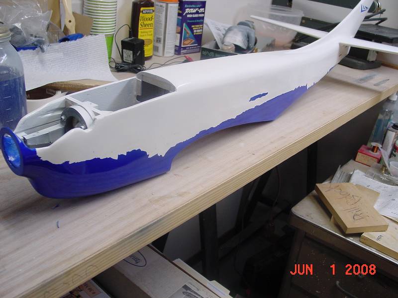

Well, yea, OK, so I got discouraged and dropped it for a while. After really looking at it, and picking the flakes off, I have noticed that the blue has left some kind of base that the paint peeled off of. Here's the photos, ready for 400 grit wet sanding this week.......

So now I am thinking.....
Do I continue with this Indigo Blue translucent paint, or should I go back, and buy the deep blue which will cover better?
I will say that a call to Klass Cote gave me the info that the indigo is the only paint that they have trouble getting pigment for, it comes liquid, rather than solid, and it is a bit translucent. They were very helpful, and suggested 2 coats.
If I get a different color, I will have to re-shoot the left wing that I have finished. It will add weight, but being the left panel, that will help offset the muffler. Not a bad trade-off.
On the side of continuing with the indigo, I would only have to shoot the body and right wing panel. Maybe it will come out OK
My final decision is to go with the deep blue, which should be opaque solid color. I am too afraid that the body will show the peeled paint line through the following coats.
So a little more work, but guaranteed better results have won out. Originally, I wanted to have this done by the middle of May (HA!) So the new target is July, still enough time to trim out and get some air time in.

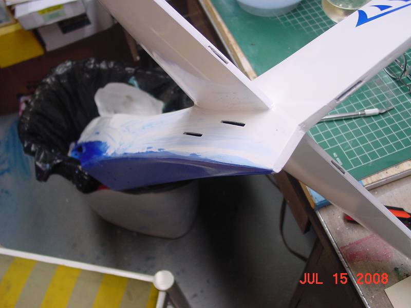

Seriously, I got really discouraged about this painting, and was very afraid that when I started to sand, two things would happen:
1 - expoy paint is really hard to sand. This is CORRECT
2 - In sanding off the rough edges, I would sand into the white, requiring massive re-spray. FALSE!
So, for the last hour or so, I have carefully used 400 grit wet, and got the left side edges down smooth. You can see from the photos how it goes. Some shots are before wiping off, some after.

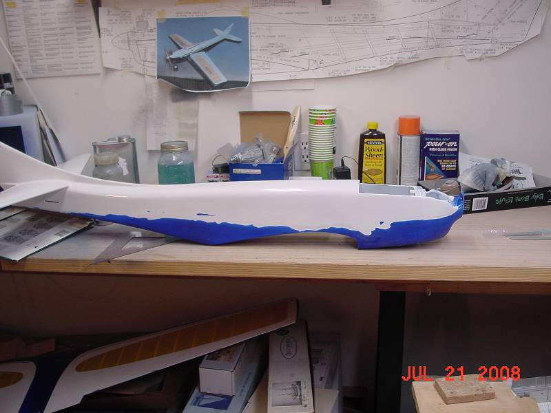

OK, went around to the right side. Sand for about an hour, the edges are now feathered out, so I can look at taping and spraying next ???
Notice I went through the white in a few spots, but that's where the blue will go, so all is still cool.
