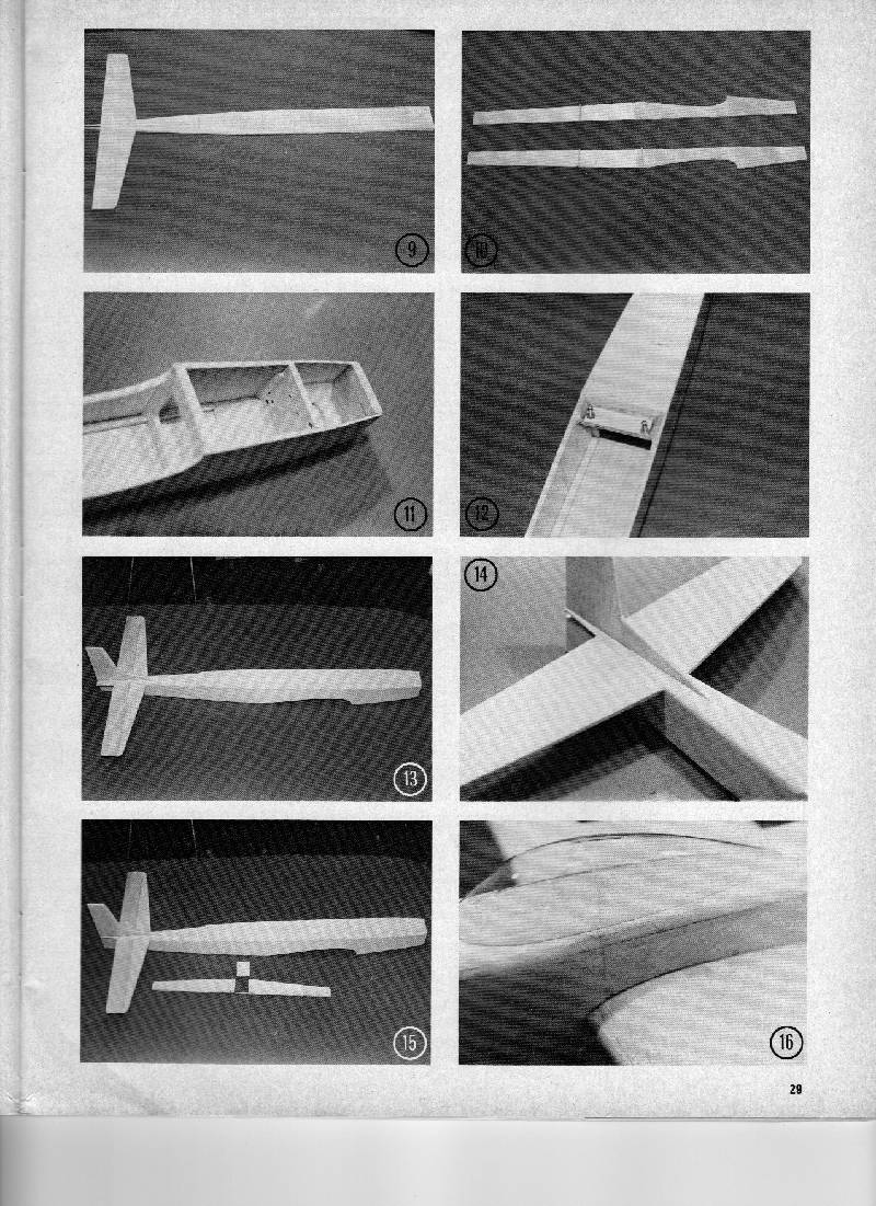

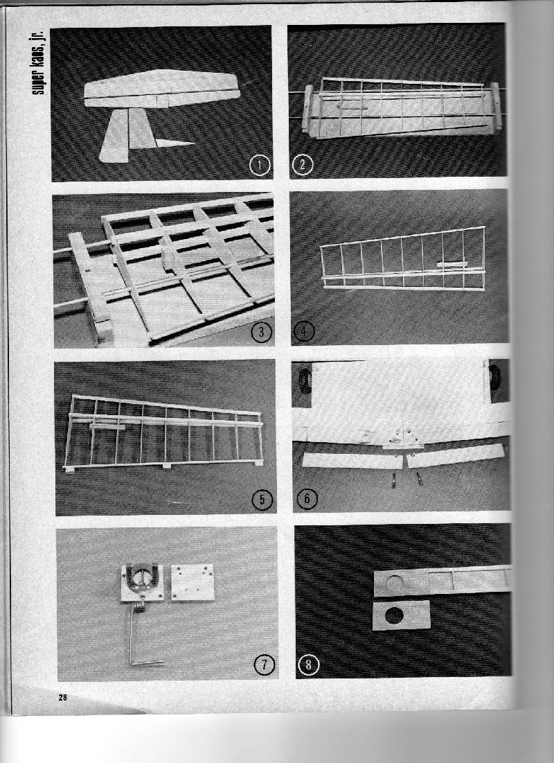

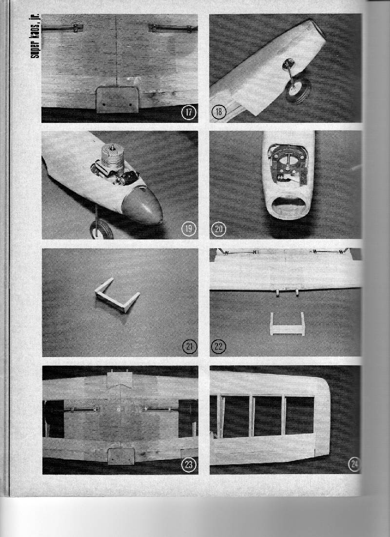

The help I need is articles, pictures of Kaos builds in the "bones" so I can get an idea of what the text is trying to convey to me in the built up view. I am used to building with booklets showing step by step the built item and now the BJ kit is in text only and I need help to visualize what it looks like so I don't mess up and ruin the balsa parts.
Thanks email me at [email protected] with any articles and photos of your builds would be very helpful

Jim, I missed the build article in mags the most. I also would study every plan featured in a mag over and over... Unfortunatly reviews are left to mainly to arfs. I guess thats ok in it's own right. We difinatly have more people involved in the hobby now than say 20 yrs ago.... Now if we could just get them to build

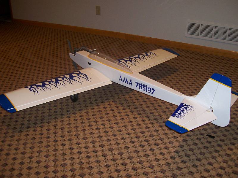

Philip,
Here's a couple of pics on how I built my Bridi Utter Chaos wing.
I purchased an 8 foot section of aluminum angle stock from Menards. I cut it in two 4 foot sections and used the angle stock to align the cutouts that were already in the ribs.
If you just follow the steps and study the plans, you should be ok.
I also included a finished picture of the airplane.
Scott.
