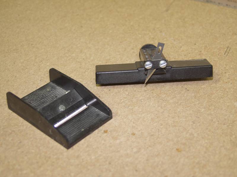

Here's some of the tools and adhesives that I'll be using. I mostly use wood glues for construction and CA for tacking. CA is very difficult to sand smooth, usually the surrounding wood disappears before wood in a CA joint. [:@] Three tools of importance (to me anyways) is a Foremost Miter Sander, a Master Airscrew Razor Plane and a Master Airscrew Balsa Stripper. I especially like the balsa stripper as it allows me to cut strip stock from sheets instead of buying various strips from the LHS. The other 2 tools speak for themselves.

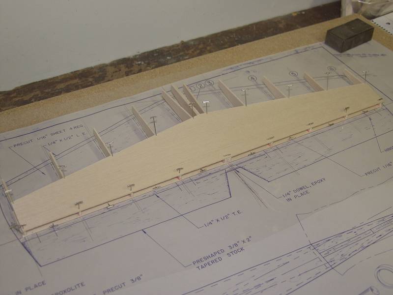

I decided to build the stab first, so the first thing to do is gather/make the parts needed. The balsa stripper comes into use first thing, as the stab L/E & T/E are 1/4" x 1/2" strips of balsa. The stab is a diamond airfoil that's sheeted with 1/16" balsa. The top and bottom sheeting are the same and easily made by measuring the dimensions for the plans and transferring them to the sheet.

The first step is to lay out the rib locations on the bottom sheet. I pinned the sheet into place on the plan and with a straight edge, drew the rib locations on the sheet.

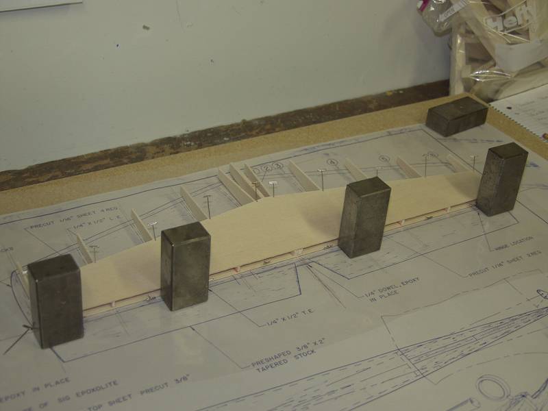

The center rib is laminated from 2 number 1 ribs. I have several heavy machinists blocks that are perfectly square and are excellent for ensuring things like ribs are exactly vertical. I also placed one against the edge of the sheet and pushed the rib against it. I used this process for gluing all the ribs in place.

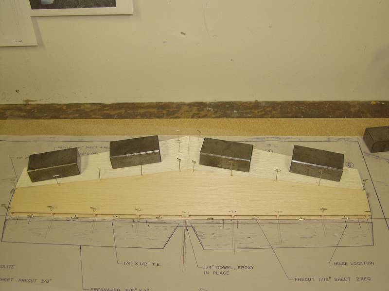

When the glue had dried, I used a sanding bar and lightly sanded the aft part of the ribs to even them up and added the top rear sheet. As you can see, I used the metal blocks to align the top sheet.

Next the forward top sheeting is added. Be sure to slightly bevel the rear edge of the sheet so it mated tightly to the rear sheet. For all gluing, I used Sigment, as I like the ability to perfectly align the parts. I used the blocks and a few pins to tightly hold the sheeting to the ribs while the glue dries.
