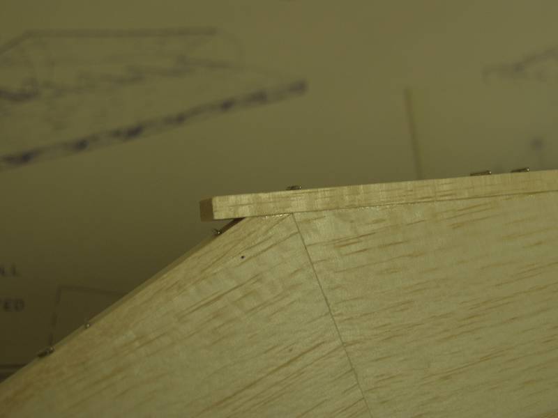

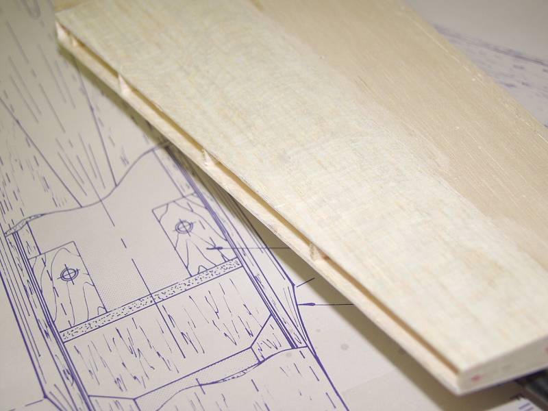

While the glue was drying, I noticed how the T/E of the stab was open, and remembering that it's capped with 1/4" stock. I thought that only a 1/4" of material for the hinges wasn't enough for a secure bond. So I decided to add some balsa blocks where the hinges are going to be located. Stock configuration is 2 hinges per elevator, I'm going with 3 hinges per elevator.

Old 01-01-2008 | 10:29 PM
  #56
Joined: Nov 2005
Posts: 2,239
From: Farmington, CT
Default RE: Eureka Banshee Build Thread

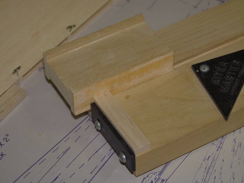

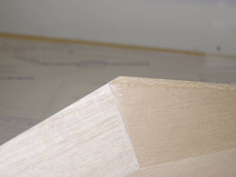

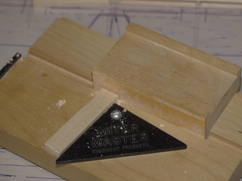

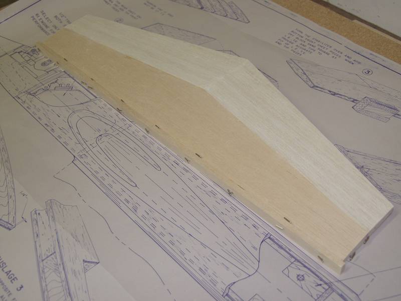

Here's a few pics of how I did it. I used 1/4" x 1/2" stock, and here's where the Foremost Miter Master starts to come into play. I used it to square off the ends of the blocks and to cut the angle on the blocks that fit against rib #2. I find it a very handy tool to make perfectly fitting parts. When I glued the blocks into place, I left them a little proud of the T/E sheeting so that when the T/E is sanded, everything would be flush for the T/E cap.

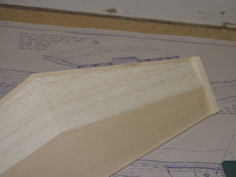

Old 01-01-2008 | 10:33 PM
  #57
Joined: Nov 2005
Posts: 2,239

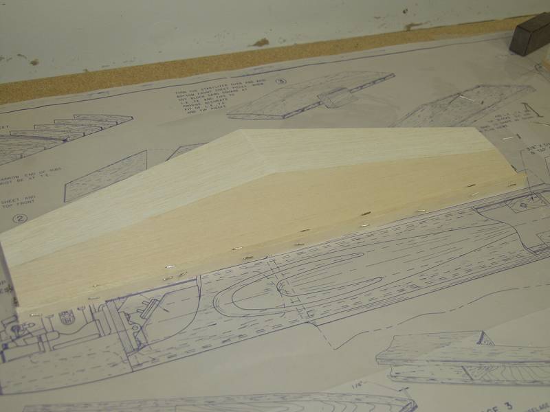

When the glue dried, the stab is removed from the building board and the T/E is sanded so it's flush and square. I use a long sanding bar for this. The stab is now pinned down again to keep it flat and the 1/4" x 1/2" cap is glued in place.

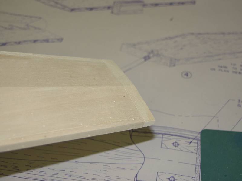

Old 01-01-2008 | 10:41 PM
  #58
Joined: Nov 2005
Posts: 2,239
The next step, after the glued has dried, is to trim and sand the T/E flush with the top & bottom sheeting. Moving on to the L/E, it also needs to be trued up for the L/E stock as the sheeting is over hangs the ribs. When done the 1/4" x 1/2" L/E can be glued in place. The first 2 pics show the L/E before sanding, the 3rd pic after sanding and then the stock glued into place.

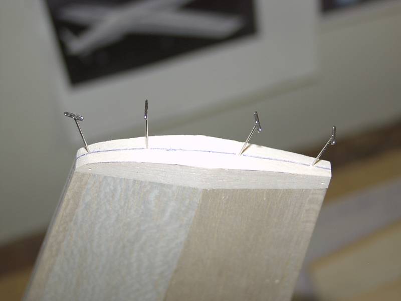

Old 01-01-2008 | 10:58 PM

Here's where I changed the L/E a little. The plans have you butt join the L/E at the center, I changed this to a scarf joint as it's a little stronger and easier to make a perfect joint. The L/E is sanded down so its flush with the opposite L/E and then using a razor plane, the excess stock is removed from the top and bottom and then sanded flush with the sheeting. The other L/E is glued in place and the same process is repeated. The end result is perfect.
