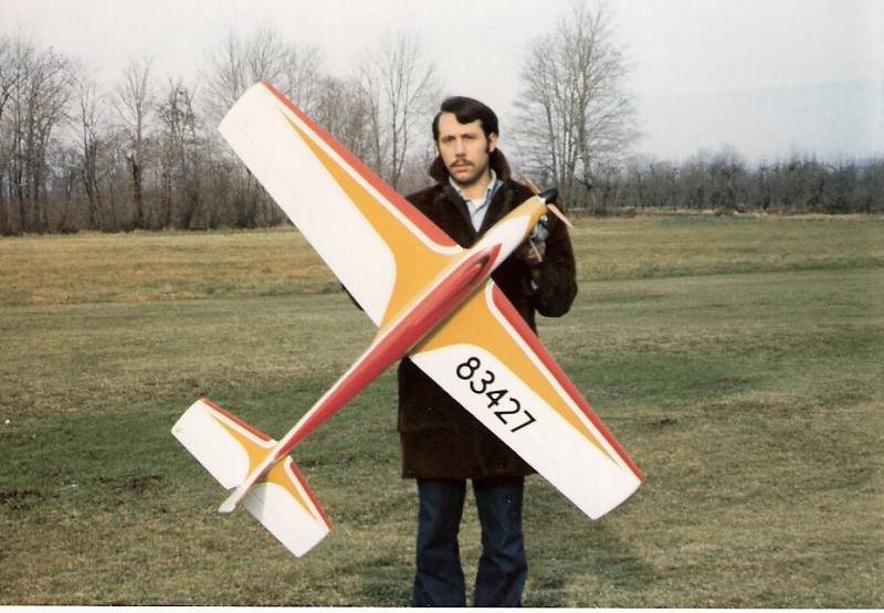

Here's some photos of my Banshees. First one was scratch-built automotive lacquer finish, fall of 1972. Second one was J&J kit, monokoted summer 1973. My second contest win was with this, Bridgeport meet that year, 2nd class "A"
WEDJ,
The wing seems very close to the bottom of the fuselage on that second Banshee. I always thought the model had thrust line/wing/tail more or less in line like the Eyeball from which it was developed.
Ray

ORIGINAL: RFJ
WEDJ,
Ray
It's an optical illusion. The wing sat in the middle of the orange body stripe. I'll try to find an alternate photo this w/e.
Seem to suffer from more of these the older I get. Looking more carefully at the photograph I see what you mean about the wing/fuselage intersection - she's a proper Banshee.
