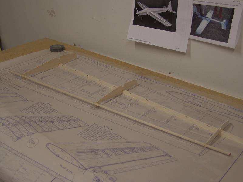

Now that was figured out, I could start building.
Note that the Banshee wing is built upside down on the plans. First thing is to pin the top spar in place. I consider this spar to be the foundation of the wing. After all, if it's not straight, you won't be able to build a straight wing. To ensure that the spar is straight, I first pin a long metal ruler down on the plans and then pin the spar against it.

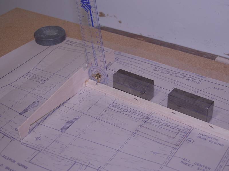

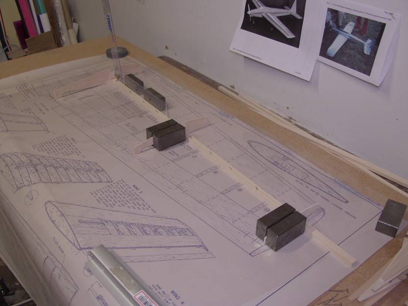

Next, ribs 1, 6 and 11 are pinned in place. Make sure ribs 6 & 11 are verticle, I use the metal blocks and then glue the ribs. Now the root rib, #1 needs to be angled for the dihedral. Using the angle gauge, the rib is laid against the gauge and glued in place. Remember, the wing is built upside down, so the top of the rib is angled AWAY from the wing tip.

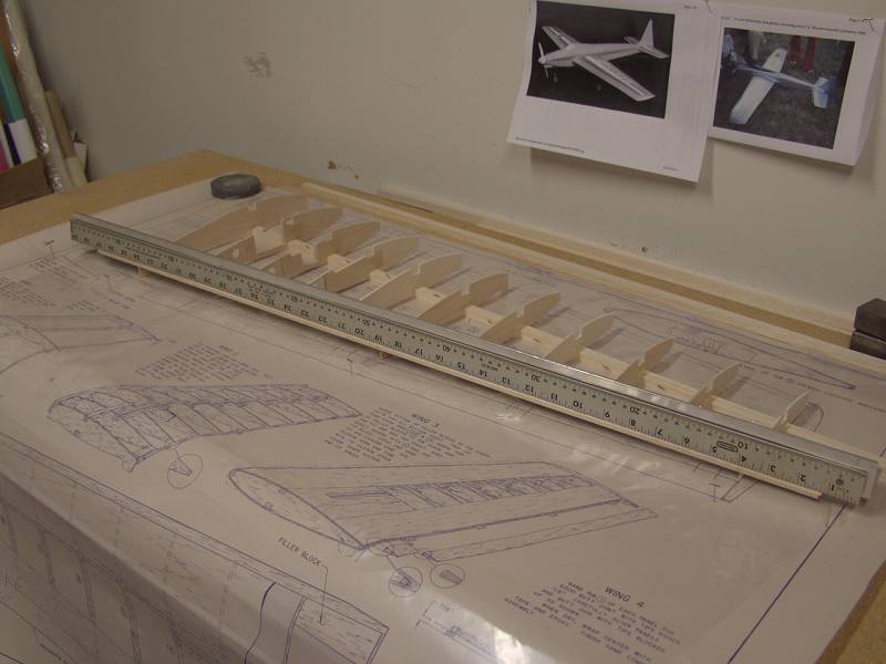

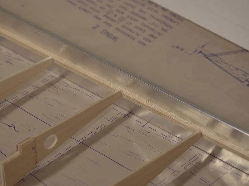

The T/E is glued to the ribs next, but first the back of the ribs need to be trued up so they are all even. I use a lenght of aluminum angle and place it against the ribs. If the ribs are not even, it's very obvious and the offending ribs can easily be sanded. I've never built a wing where all of the ribs lined up perfectly. You can see this very clearly in the before and after pics of the root rib. I also use a trued up sanding block to make sure the back of the ribs are verticle.

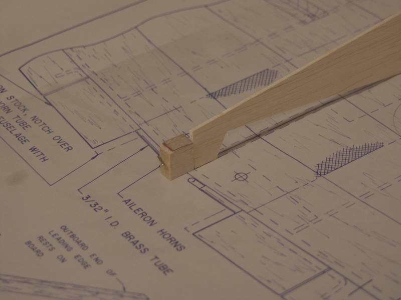

The T/E is added next. At the root rib, its 23/32" from the building surface, and at the tip its 3/8". Using some scrap wood, I made two blocks at the correct height and pinned them against the ribs. The T/E is then pinned to the back of the ribs.

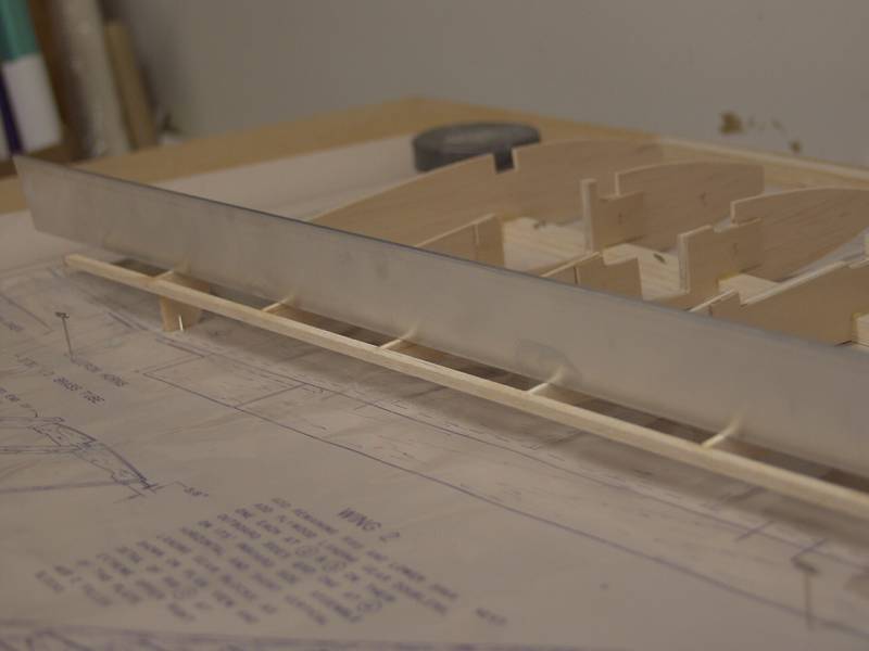

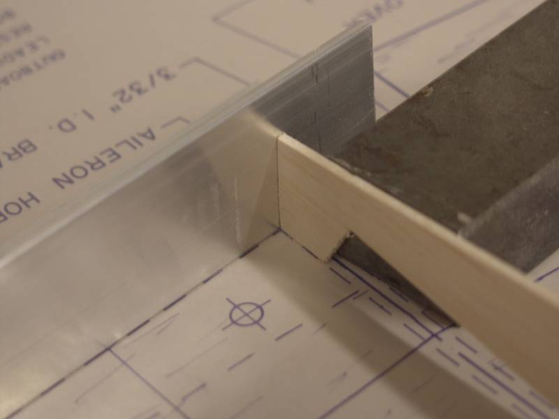

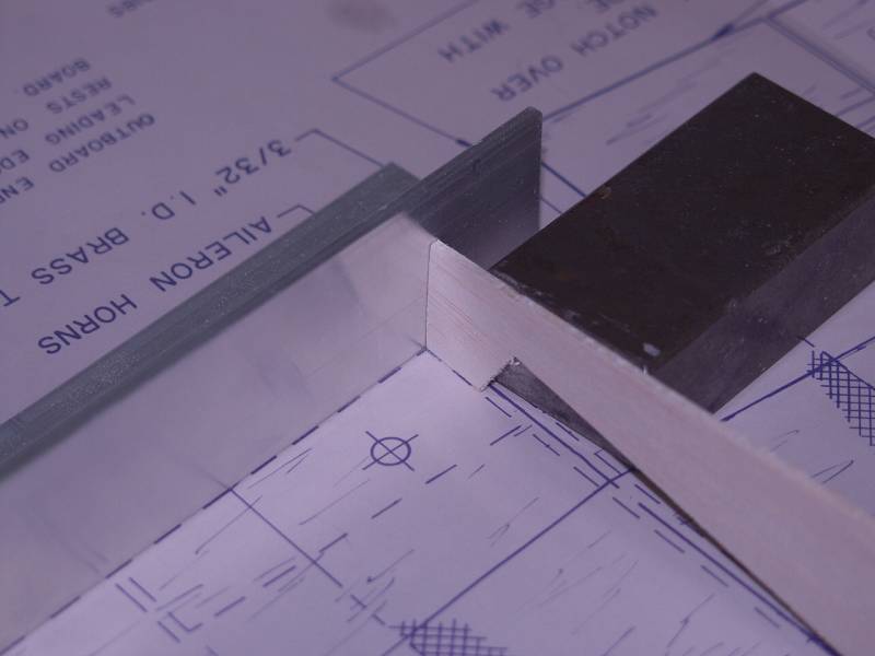

To keep the back of the ribs on the plan, I place the aluminum angle on the ribs. Now, remembering that the T/E isn't supported, I used a long metal ruler, and placed it on the T/E stock and raised the T/E at rib 6 and pinned in place. I removed the support blocks and glued the T/E to the ribs.
ID:	887335   Click image for larger version
ID:	887336   Click image for larger version
Old 02-24-2008 | 12:17 PM
  #159
Joined: Nov 2005
Posts: 2,239
From: Farmington, CT
Default RE: Eureka Banshee Build Thread
Before adding the remaining ribs, I pinned the aluminum angle against the T/E so it wouldn't be pushed out of alignment. Each rib can now be fitted into place but not glued yet. As expected, each rib needed to be sanded to fit without pushing the T/E out. Now I placed the angle on the top of the ribs. Each rib should touch the angle to be properly aligned, either pin the ribs or use a small piece of balsa under the ribs to hold them in place. To keep the T/E aligned, I again place the metal ruler on the T/E and make sure its against the ruler as I glue the ribs to the T/E and to the spar. What all of this accomplishes, is that the T/E is straight from the root to the tip, is not bowed outward and all of the ribs are even from root to tip. It takes a lot longer to explain that to actually do.
