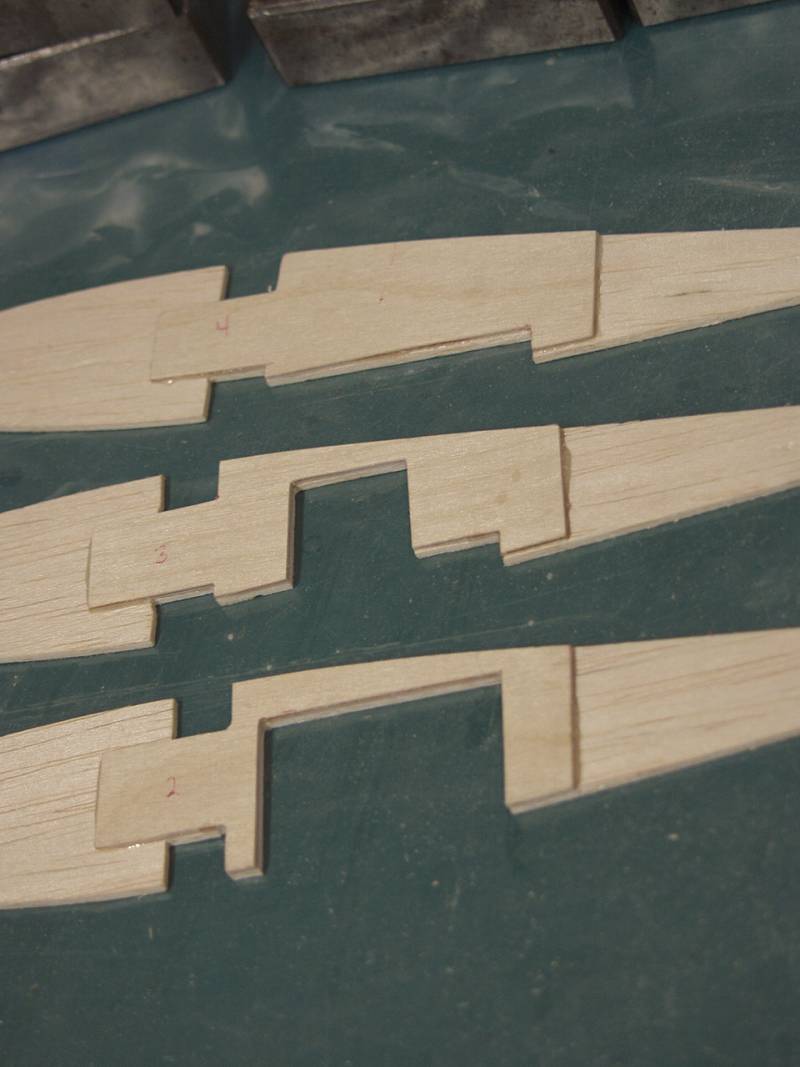

I almost have the mock up done. What I did was to build the section of the wing that houses the gear to make patterns. This way, I wouldn't ruin the ribs and could make sure all would fit well. I happen to have a single Rhom Air retract that as far as I could determine, is the same size as the Spring Air. I'll post some pics in a day or two.
FB

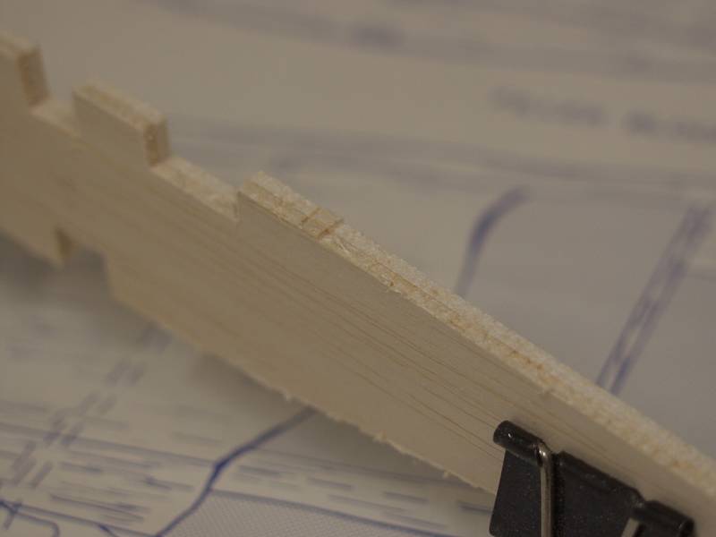

Sorry for the delay guys, you know how life and work can get in the way.....[:@] So on with the build.
The J&J kit was not meant to house retracts, so you have to engineer this on your own. If I'm not mistaken, in later kits, J&J included a separate drawing showing how to modify the ribs for retracts. They did do this with the Troublemaker as I have a copy. I'm sure that retract installation in both the Banshee & Troublemaker would be very simular, so I used this as a guide.
Before getting started, the ribs need to be cleaned up from the CNC cutting. On my example, there was some tool chattering that needed to be removed. Because the wing planform is tapered, the ribs need to be sanded in pairs. I used binder clips to hold the ribs together, which works very well.

In this close up pic, you can see how rough the ribs are.

After sanding the ribs, they should be smooth and even. Also while the ribs are clamped together, check the spar slots and adjust them as necssary. All of mine were a little shallow and the spar was a little proud of the rib. It's a lot easier to make the spar fit now instead of later as you build the wing. When you're done, you'll have 11 pairs of ribs that are excatly the same.

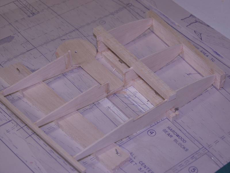

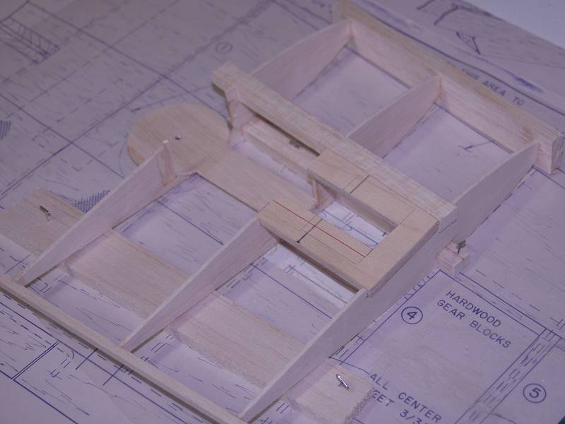

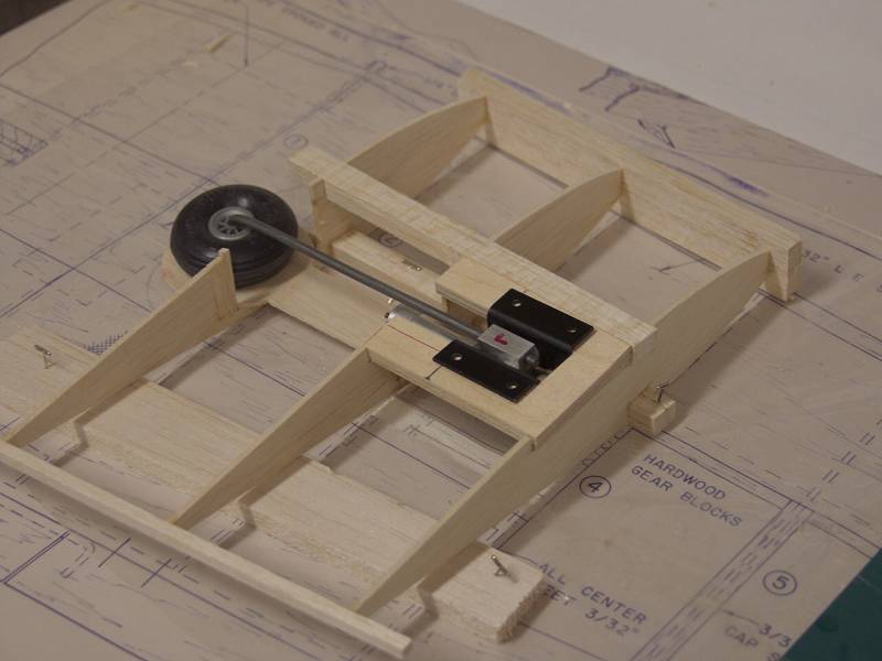

As mentioned, I decided to make a mock-up of the wing section that houses the retracts. Now that the ribs were sanded, I made copies of ribs 2, 3 & 4 and built that section on the plans. I didn't want to hack up the kit ribs, as I knew that there was going to be a lot trail & error cutting up the ribs. Using the Troublermaker retract drawing, I made the ply mounting plate from 1/4" birch ply. I had to change its shape slightly as the Banshee wing isn't tapered as much as the Troublemaker. For maximum strength, I decided to place the plate against the spar and to keep the gear as close to its original position. I cut up ribs 3 & 4 for the plate making sure it was flush with the spar, with the back side of the ribs and flat so there wouldn't be any binding. Next, rib 3 & 2 are cut for the wheel well and the gear leg. I also made a floor for the wheel well from 3/32" balsa. The sides of the well will be sheeted with balsa later during the wing construction. In the pics, ignore the gear leg, it's just a dummy piece of wire to establish the length of the leg for the wheel well.

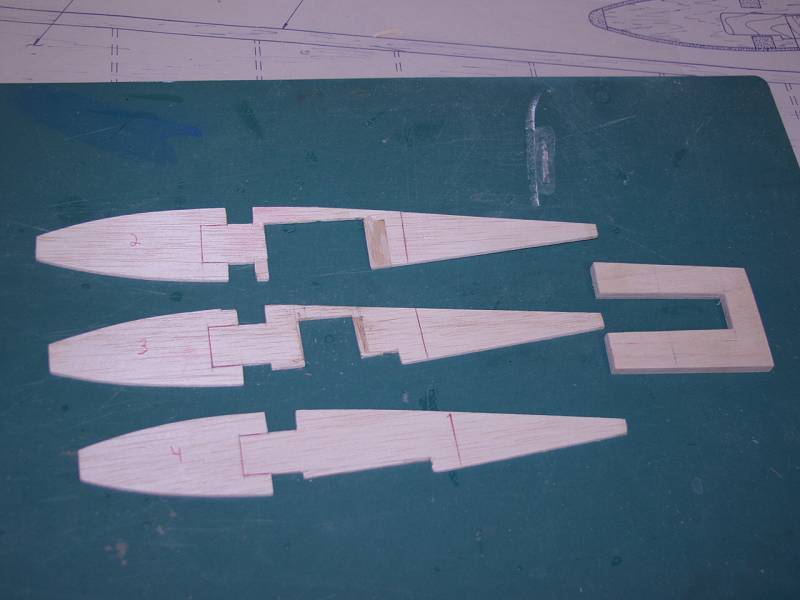

I now took the wing section apart and cleaned up the ribs. As you can see, the ribs were cut up a quite a bit and a lot of trail and error was needed, mostly on ribs 2 & 3.

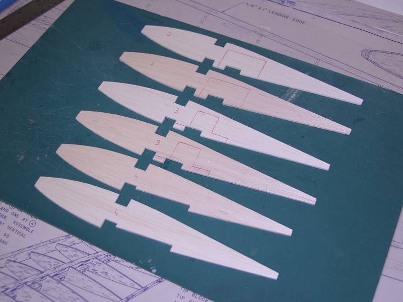

Now, I used the pattern ribs and traced the cutouts on to the wing ribs. In the pics, the cutout has already been made in rib #4, there wasn't much to see.

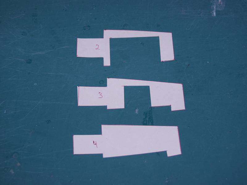

Now it's time to determine the ply reinforcements so everything stays intact. Using the modified ribs, I traced them onto a file folder and drew the patterns for the ply reinforcement plates. On the front, I extended the ply between the spars, and at the rear, past the mounting plate by a 1/2". This should hold up well. I then cutout the patterns and traced them onto 1/16" birch ply and cut them out with a scroll saw. Don't use lite-ply anywhere for the gear installation. Looking at ribs and how thin they had become, I decided to laminate both sides of the ribs for peace of mind.

Here's the ribs being laminated. When this is done and the ribs cleaned up, wing construction can start.

That is an excellent method of building a mock-up first to get the cutout patterns. Great work!
