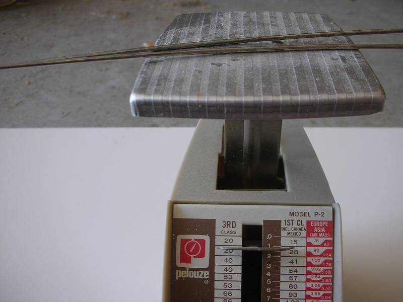

after noticing in 8178's build that his completed fuse weighed just under 13 oz, of course i had to go weigh mine. i happen to have the engine mount attached at the time but the full fuse with mount came in at just under 14 oz. i may have to break out my router again.[sm=teeth_smile.gif][sm=teeth_smile.gif].
david

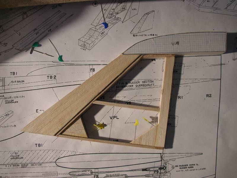

i must be making some progress, i suddenly felt compelled to start the stabilizer sections. i probond glued some square balsa stock to the trailing edges of the horizontal stab foam pieces and did some beginning work on the vertical stab. it took weeks of staring at the vertical stab section to understand what is going on. it is indeed very complex.

more tail assembly/framing work. what a massive tail section. lots of angles and bevels to pay attention to, although there is one angle that i didn't pay attention to. should be satisfying to get to a finished shape.

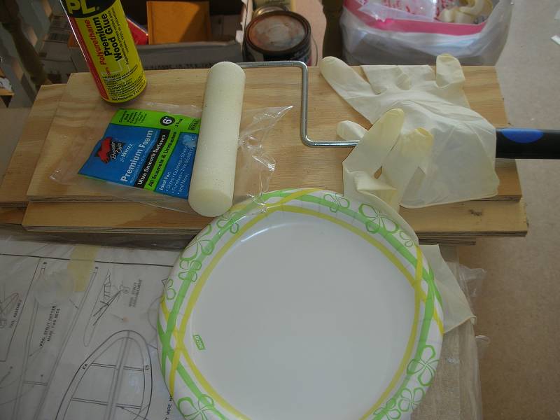

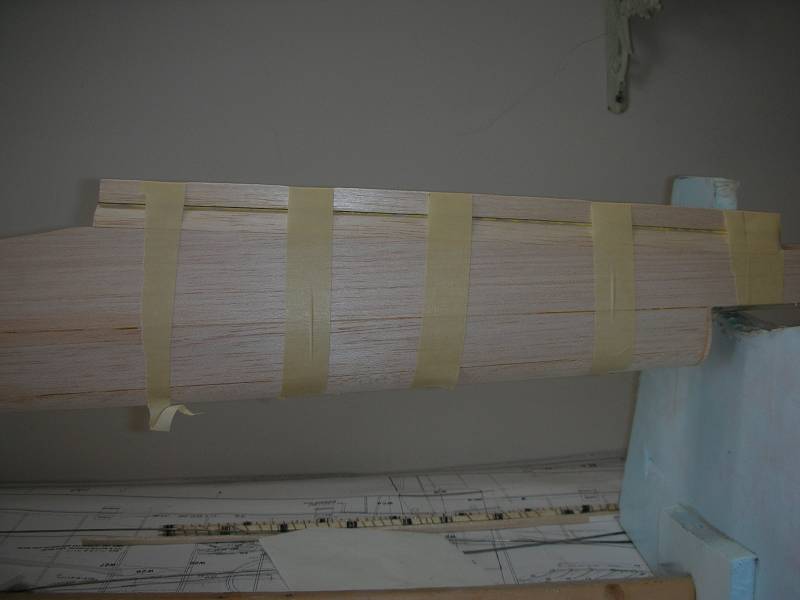

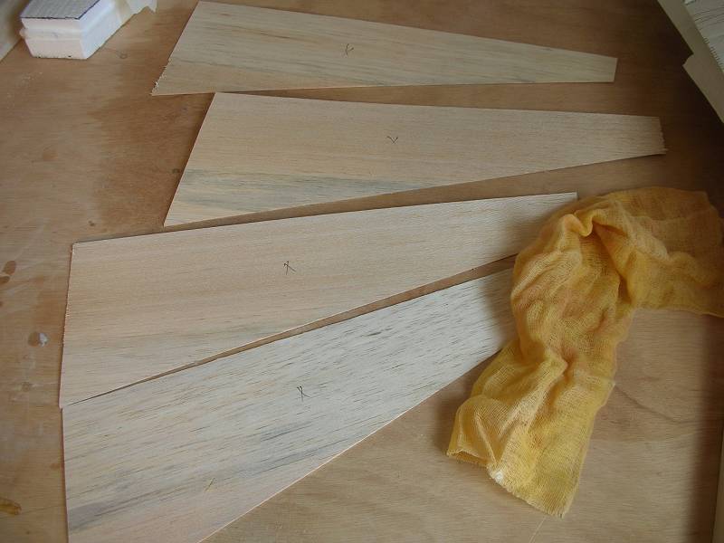

for whatever reason my enthusiasm waned over the last few weeks on my build. however, i am determined to pick back up the pace. my Spring Air retracts arrived just before i left for summer vacation so i had that area to start working on now that i'm back to building. of course i ran into a problem immediately. the nose gear tiller arm sticks out below the fuse. that won't work. since i used a 1/4" tank floor between the tank and the retract i am limited in my options in raising (retracting?) my nose gear into the fuse. one idea i have is cutting a center section out of the tank floor and laminating an 1/8" floor on the tank side. that would raise the gear up a 1/4", enough to clear the tiller arm. however i don't like the idea of an 1/8" being all that supports my nose gear during one of my harder landings[sm=72_72.gif]. i have cut a test piece out of whatever you call the glossy white covered mdf to help my decision making. should this idea work are there any suggestions on a stronger 1/8" thick material? carbon fiber sheet? g-10?
david

Old 07-13-2008 | 09:01 PM
  #59
WEDJ's Avatar
Joined: Feb 2007
Posts: 1,739
From: Stockton Springs, ME
Default RE: Another Blue Angel build
An 1/8 ply sheet attached to a 1/4 balsa backing would be plenty strong. If you still want some insurance, then 1/4 square maple attached to the sides & plate would be bullet-proof.
Old 07-13-2008 | 09:24 PM
  #60
Joined: Aug 2006
Posts: 5,713
Received 7 Likes on 7 Posts
From: Roswell, GA
in the 3rd picture i show 2 pencil lines where i'm thinking about cutting the 1/4" tank floor and removing the center section. on the tank/top side i'm thinking about gluing an 1/8" ply piece to bolt the retract to. although sturdy i'm sure, there would still be only an 1/8" between the gear flange and the blind nuts. not a lot for some of my harder landings. and completely buried inside the plane should i happen to break out the retract. therefore i'm considering a piece of carbon fiber or g-10 if anyone thinks those are stronger materials in this application. thx.
david

I solved that problem on my BA by cutting out a few layers of the ¼†ply and adding some on top. It is in my build thread but I’m not sure of the page. So far it’s worked great and no loss in the thickness of the mount.

essentially the same idea. your's give you the 1/4" that i would like to have. thx.
david

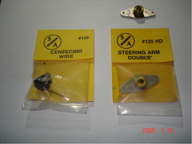

David - Nice build. Spring-Aire NG. I would like to see all completed, steering, etc. I am using the old Rom-Air type steering, with cables on the Phoenix I am completing. This steering available from SA.
Even with this method, I have had to move the NG closer to the tank floor, machine out notches where the tiller arm and strut will rest when retracted, plus more machining on the aluminum block for collar clearance.
I have a lot of old/new Rom-Aire's here, and 5/32" struts. With the SA's, I am using 3/16" struts, thinking I need the support. As far as I can remember, many years ago with the Phoenix', etc., the 5/32" Rom-Air's were fine.
I would like to use the tiller arm on the NG, but have not had any luck setting up to retract, and it sliding up and down on the shaft.
Crank

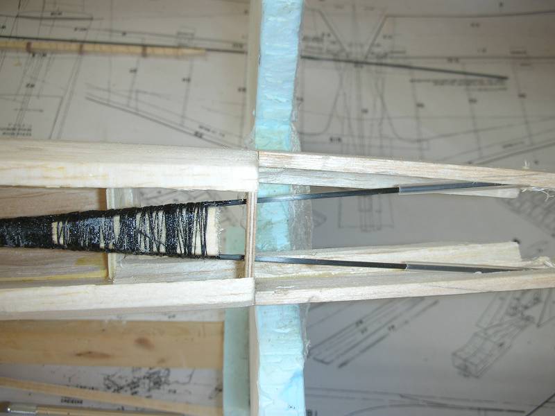

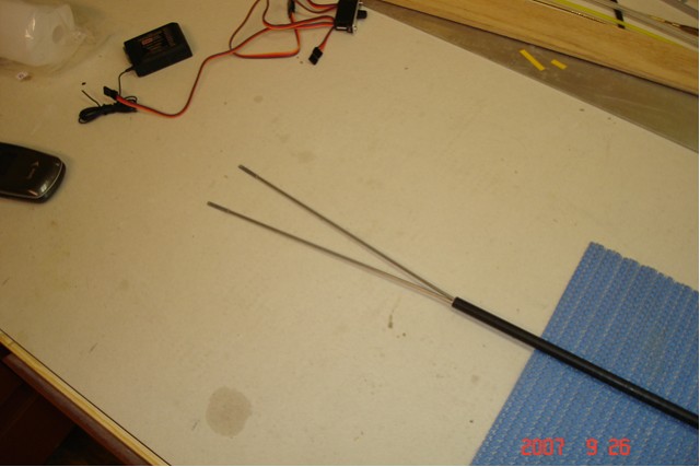

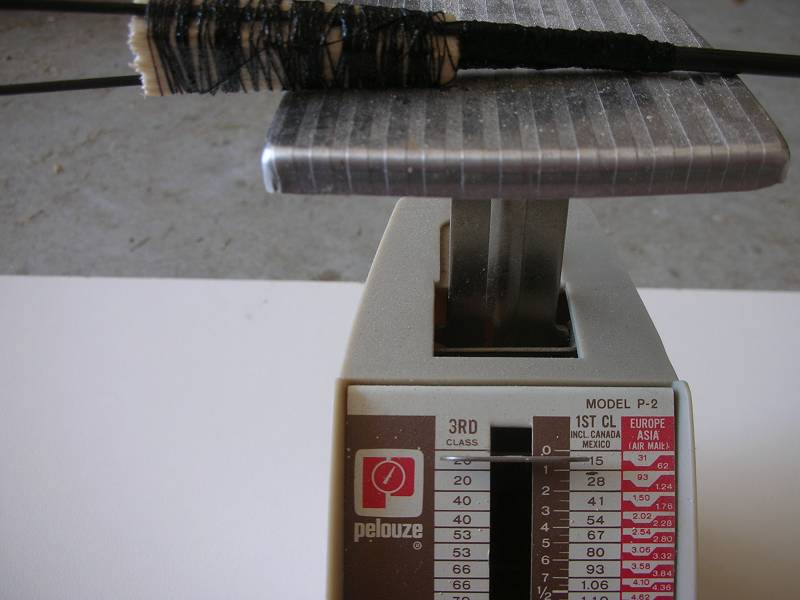

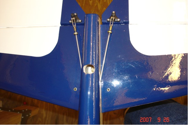

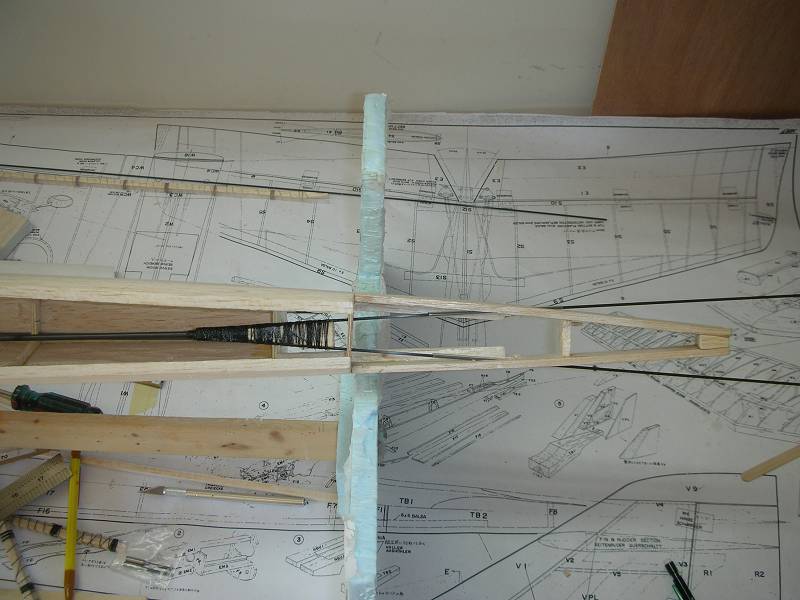

the BA dual pushrod set up stumped me for awhile. as noted in another build apparently the controls are drawn backwards. but having a elevator and a rudder pushrod in the same area can cause conflict anyway. i ordered a Dual Elevator Pushrod System (DEPS) from Central hobbies but the pushrods are carbon fiber which eliminates some flexibility in the elevator pushrod setup. i needed the elevator pushrods to exit a little wider than is possible when using the instructions that came with the DEPS system. however i think i found a solution; instead of using the long shafts through the entire rear fuse section and a short piece of the hollow shaft at the servo area to tie the pushrods together i came up with another idea. i attached the long pushrods to the hollow shaft with a piece of angled balsa with the idea of using a longer hollow shaft and shorter pushrods. that allowed the pushrods to spread out and give me the width i needed.
the sewing thread and thin CA idea to connect everything is astoundingly strong. i think i could sand, tap, drill or carve the combination of the two anyway i wanted. not only is the setup very strong but also very light. when cut to correct length the full setup will have at least 6-8"of the 2 pushrods removed and the hollow tube will also have about 6" removed yet only weighs a 1/4 oz. two pieces of 4-40 rod without any center connecting piece weighs over an ounce. probably a full ounce difference when all is said and done.
thoughts anyone?
david

one thing i did not look closely at was using a 1/4" dowel and short pieces of 4-40 rod. mostly because i ordered the DEPS system and felt compelled to try it and i didn't have any 1/4" dowel.

You can use Dave Brown Pushrod's. They are fiberglas, and the ends come in single or double. You can squeeze 4:40 rods in, with a little mod. Getting two 4:40's in for split elevator's will work, if you use that size.
The thread way works fine, used to use that with 3/8' sq. stock. I just looked up at your set-up. Did not realize you were using the long rods. If it works, don't fix it.
Crank

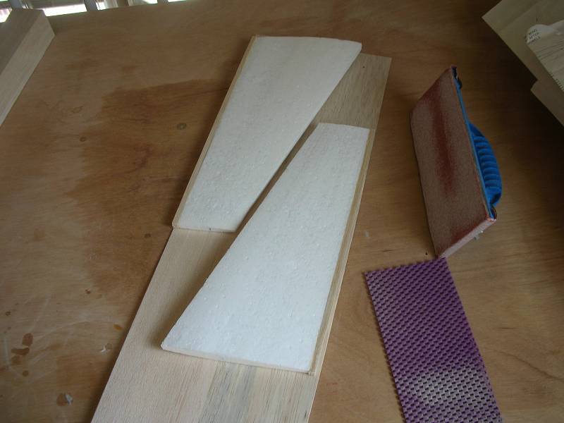

rear stab sheeting is underway. i sanded the sheets smooth before i glued them this time. last time i wasn't happy with the grain patterns showing through the fiberglass cloth and polycrilic. i like to use a polyurethane glue to assemble the foam cores and balsa sheeting. i use a 6" foam roller and put just enough glue on the foam to see a shine to it. you can roll the glue around until it shines. after assembly i clamp firmly with ply pieces and clamps. the polyurethane is extremely strong and only a very little is needed.
david
