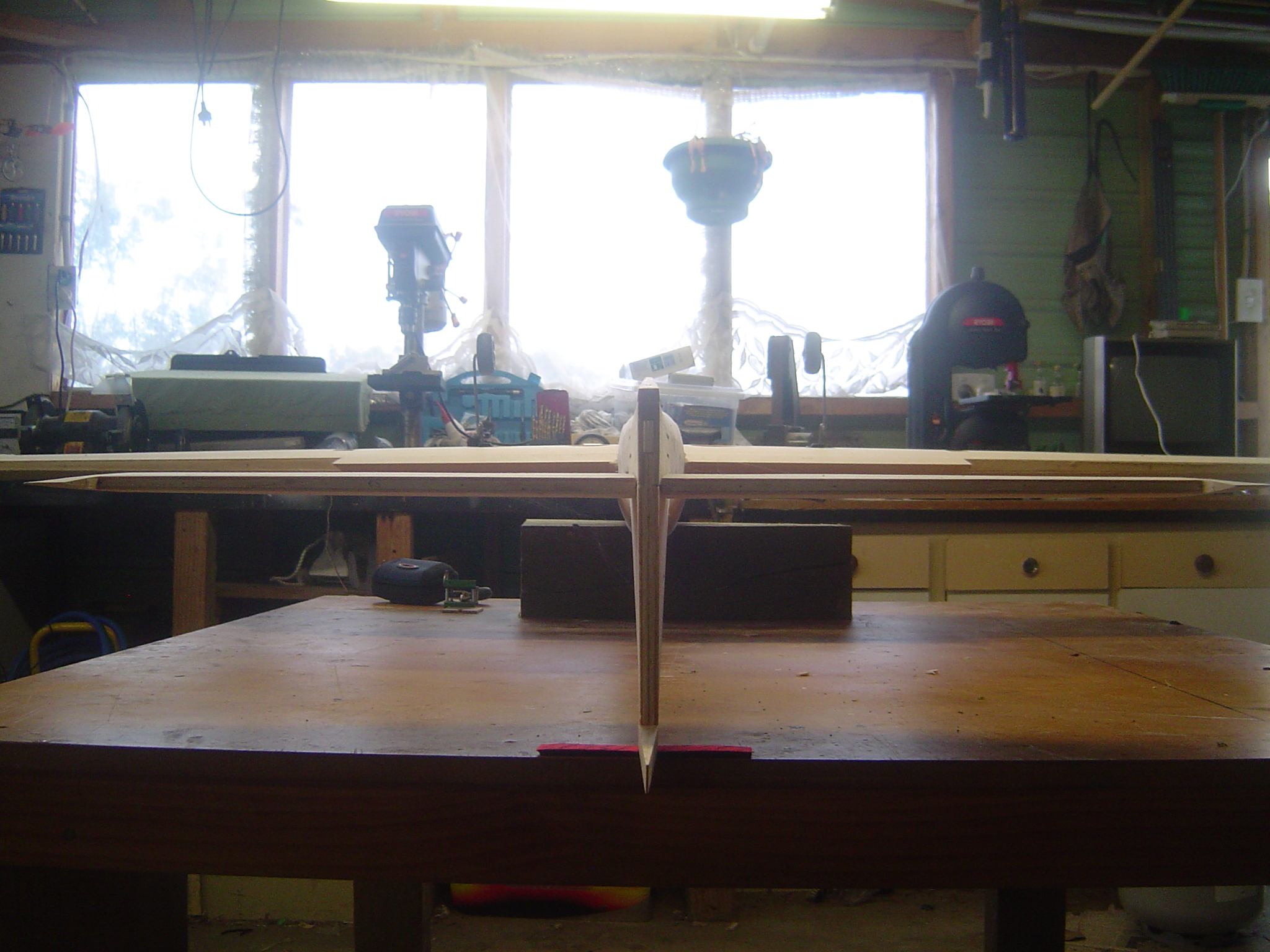

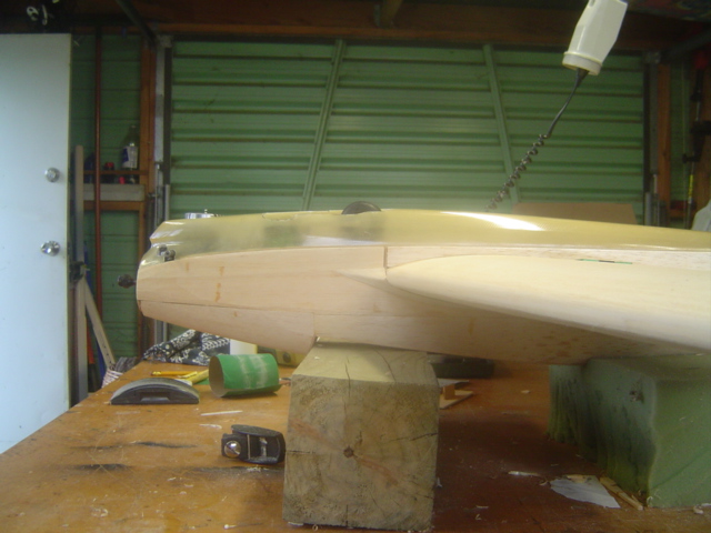

Finaly some progress on the Beetle. I had been putting off adjusting the saddle for ages. It was just something I didn't really want to do - but it had to be done. I measured the amount i had to take off by adding a shim to the other side. It looked like about 1mm so I marked a new contour and attacked it with a new sanding drum on the dremel.
The wing is now sitting all square to the fin and horizontal tailplane. I have glued on the front wing hold down former as well as the rear hold down and trailing edge doubler.
I will post some pics when I get a chance but I am off to Oz for a couple of days.
Cheers
Tarquin

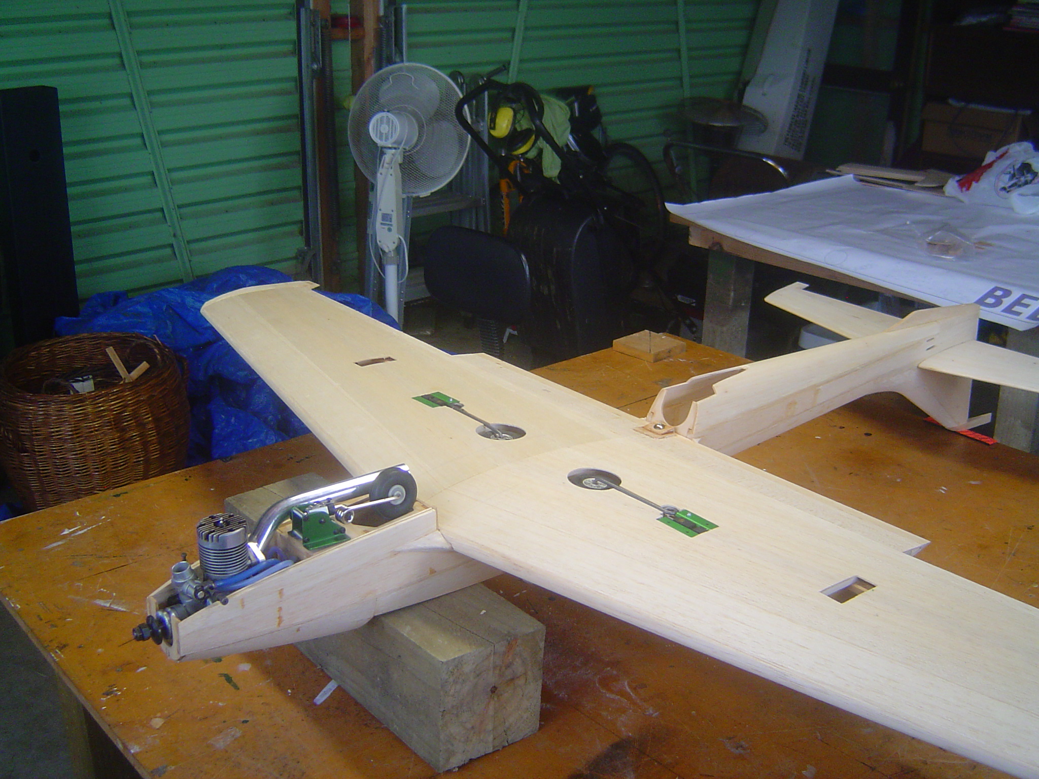

Yes good one Flywilly. They had gone back to Kansas but I had a chat with the tin man.
As promised a couple of pics of the alignment. Probably not perfect but a heck of a lot better than what I had.
Cheers
Tarquin

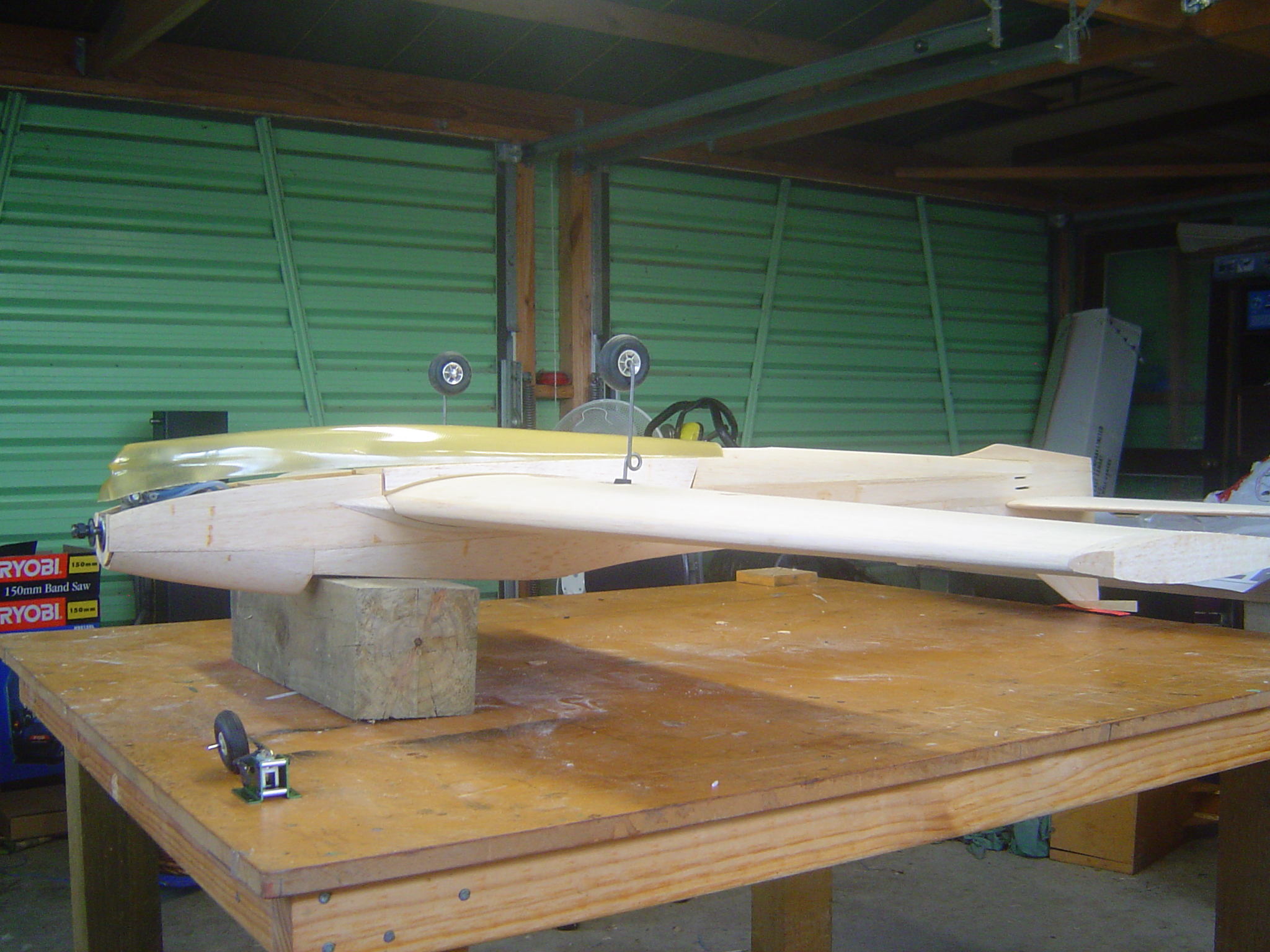

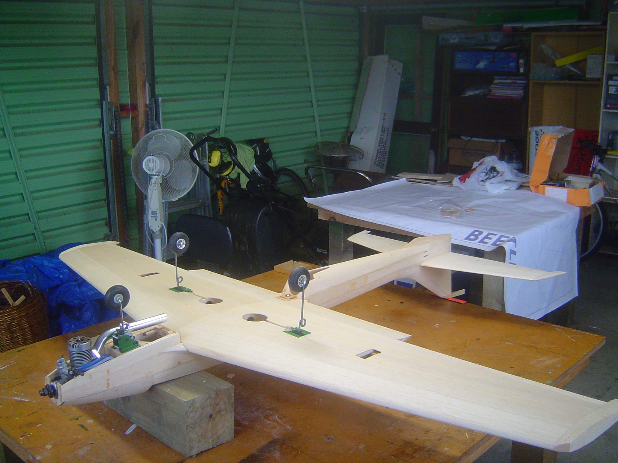

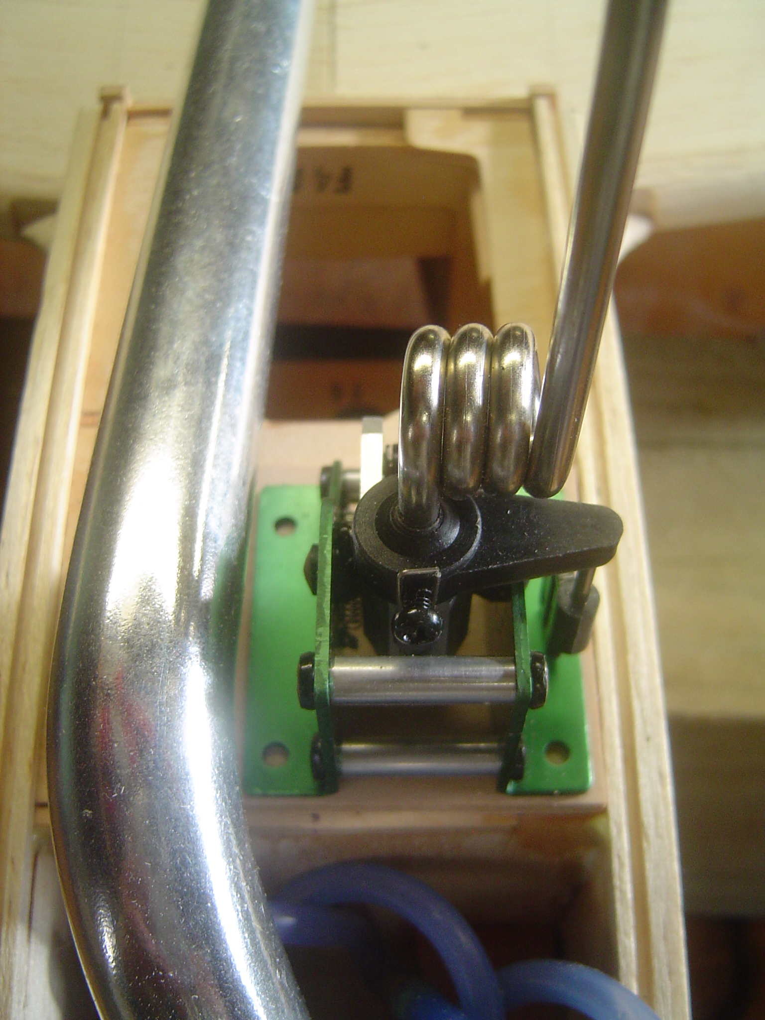

I have opened the wheel wheels roughly - they are far too tight for operation but do allow the wheels up and down. There are no liners in there yet.
How much down incidence can I get away with when on the ground? I bent the nose leg a little bit short. I can twist up another leg if I have to but would prefer not to. Also the wheel in the pic is a fraction small so it will get better but not a lot.
I was really strugling with the steering geometry getting too close to the header pipe. After staring at the plan cross sections I realised the steering arm was on the other size to the way the MK nose retract arrived. I had a look at the back of the steering arm and noticed another tapped hole. All I had to do was remove the arm and put it on the other side - easy. You can see how much clearance there is now and you can guess how bad it was.
Cheers
Tarquin
Cheers

If anyone was thinking that the legs looked a bit dorky here is a sneak peek of what they have to keep off the ground. The belly pan is just sitting on there and has not been trimmed to fit over the cylinder head.

Fantastic Tarquin!! Thanks for the updated photos!! Looking Great!!
I would think that if you have prop clearance the negligible nose down attitude while on the wheels would not be a big issue...Some may disagree but I personally wouldn't worry about it and it doesn't appear to be extreme (I can't even tell in the photos to be honest with you)...
I personally hold some up elevator during the takeoff roll and allow the plane to rotate a little early then relax the stick as necessary to hold the nose wheel off and maintain that attitude...If I do it right the plane will roll on the mains for a bit after rotation and then when it's ready to fly it will...When I do it correctly it makes for a nice smooth takeoff...I like it allot better than screaming down the runway and yanking the plane off the ground which I see most folks do these days...
Basically it's the same technique as taking off a Cessna 172 which I learned during my private pilot lessons (never got the license...ran out of money..waaa)...If I remember correctly you would lift the nose wheel around 55kts and the plane would fly around 70kts...It's really smooth... [8D]
Anyhow..Your plane is looking great and keep up the good work!! I love this plane and am looking forward to the finishing stages...

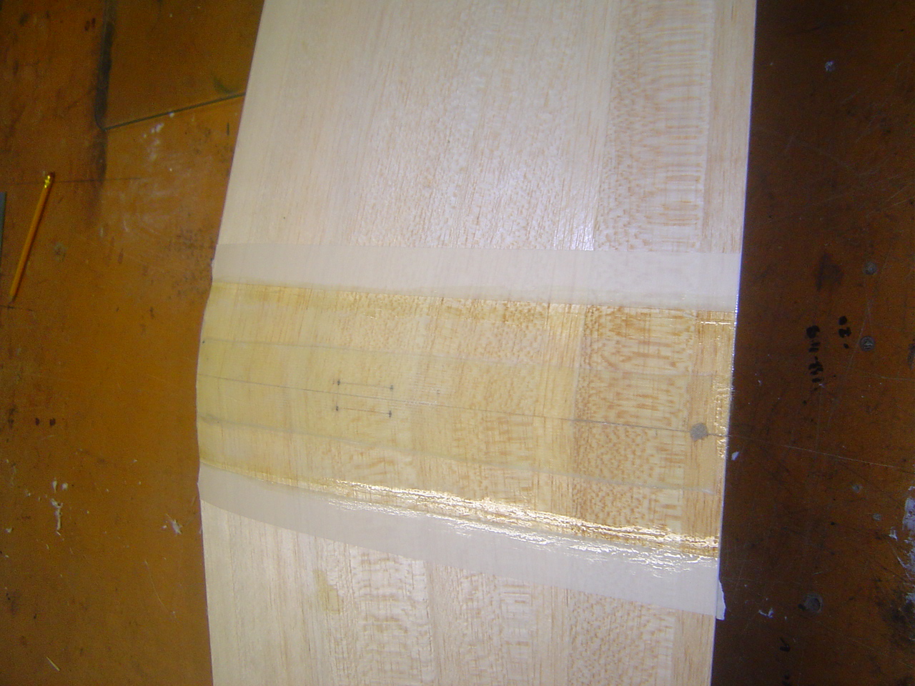

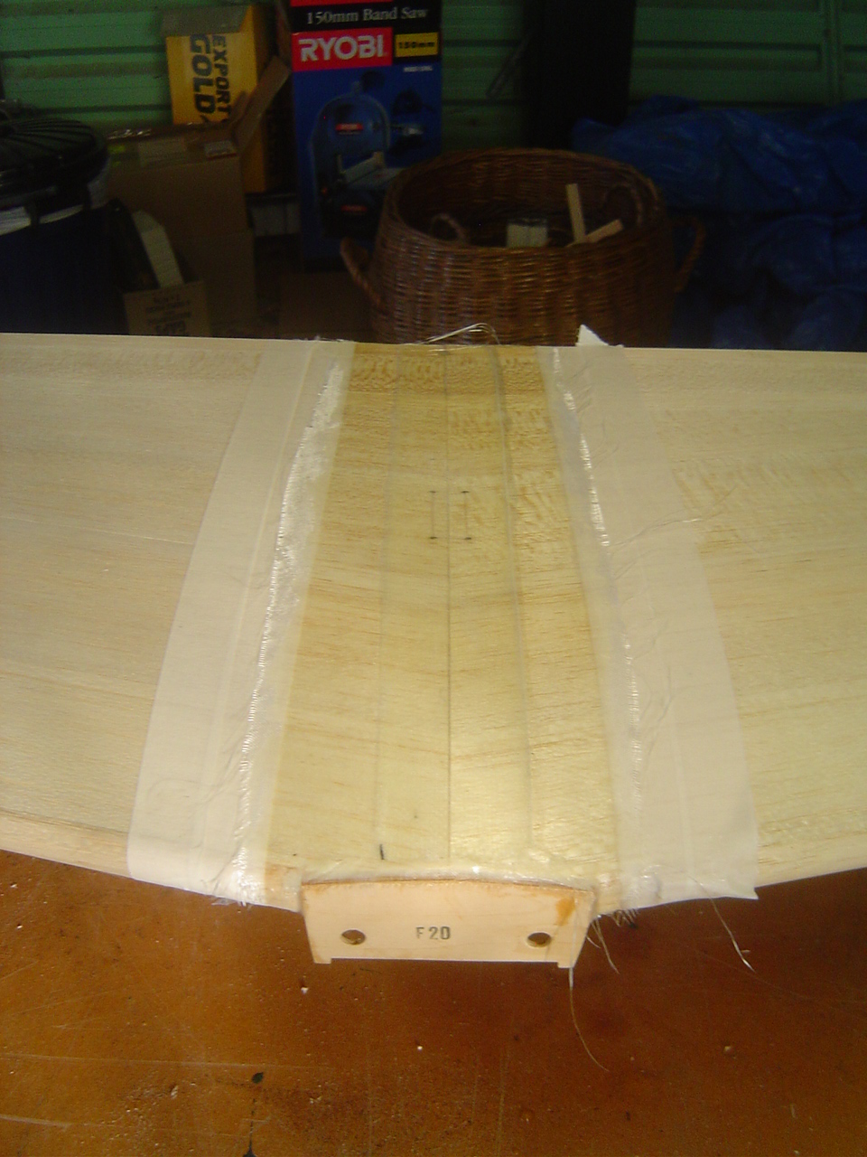

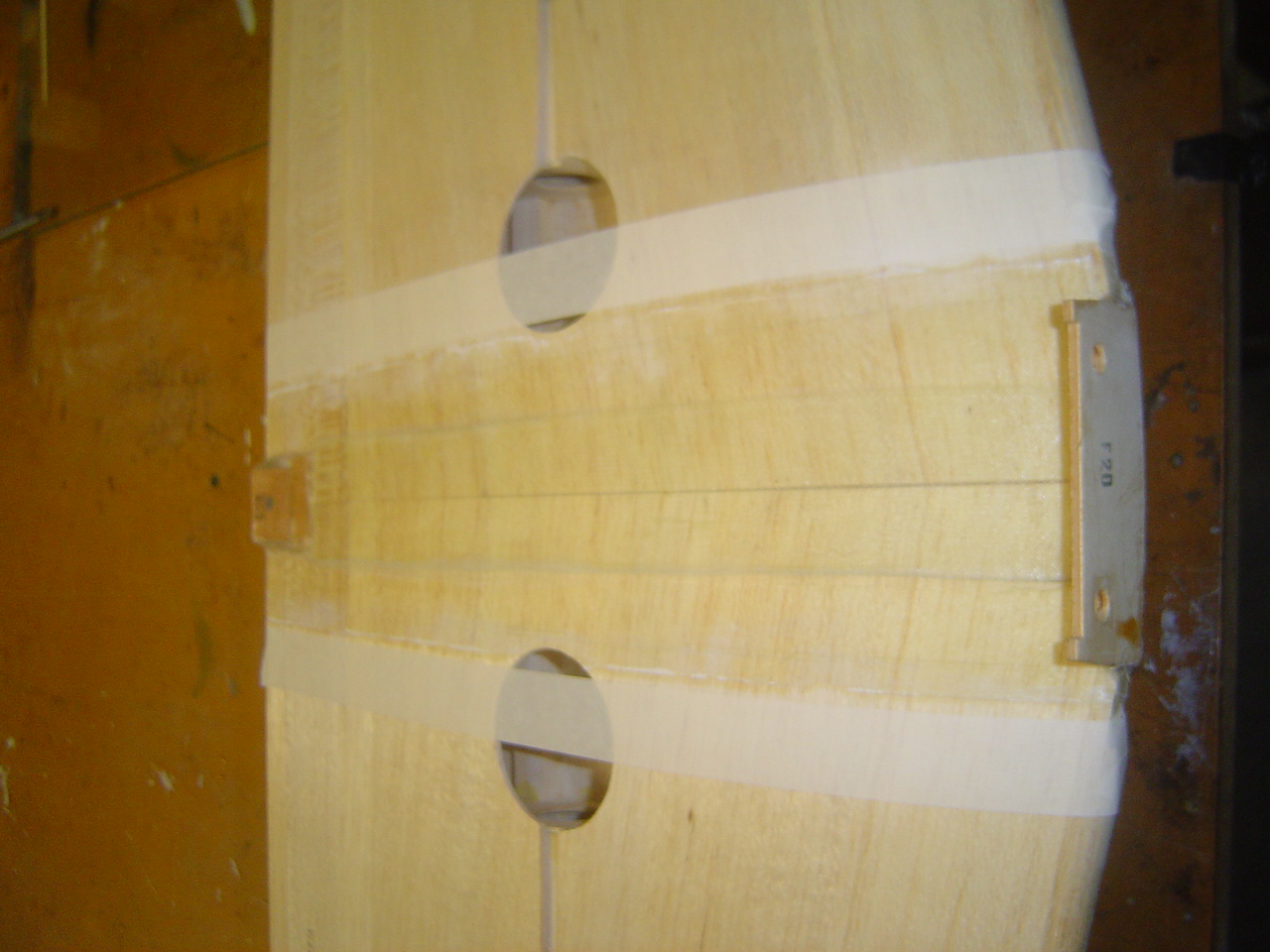

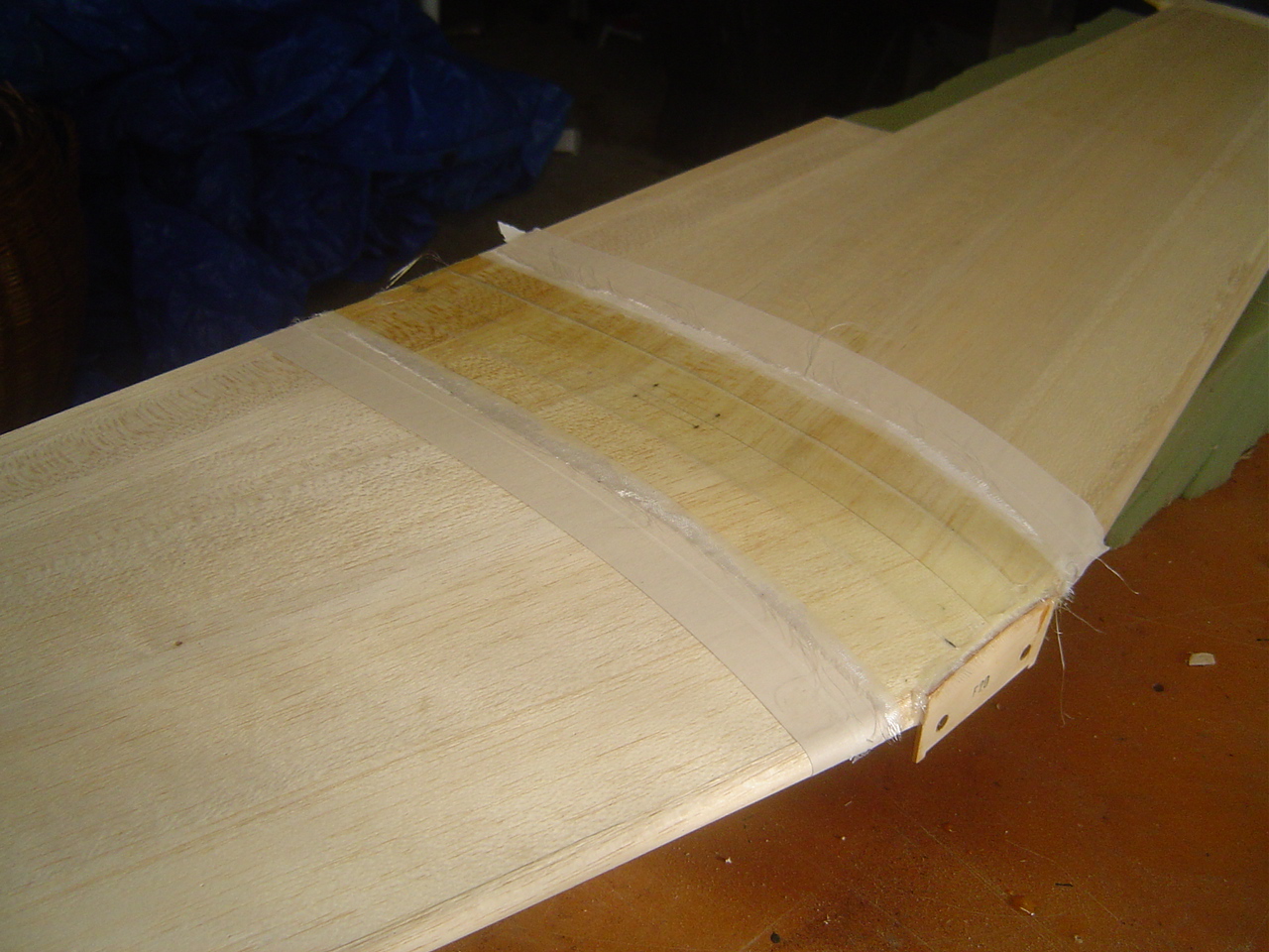

I have glassed the centre section with a 2 inch wide tape of 6 oz glass and covered with a layer of lighter cloth. I am using the method 8178 described in his blue angle build. Glass over an edge of masking tape then once cured sand the glass to a nice feathered edge then seal with more resin up to a further out tape line.
Cheers
Tarquin

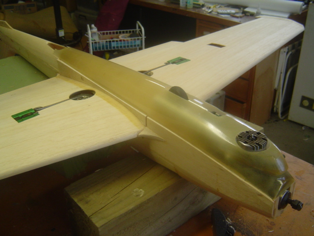

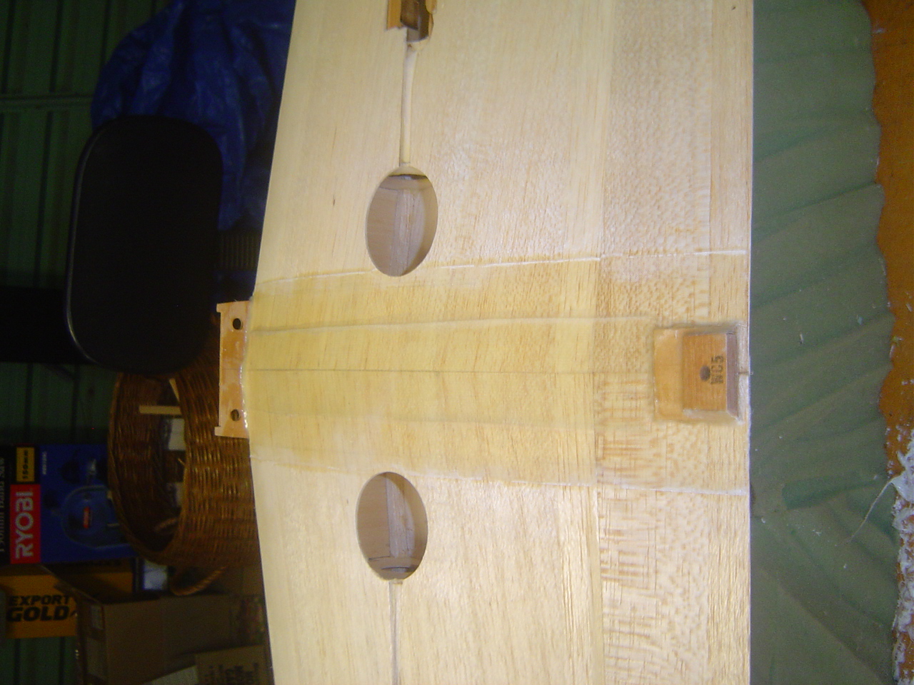

The centre FG was sanded to remove the excess cloth. The wing was then re-taped a bit further out and then sealed with resin.
While that was happening I roughly trimed the belly pan to fit over the cylinder head and needle valve. I had to open the pan around the low end needle and carb body since it was fouling.

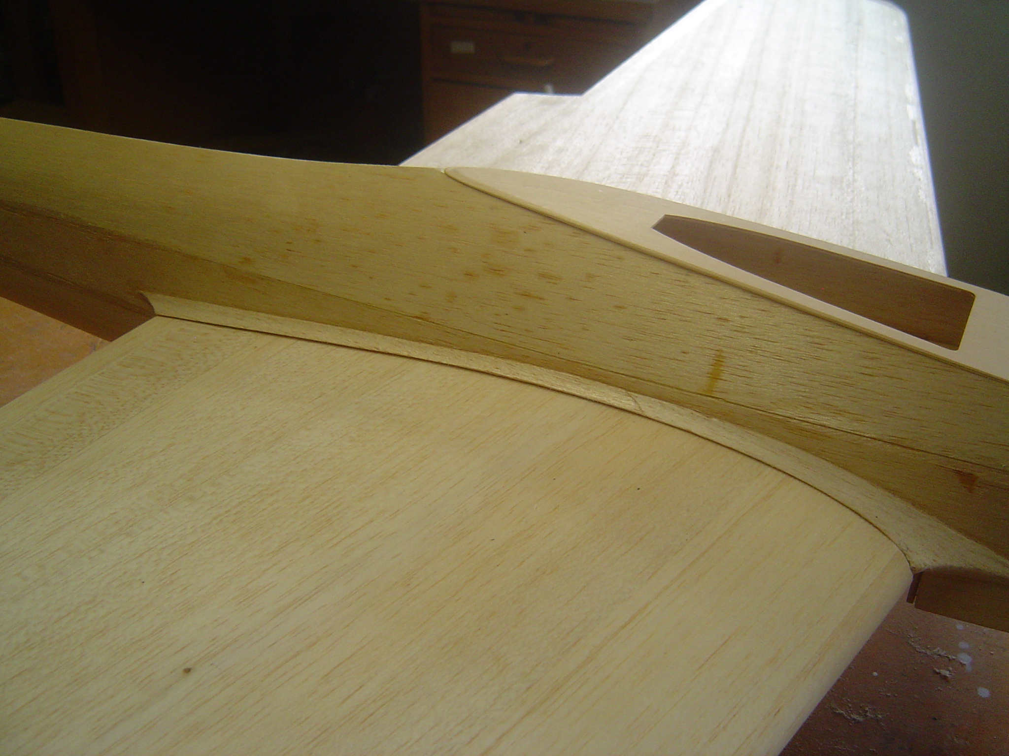

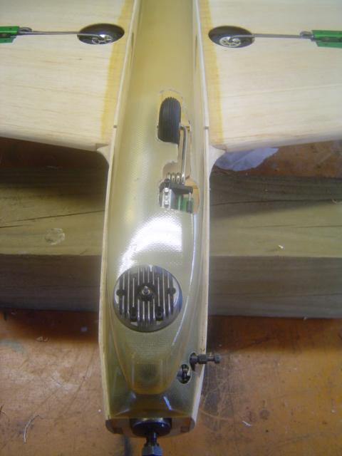

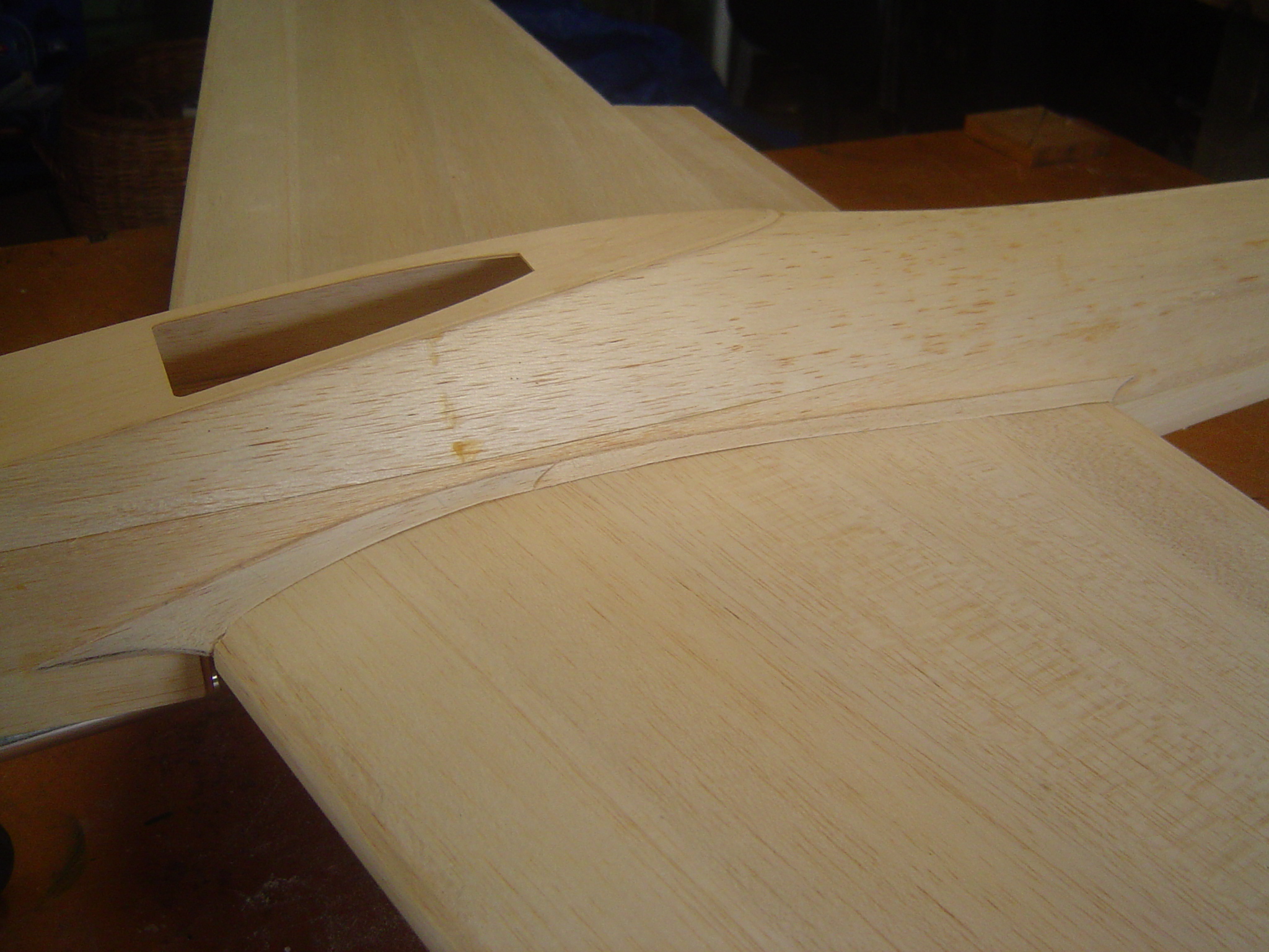

Well this is embarrasing - it has been 1 year since I last updated this thread ... and no there has been stuff all progress over that time.
Recently I fitted the under wing in fills and fitted the belly pan retaining edges.
I have also sanded the sides to fit the pan and roughly cut the nose wheel opening.
As you can see the nose wheel will not retract completly inside the pan. Right now the wheel is against the floor and still sticking out. It shows on the plan that the wheel sticks out a fraction so I am not too worried about it.
Cheers

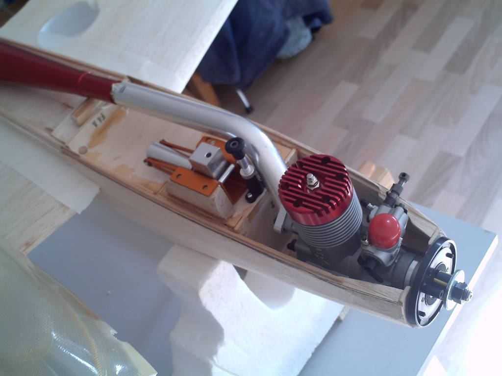

Do designs like this have fuel siphon problems. Seems as though the carb is quite a bit lower than the tank will be. I guess if your using a YS or pumped engine of some kind maybe not??
Tim

Yeah some of the designs would have caused siphon problems. I am using a OS61RFP so shouldn't have too many worries.
I think if one sticks to designs and engines of the period then it should be OK. For example the Curare was suited to the non-pumped screamers like the webra and OS 61VF. As the noise requirements came in the engines changed to the long stroke engines like the Hanno and the plane designs moved to match.
Cheers
