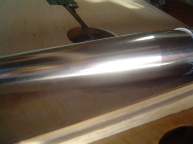

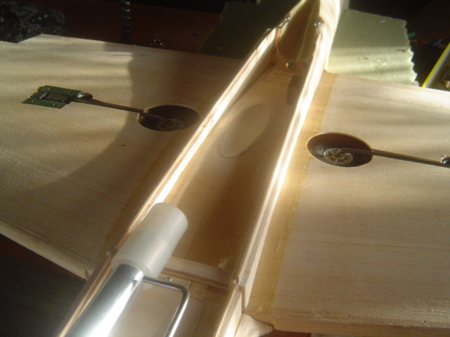

In terms of potential changes to the wing section I would suggest trying to maintain the MK profiles. Although it might be difficult to build there may have been some hdden reason as to why. For example the leading edge spanwise shape change may have been to induce/prevent tip stall. As said earlier building tabs or jig alignment holes would be a useful addition.
For my build I am pretty sure I dont have room for the tuned pipe as it stands. I am going to have to chop into the bottom skin. It was suggested to me that I cut and oval hole and then bevel the edges. Then I can press in a piece of 1/64th ply and CA in place, then sand the edges flush, then glas back over.

Hello
I have bitten the bullet and cut into the bottom of the wing skin. I used the dremel type tool with sanding drum to create an oval hole with bevelled edges. Then I used a piece of sandpaper over my fingers to smooth out the edges and create the shallow depression. I then added a matching oval of thin ply using medium CA. All I had to do then was sand the small edge to feather it back into the wing skin.
Next up I need to add a layer of glass to replace that removed by the cutout/ply.
